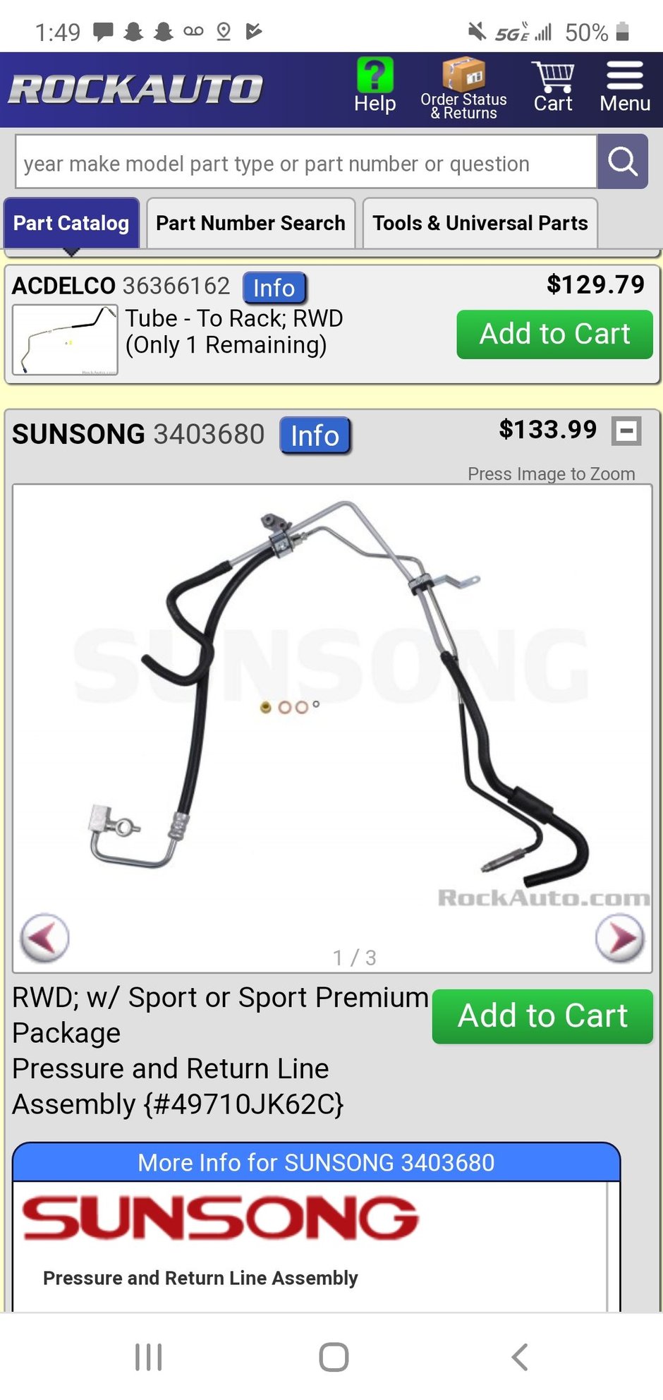

So the new leak is from another hose. I've ordered the hose and will be ready to replace it tonight. Based on how severe this leak is now, I find it hard to believe that the few drops of water or not bleeding it correctly could have caused this issue. Nonetheless, the hose needs to he replaced. I can't find anything on how to properly bleed the power steering, so my question is, how do I do that. I have read the quick procedure for flushing by turning the steering wheel numerous times then emptying the reservoir and repeating 3 times. Would that bleed it to? Or is there another way to do so? Thanks

This is the line to be replaced. I went with oem hoses from infiniti for the reservoir, but they wanted $500 for this hose. So going aftermarket here.
