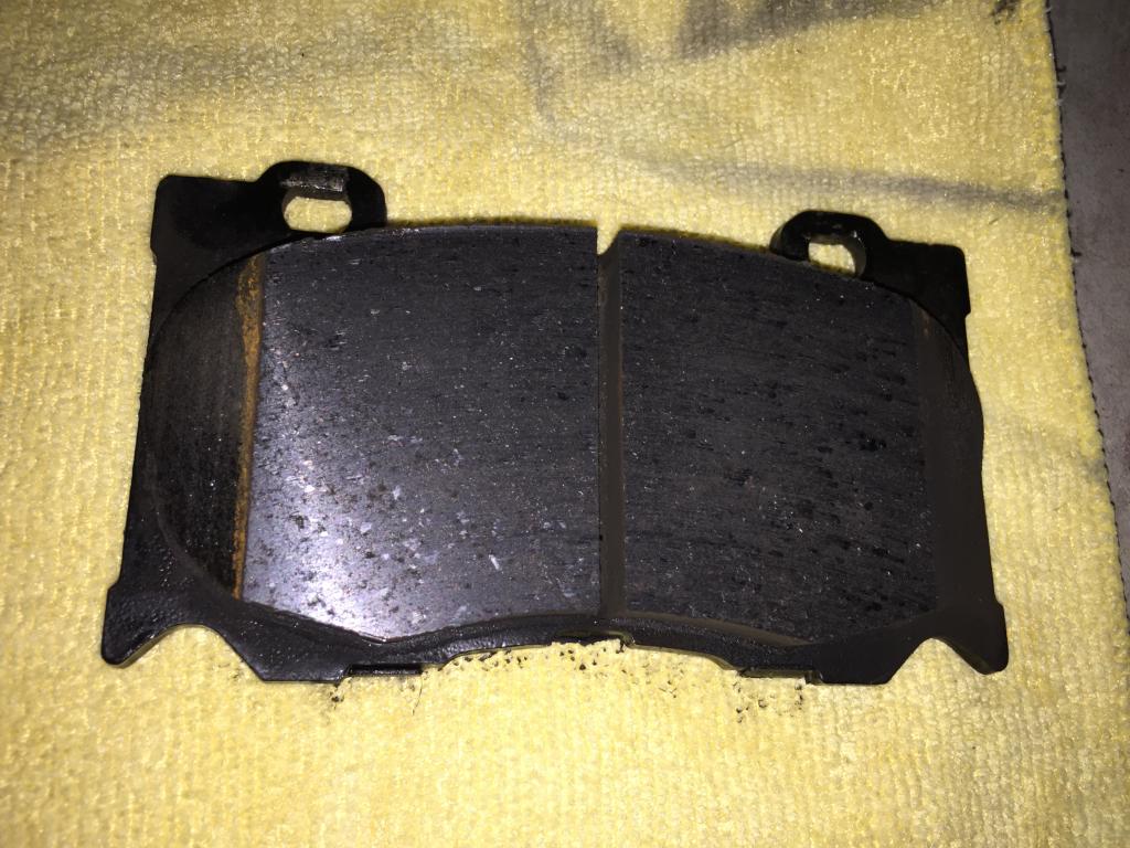

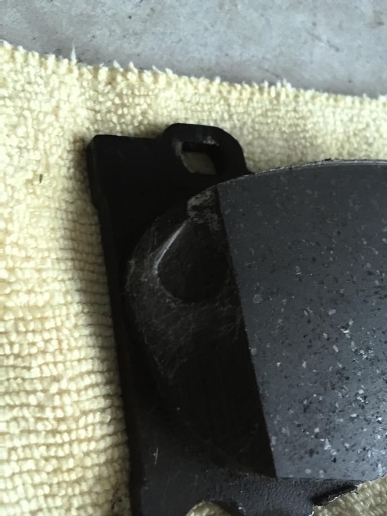

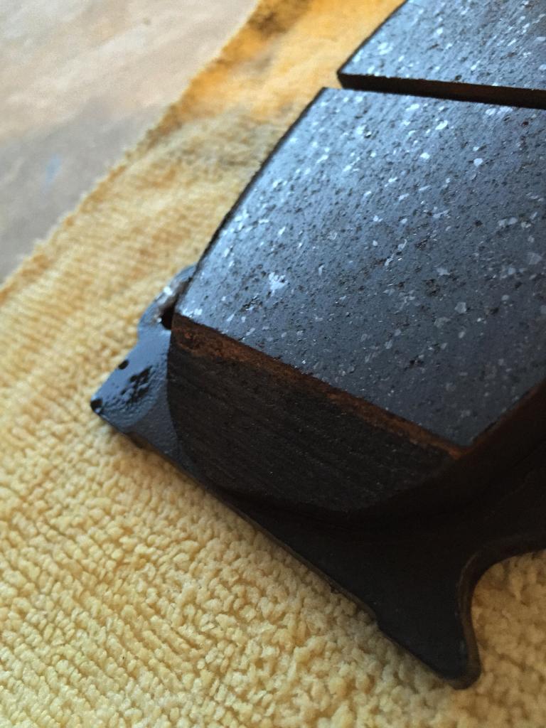

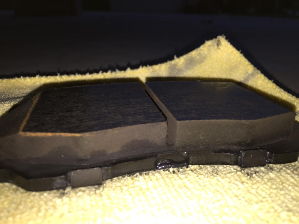

I tried the BG Stop Squeal on the problem pads (front passenger). After application, there was no noise for the rest of the night. I turn on the car this morning expecting no noise and I get the opposite. The same loud and obnoxious noise I got before. One of my friends suggested that maybe my pads are glazed. Does anyone know how to fix that or what I need to do? I would rather fix this myself rather than pay someone else to do it. Does anyone have any advice? I have seen maybe one other thread on here where someone had the same issue, but there was no solution. Here are some pictures of the pads themselves. Any advice on how to fix the issue would be appreciated.

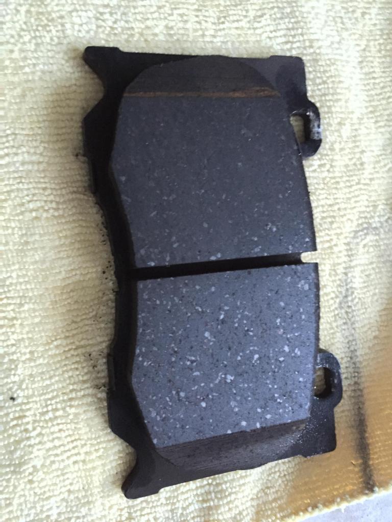

This pad had some sort of web on it. Not sure where the hell it came from, but I wiped it off and sprayed brake cleaner on it.

As you have already found out, these pads come with a tapered edge since they are supposed to be quiet.
You have really done all of the best practices to get the pads to quiet down, there may just be some minor issue with that pad that is causing the noise. As you know, I have the same setup (pads/rotors) and it has been exceptionally quiet in all conditions.
This is going to sound like a crappy solution, but you seem desperate, or at least i know I would be if I were in your situation. Advance Auto Parts stocks the ProAct pads, I would buy a set of the front and replace them on the squeaking wheel. Bed them in, you have 2 more shots to get a squeak free setup. They come with an anti-squeal grease too, I am not sure if it differs from the grease that is made by CRC, but who knows if the composition is slightly different that could make a difference.
ProAct Ultra Premium Ceramic Brake Pads - Front (4-Pad Set) ACT1346: Advance Auto Parts
Coupon Code "WD44" for 35% off, which makes the subtotal $46.79. A small price to pay if it solves the problem.
