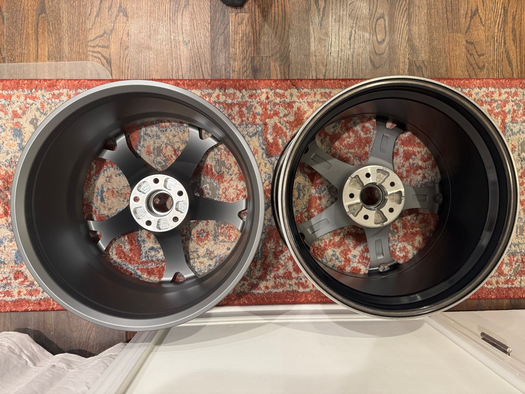

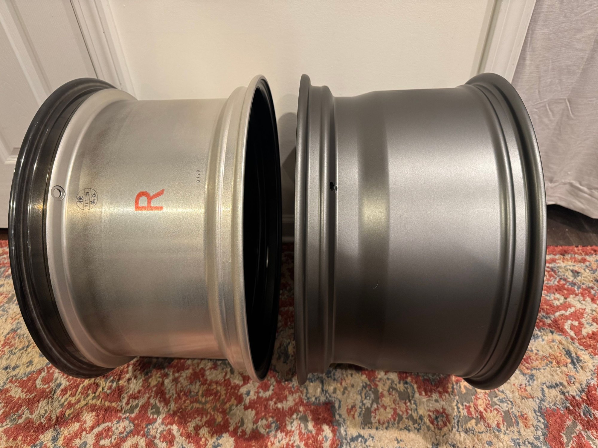

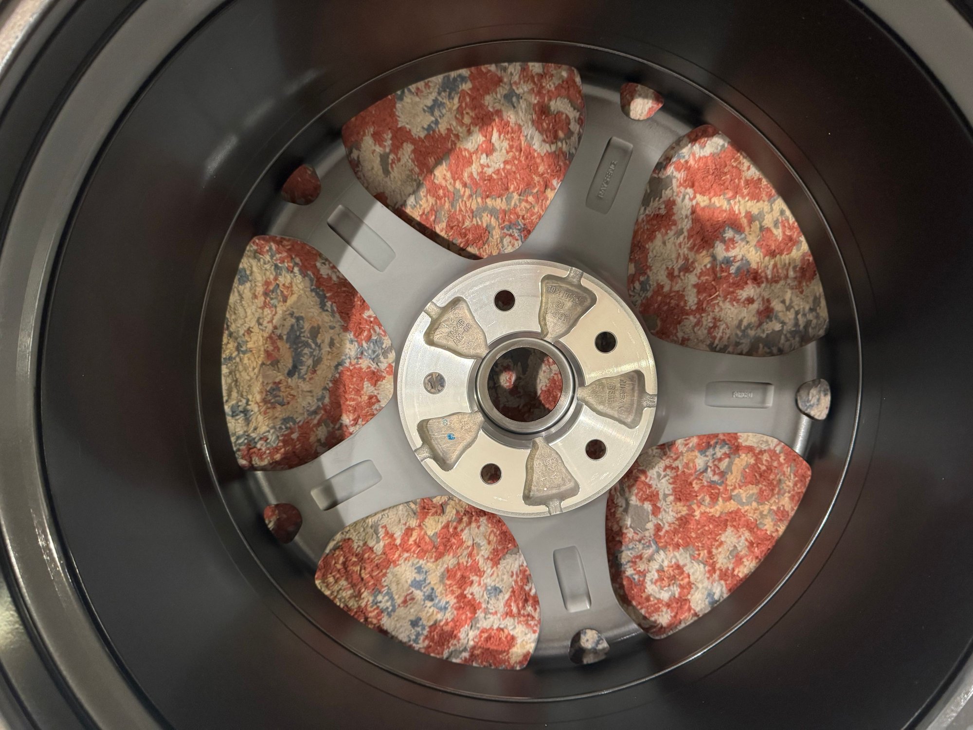

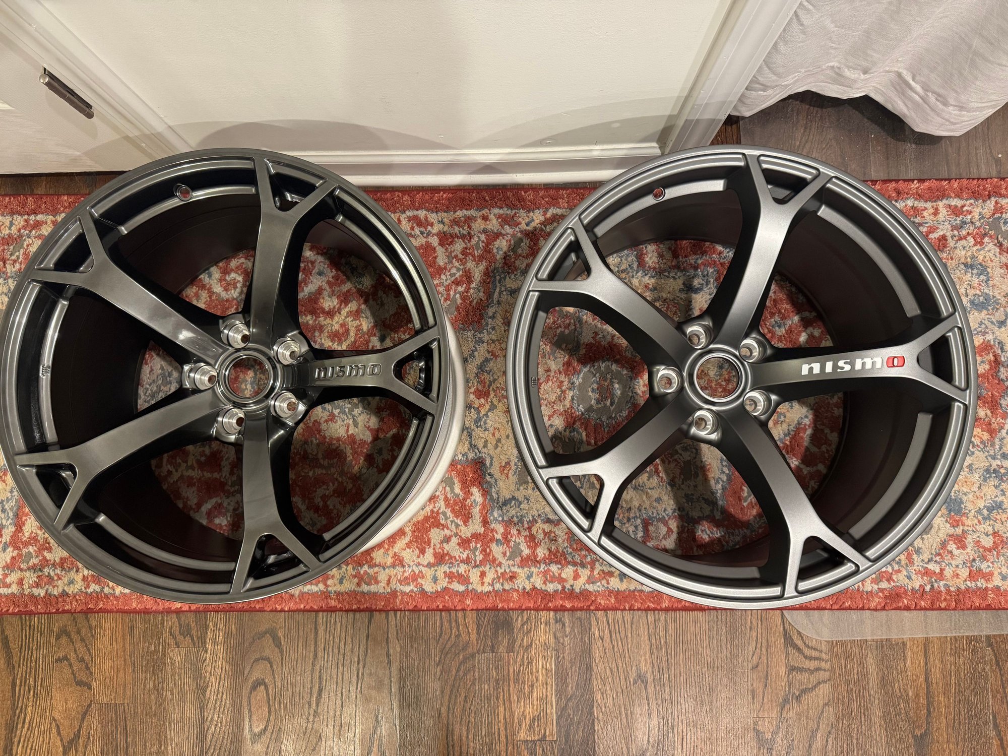

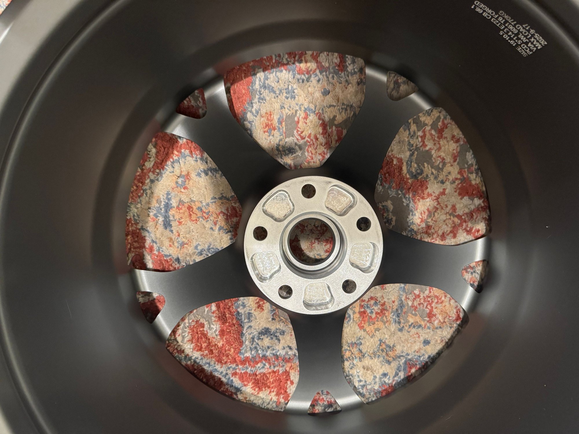

OEM 370z Nismo V1 vs Alibaba replica
Both are 19x10.5 +23
OEM = 22.2 lbs Alibaba replica = 25.2 lbs
Differences:
Spoke design dimensions and shape
Lug holes (mag/shank on oem vs conical on replica)
Weight and weight balance
Stamped information
Barrel design and drop center
Valve stem hole
Center cap hole
Rim contour
I have plans to send these to Smithers for testing. Trying to see which test to perform. Depending on total cost, may also do metallurgy.

Yep, 25 pounds for a 19x19.5 wheel is lightweight, all things considered. The OEM wheel does have less material in the cut-out between the lug holes, and a thinner inner edge.

Minus the painted letters, which I don't prefer, I would challenge anyone that isn't intimately familiar with the Z to notice the difference. The Factory sport Duckfeet 18"s are 24-25lbs, so I agree that the replicas are still relatively light.
