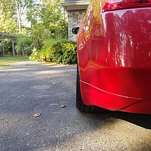

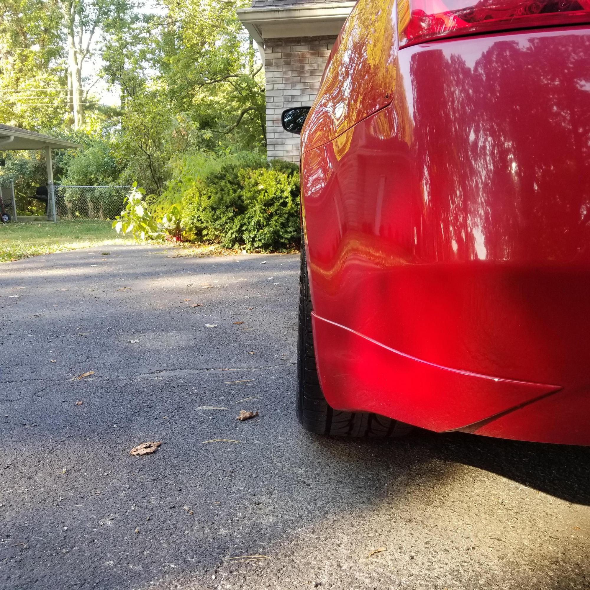

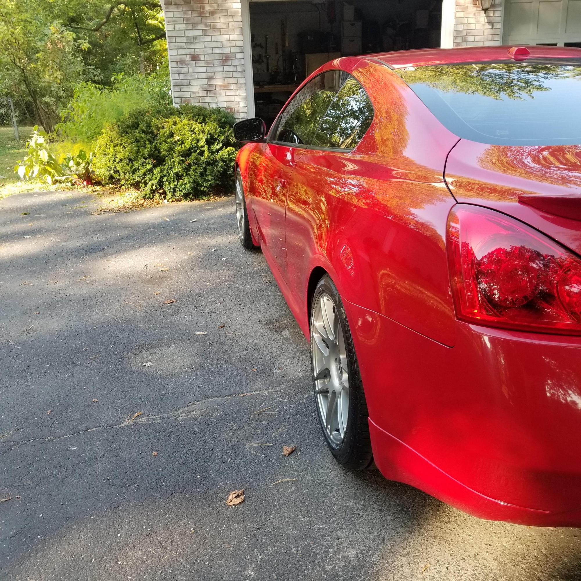

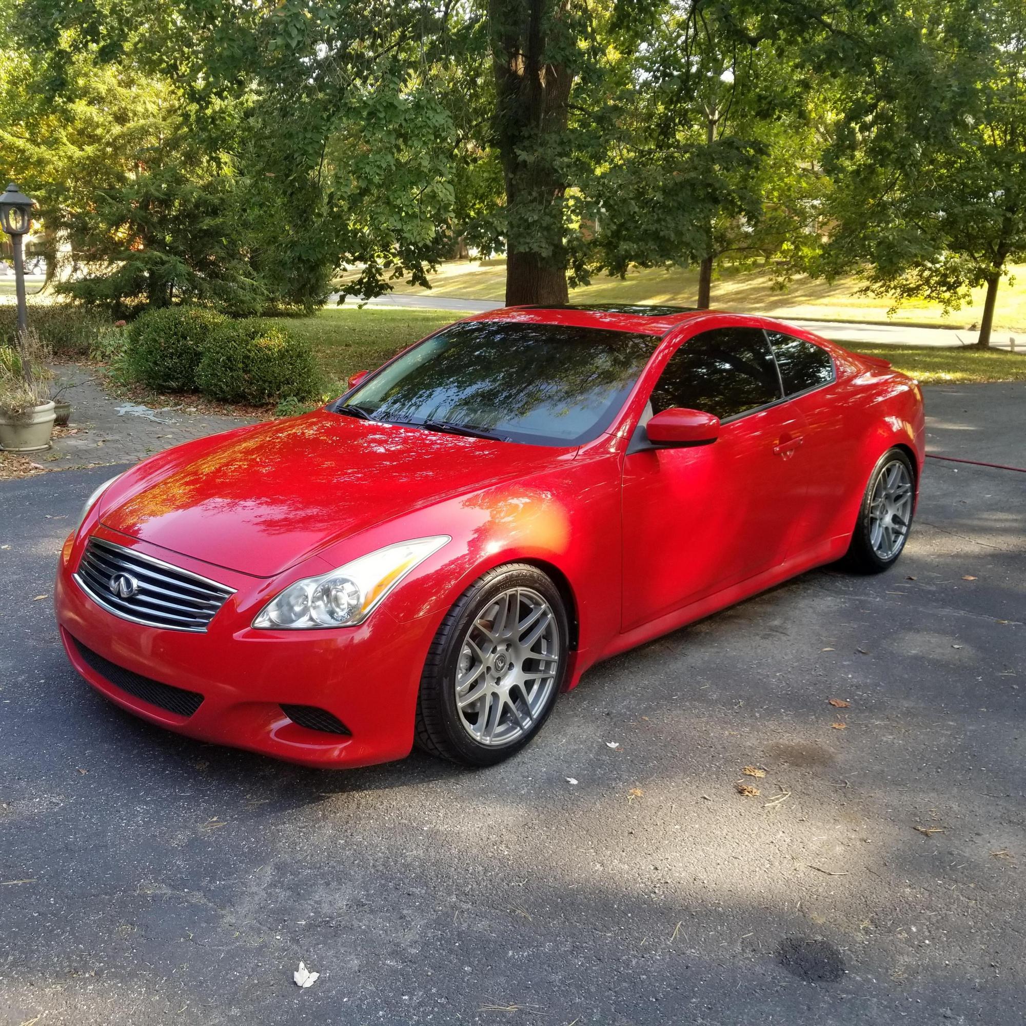

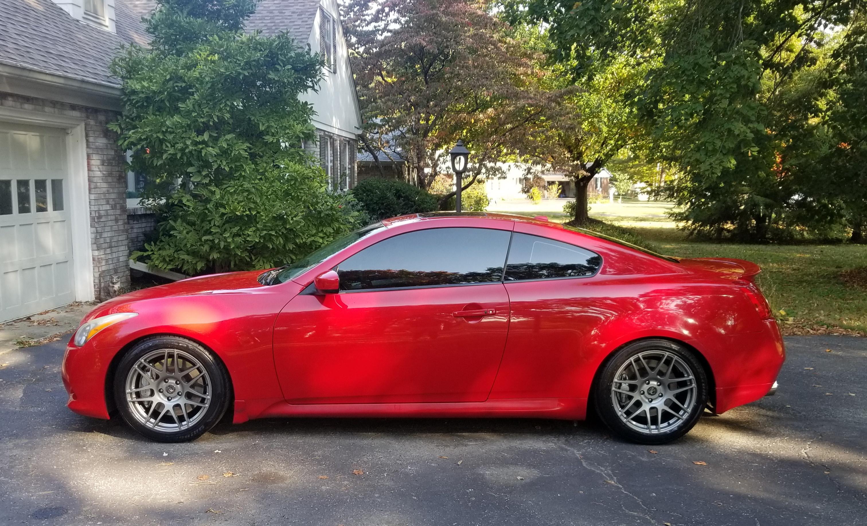

Posts: 48
2008 G37s 6mt
Forgestar F14 18x9.5 + 35
265/40/18
Tein Street Basis coils
No spacers

That looks great Gavin. No fender rolling required?

No fender rolling but the front is easy to roll if you want since it's already at a 45 degree angle and the rear can easily fit a 275. If I get bored some day I'll make an 8mm spacer for the rear at work just to bring it flush but it's fine really. I found a piece of 7" Al barstock the other day that would be perfect.
The smaller wheels w/ wide sticky tires have helped the car so much. It's been 2 months and great so far. I'm glad I didn't spend money trying to fix my 19's.
