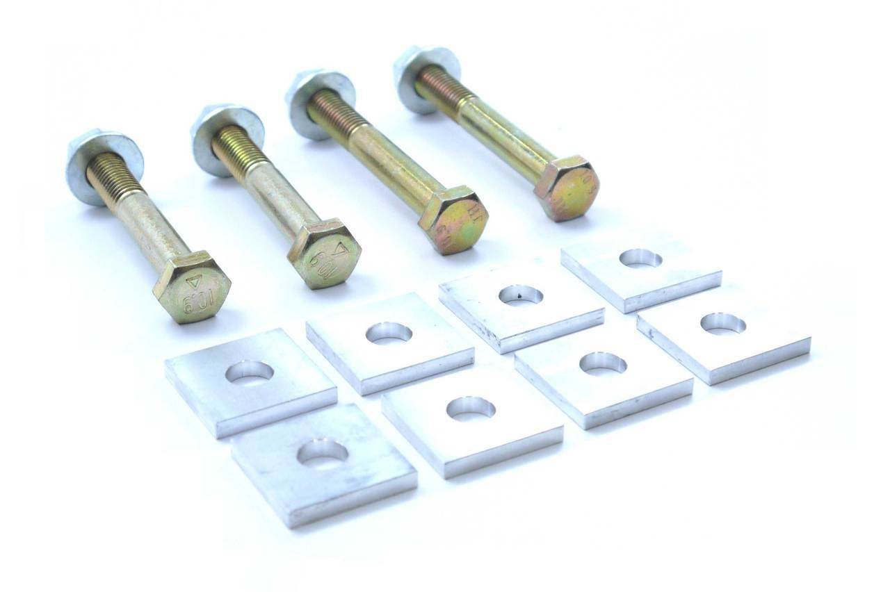

Luke from THMotorsports was kind enough to get me fixed up.
I got the eccentric lock-out kits to match as well.
Sean

Don't you need adjustable toe arms to use the lockout kit? And I think the only way to be able to run those is if you have true coilovers in the back, as the toe arms replace the spring perch.
I may be thinking of something else, though...?

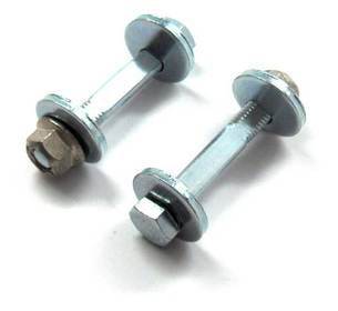

Wow!!!! You're absolutely correct!!! I ordered this:
Eccentric Lockout Kit for the 370Z & G37 | SPL Parts
When I should have ordered this:
SPC Rear Eccentric Toe Bolts for 370Z & G37 | SPL Parts
I'll get with Luke to straiten it out. Or I might be able to use my current SPC toe bolts.
Thank you very much. That was a big help. I was wondering why there were four bolts pictured LOL.
Sean

If you've already got SPC toe bolts, you shouldn't need to order any other bolts. That's what I'm running with the SPL arms.
Old Jan 13, 2016 | 08:56 AM
  #72
You can run those lockouts w/ the regular toe bolts but you only have four toe settings that way.

I'm just gonna reuse the SPC toe bolts I already have. Don't think SPL makes 'em. But I'll check.
Update: SPL doesn't make them. I'll use the SPC ones.
