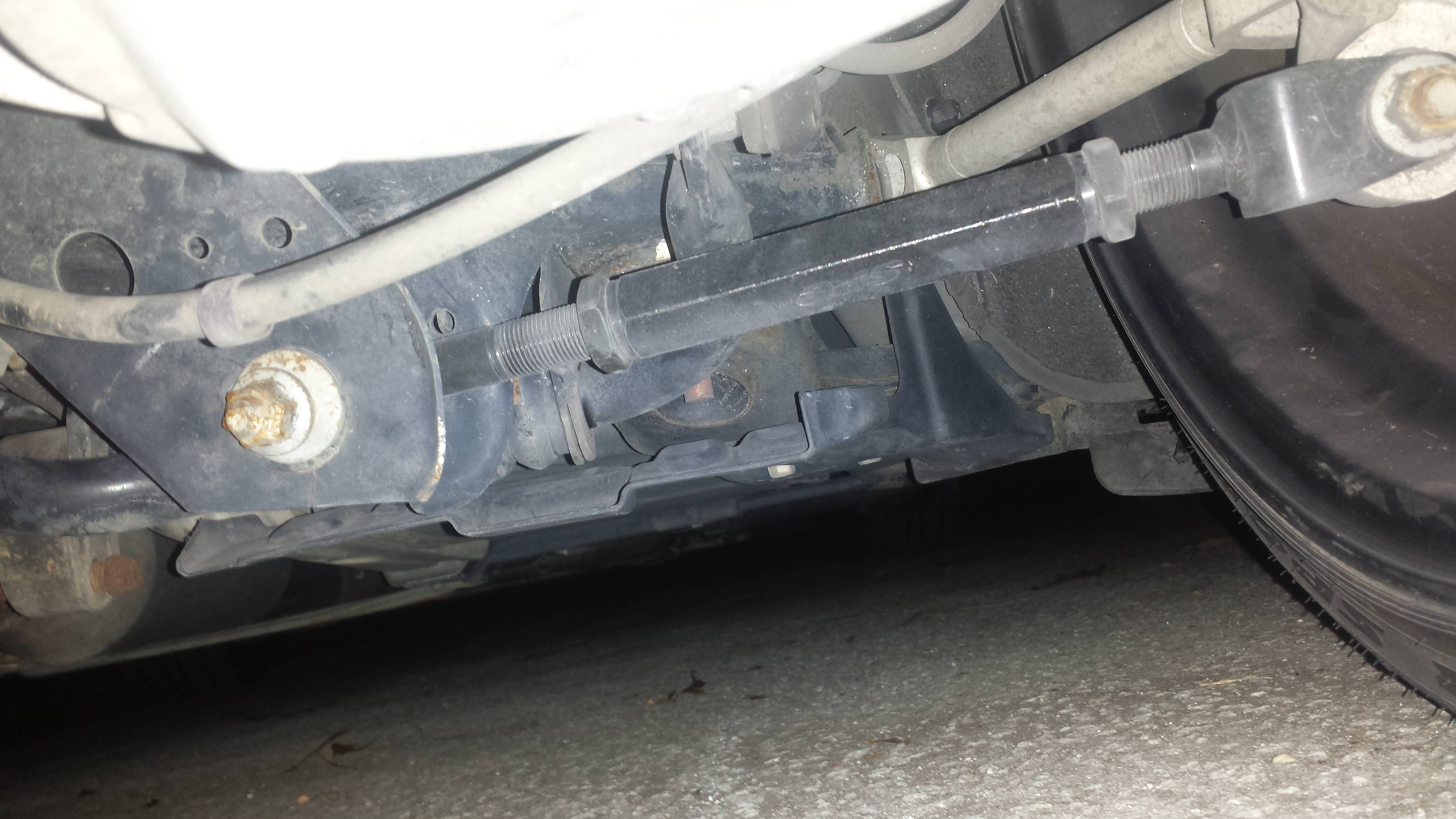

Read this and just knew that I installed the straight bars. Have had them on for better parts of a year almost and the only sound I hear is the scrape from the metal tab that holds the bumper. No other issues what so ever. I am dropped on tanabe coils with the spc camber arms
Attached Thumbnails Rear spc camber question.-dl5bvuu.jpg   Rear spc camber question.-tr2st8p.jpg   Rear spc camber question.-n37ez8q.jpg
