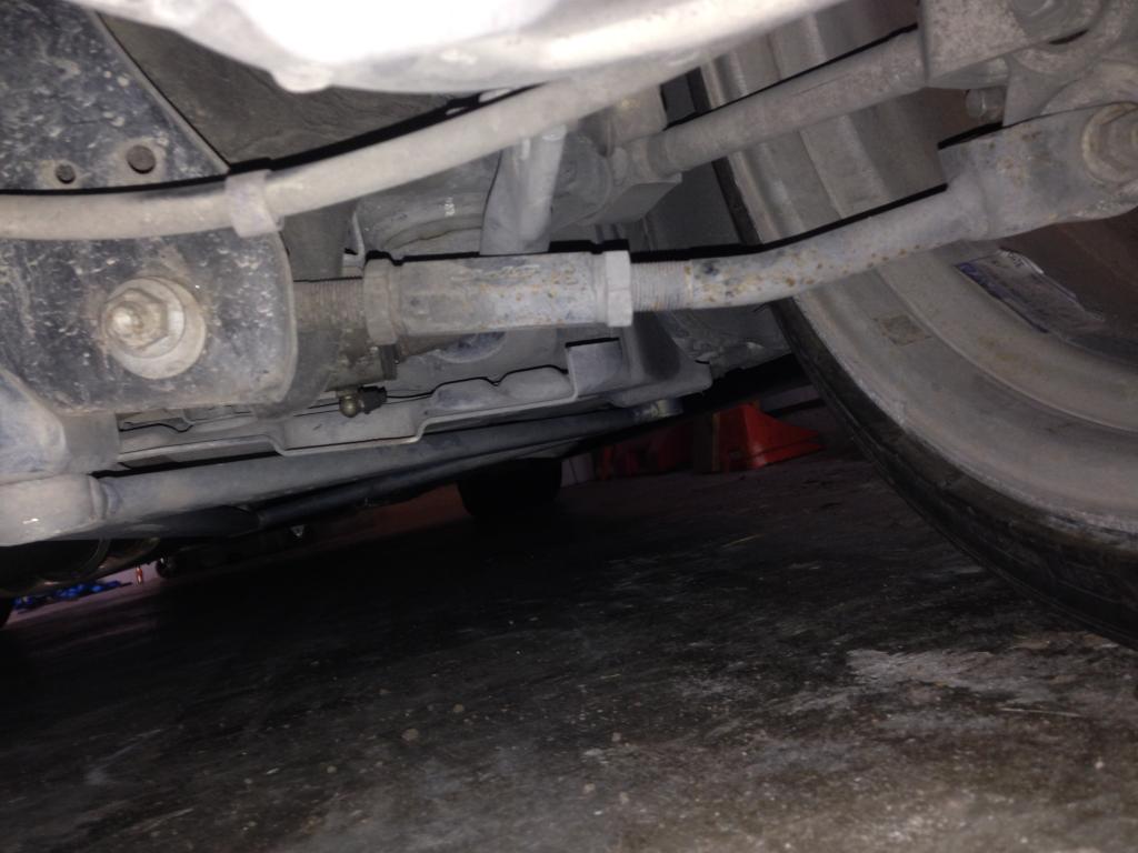

Here's a photo of the straight arm installed on my car.
Old Aug 20, 2014 | 11:09 PM
  #29
Houston, we have a problem
Old Aug 20, 2014 | 11:15 PM
  #30
MylilG's Avatar
MylilG
Joined: May 2014
Posts: 89
From: Richmond, VA.
Holy crap!!! That's definitely not good.
