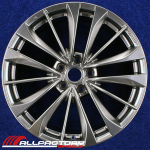

So I know there are alot of threads talking about the best spacer sizes with the Eibach Pro Kit drop, however every single thread I have looked at refers to a different wheel than I have. I have the stock 2011 G37S rims, Enkei 19'' Sport OEM rims. I've attached the picture of the rim I am referring to. With these rims will I need spacers? I know alot of it is subjective, but what do you guys think? Any one have pictures? Worse come worse, I can order the spacers after I install the springs and before I get my car aligned.

Here you go, these are the previous year coupe 19s but the fit will be the same~
https://www.myg37.com/forums/3665763-post28.html

As long as that link I posted is the look you're wanting it's a good combo
