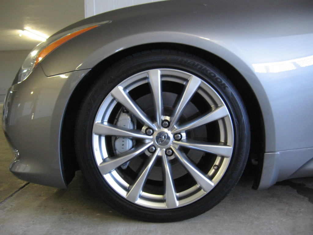

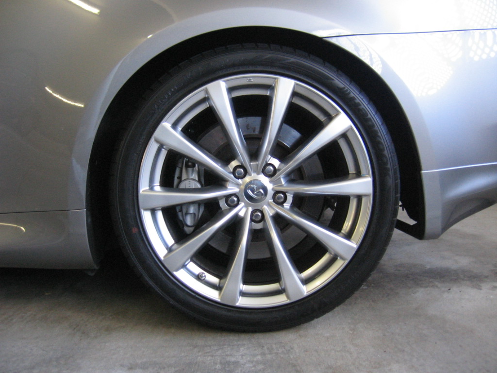

here you go. 3 days after install.

Eibachs will give you the much needed drop at the front. Along with the rear springs, they will provide a moderate drop so that you car will have an balanced stance.

Thanks for the replies and especially the photos. That helped tons. I definitely will be installing the rear springs too now that I see the balance. Besides I don't want to throw anything off.

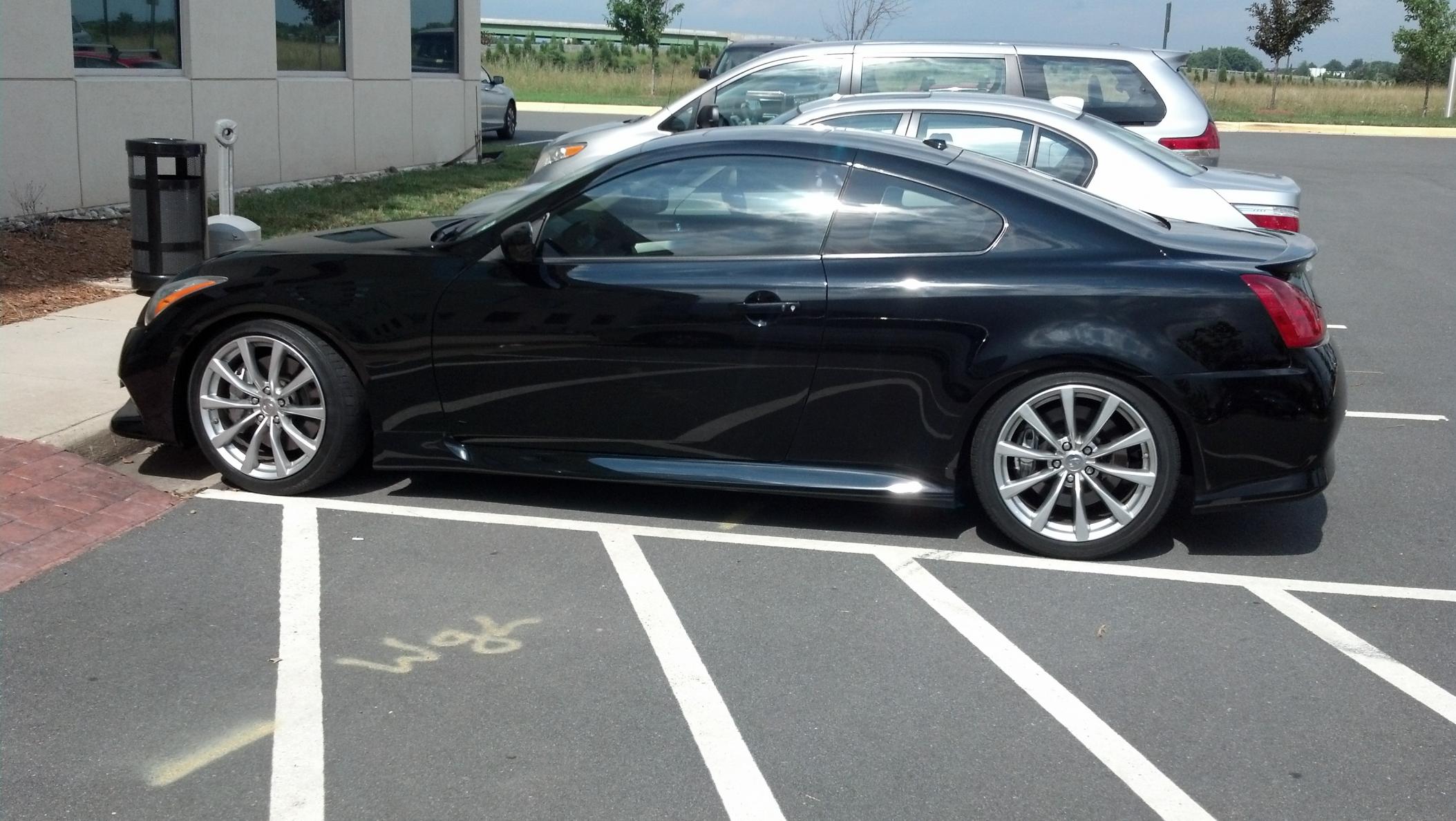

I think TVPostSound changed to swift springs based on a later post. I also have the Swift Springs installed, however the rears look a bit lower than I expected for some reason. I have the 20mm front and 15mm rear set up just like TVPostSounds current rig. Check out this photo from the driver side..

I also have the eibachs. no camber kits. back is within oem spec, front is -.1 and -.2 out of spec. very close to OEM range. over time this may cause a little wear on the inside but I'm not worried about replacing tires 2-4k miles early. I'll have to replace them eventually anyway and may never own the car long enough to be blowing through multiple sets of tires. also running 19" stock sport rims with 20mm spacers front and 15mm spacers rear. spacers are a must after dropping the car to get the right look. i have a 1 finger gap front and back. looks great in my opinion. by the way, I have a 2010 coupe and the rear camber can be adjusted quite a bit but the front has no camber adjustment so you get what you get when you drop it.
