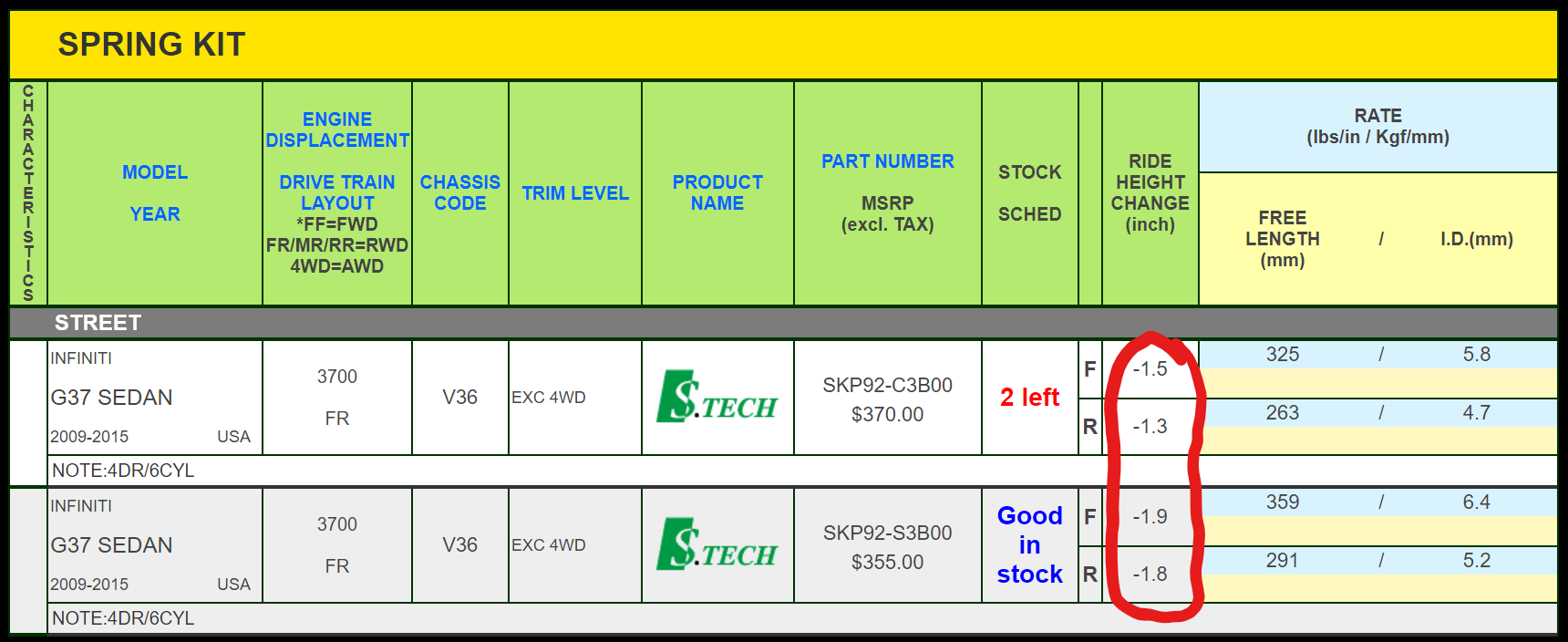

Tein only lists two options, both with a large drop: https://www.tein.com/srch/us_search....ault&genuine=0

I saw a TEIN EnduraPro Plus option on Concept Z's site, so I called to discuss. Not much history on these, and the kit was on backorder 3-4 months.
Then I called TEIN as they have a location in LA.
TEIN EnduraPro Plus: https://www.tein.com/srch/us_search....ault&genuine=0
Per the table on this page:
VSP92-B1MS2-L (Front Left, adjustable)
VSP92-B1MS2-R (Front Right, adjustable)
On the site, rears are just EduraPro, not adjustable per the website: VSP93-A1MS2 (Rear Shocks)
When I called TEIN (answered the phone like in the old days), they were friendly referred me to their largest partner in LA called Options Auto Salon: (626) 812-7222
They too answered the phone and then verified that the TEIN EnduroPros/Plus are made in China, but that they have not had any issues with them at all and believe that TEIN wants to move all manufacturing to China over the next couple of years and take over the spot Tokico used to occupy in the aftermarket.
Spoke to someone named Jasper, explained the Coupe vs AWD vs Journey vs Sport Sedan dilemma, and he recommended the TEIN EnduraPro setup over Koni (they sell both) as the cost of the Koni is more than double and he felt there is no difference in quality. He also said that the Koni setup only lists the coupe as an application. He thought it was odd that Infiniti killed the factory Sport replacements and now direct everyone to the journey setup. Good enough I guess?
The PN is VSP92-B1DS2 (Kit): $490, $570 shipped.
-Front and rears are adjustable
Anyway, thought I'd post my findings here as the replacement shock/strut pickings are getting slim for the Sport Sedan.
