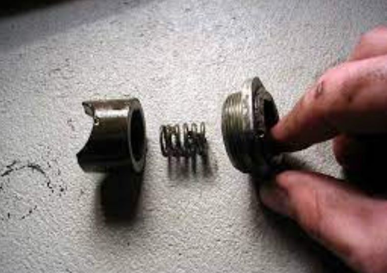

The issue in question is the typical "moist/leak" around the rack's adjuster bolt. Almost EVERY rack and pinion uses this type of design to adjust the preload of the rack shaft so it is in specifications. This bolt is responsible to keep that shaft centered which keeps your pinion from destroying itself as well as outside seals. The two-part design is one that is a bit controversial since it will "always" try to leak vs the Capped design.
This adjustment screw is responsible for shaft play, unfortunately adjustment on older units most times leads to failure due to the wear on other parts as well. The half moon, the shaft and the plastic bushing that the rod rides on will all wear so as you adjust you put additional strain on the rest and you'll kill the rack faster.

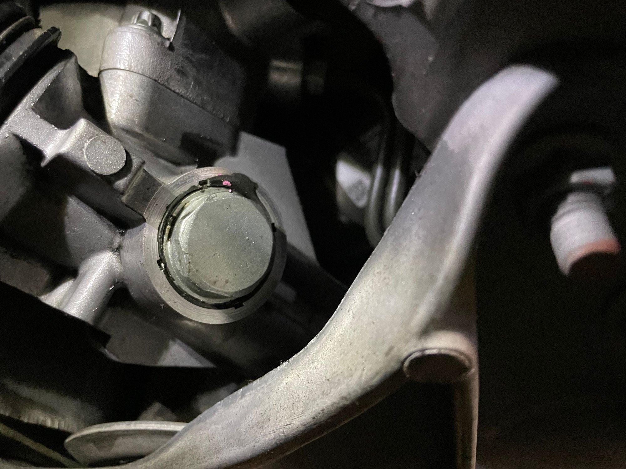

5. With some Rustoleum Enamel paint either in a spray bottle or with a stencil go to town on this bolt. Seriously, glob as much as you possibly can concentrating on the threads as the pictures show.
6. The idea is to have the paint penetrate into the threads and build a layer that will act as a seal (similar to copper gasket spray)
7. Help the process out by heat or air so the paint can dry faster. (needs to overcome the rate or the seep from the rack or else the paint will never dry)
If done correctly it should look like the pictures below. I did this process 3 years ago on my rack replacement. I ended up with a used unit that had this leak and this process worked.

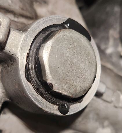

So the rack adjuster bolt manages the preload on the rack gear causing it to mesh tighter with the pinion gear correct? This should not be adjusted once in place as it will put additional strain on other aged components within the rack, causing premature failure.
Since the fluid leaks/seeps at such a low rate on most of our cars, is this fix required, or is it only recommended for a leaky rack to avoid replacement of the expensive rack assembly? If the latter, once you drain the PS fluid and reinstall the rack adjuster bolt with the required paint, then how do you know how tight to adjust the bolt to get it within spec (torque?) and not cause additional damage to the other aged rack components? Are there advantages to applying the fix on a rack with the standard seepage (below) and bringing the preload back into spec? Would something like teflon thread tape work as well?

I agree. In your case you're no longer moist, you have started to leak
Make sure you do this with the car cool. In your case it might be a bit harder to get it to not drip oil as you're cleaning it. Clean it with white paper towels being that they will show you were there's extra oil.

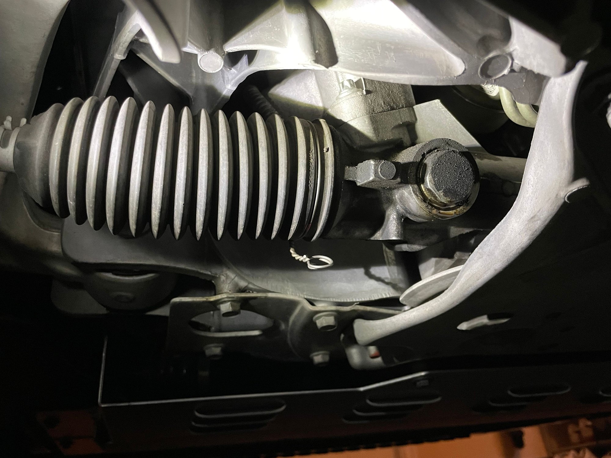

I've never seen a drop of fluid on the garage floor? I had the classic moist look a few weeks back, but I tried to reach up under the car and wipe it from afar as I wanted to see how long it would take for the moist look to return. I probably need to check it out again when I'm under there as the photo may be misleading.
I have a trip up north planned Wednesday, so I cleaned it up a little better this afternoon, then look for leaks when I return wednesday. If you look closely, it almost looks like paint or something similar was added to the threads originally?
