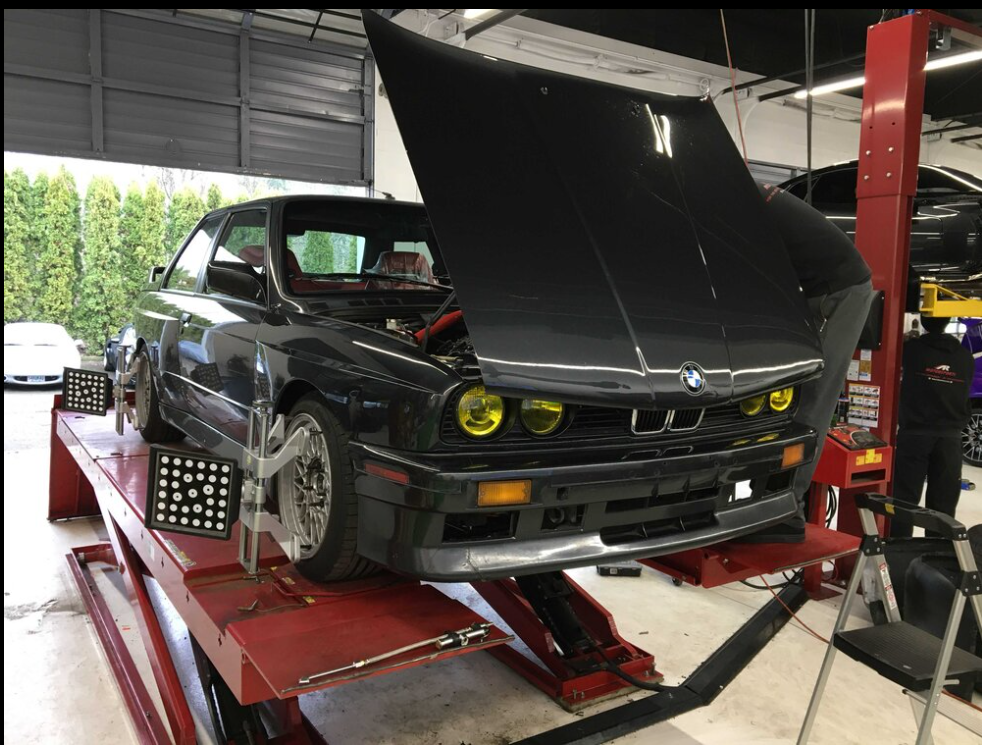

As for the "suspension dyno" that's what several performance shops around here call their fancy alignment systems. I'm going to a shop that is knowledgeable about motorsports applications, so I assume they know what they are doing. Here's a pic from their "Services" page where they talk about suspension and alignment:
Those look like laser targets, and I trust lasers.
/s
