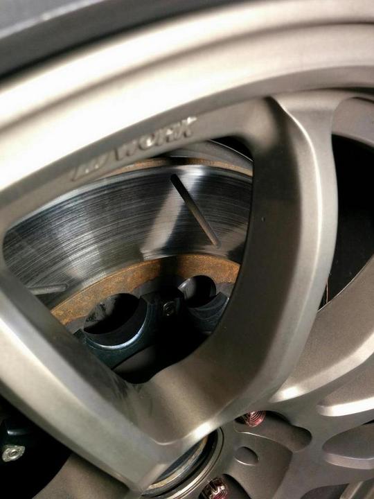

Originally Posted by Crazyirish
I only know what i've read online. Supposedly allows for difference in thermal expansion between the rotor and hat, helps with pad knockback, and generally smooths out braking performance. I'm sure its totally overkill for a street car, but worth knowing its an option.
The Z1s do allow for thermal expansion, at least radially where it matters. If you look at the design of the hats and the bolts attaching the rotors, they're slotted outwards for that. Doesn't look like much, but it's enough.
I've not experienced knockback yet with the Z1s and I do go pretty hard on the brakes. Hard enough to burn the coating off the rotors.

The 2 piece STILL rust on the outer ring of the hub? Ugh.
I was thinking to ask about that. How old is that rotor? Miles, climate, etc.

6 months old, Southern California. They would not rust under typical use, as they're coated. However, I managed to get them hot enough under heavy braking during trackdays that the coating burned off. General use should have them last far longer.
