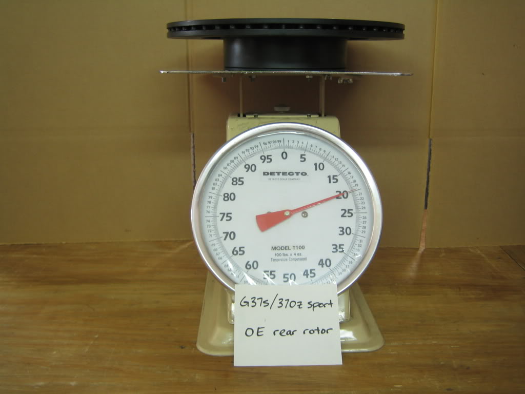

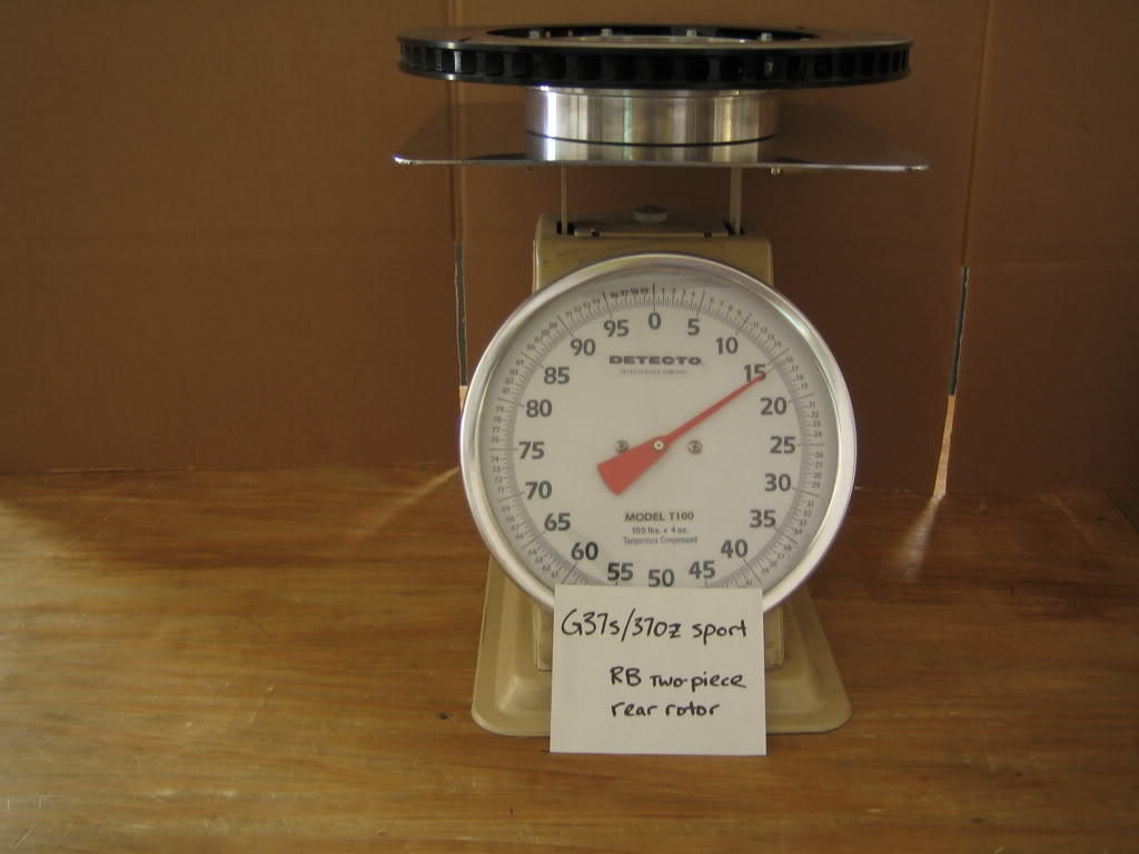

What are the specs? No wait...
OEM vs. Z1, fronts: 21.0 lbs, vs. 11.0 lbs.
OEM vs. Z1, rears: 17.5 lbs vs. 12.5 lbs
So the fronts are twice the weight reduction as the rears. That's interesting.
As an E-brake, it would give me pause. As a P-brake, nah.
Those must be the specs for the non-Sport brakes, as the OEM front Sport rotors weigh in at just under 30 lbs. The Racing Brake 2-Pc front rotors came in at right around 19 lbs. The OEM rear Sport rotors are just under 20 lbs and the RB 2-Pc rotors are 16 lbs. So almost 11 lbs weight savings per corner (for the front) and around 4 lbs per corner (for the rear).
I can't find the pics where we weighed the fronts, but I will keep looking for them. Here are the pics of the rear rotors being weighed.

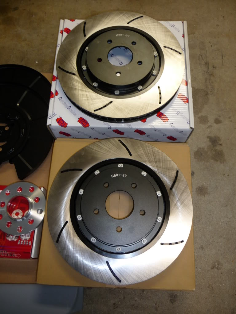

Here are a couple more pics of the Racing Brake front 2-Pc rotors.
