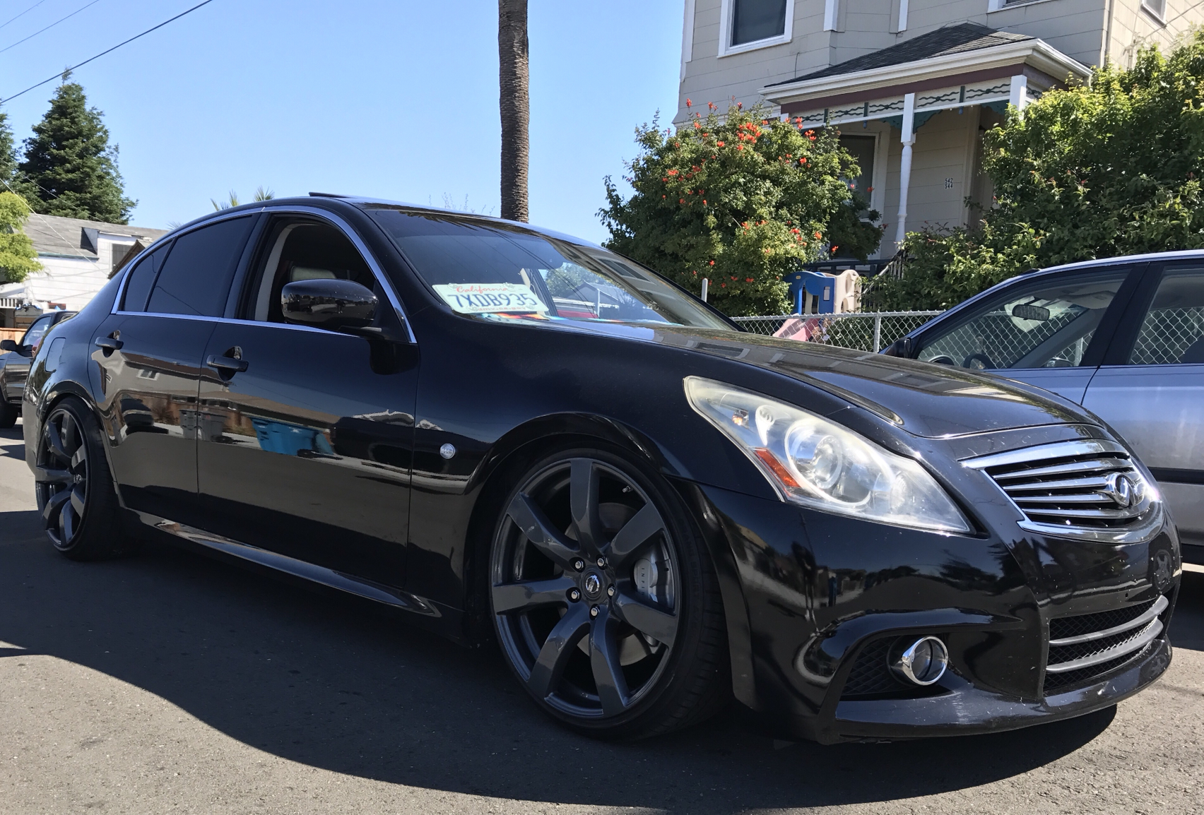

From: Northern Califas
I think it all depends on your wheel setup as well. I recently purchase R35 rims and the ride is so much better then my stock wheels. I was starting to give up on tein but they came through with the clutch boiiiiii ha
Old Jun 15, 2017 | 03:30 PM
  #120
future62's Avatar
future62
Joined: May 2017
Posts: 559
Likes: 48
From: Charlotte, NC
What kind of wheels did you have before? Are the R35 wheels lighter?
