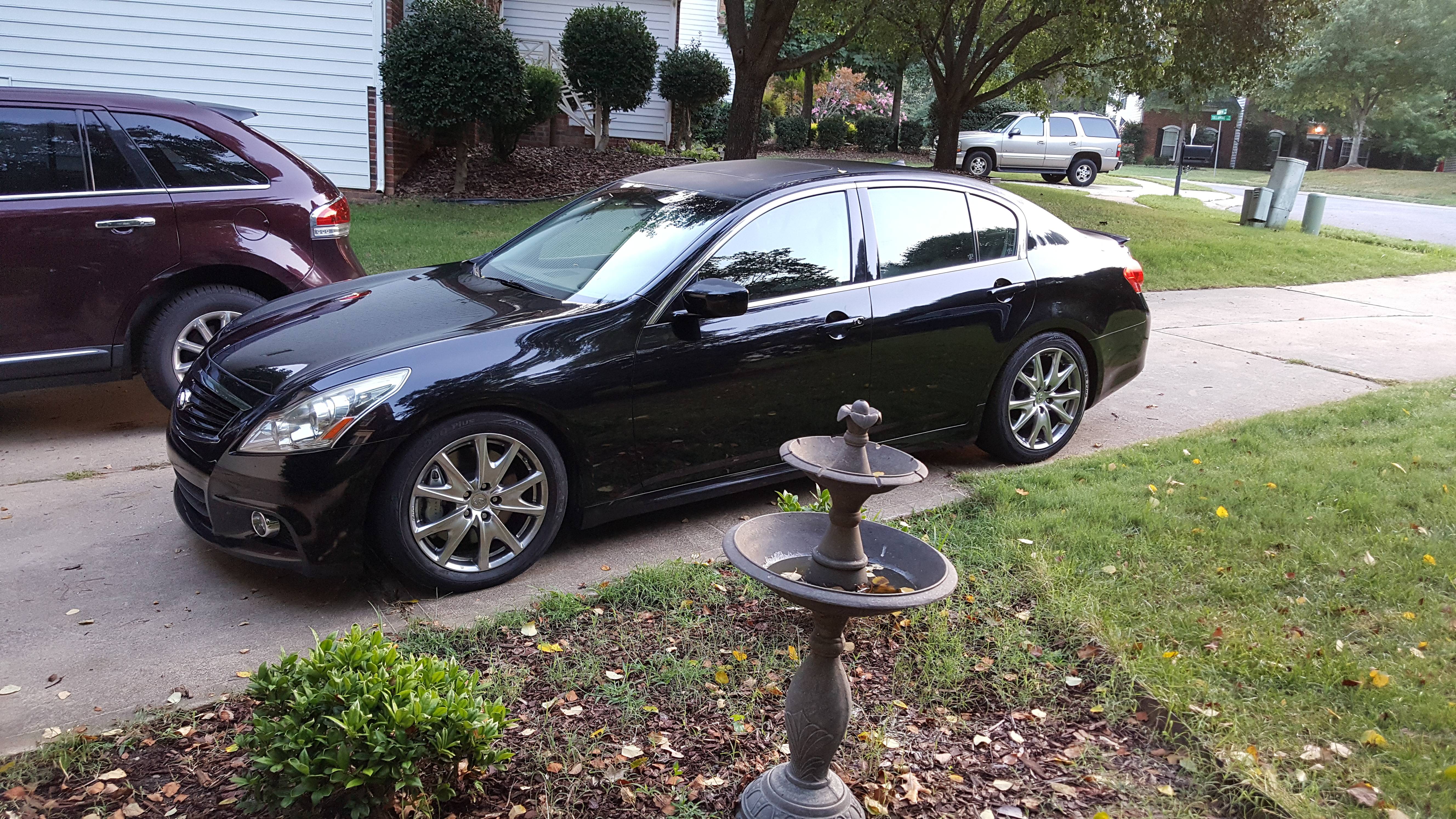

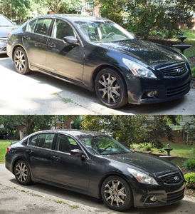

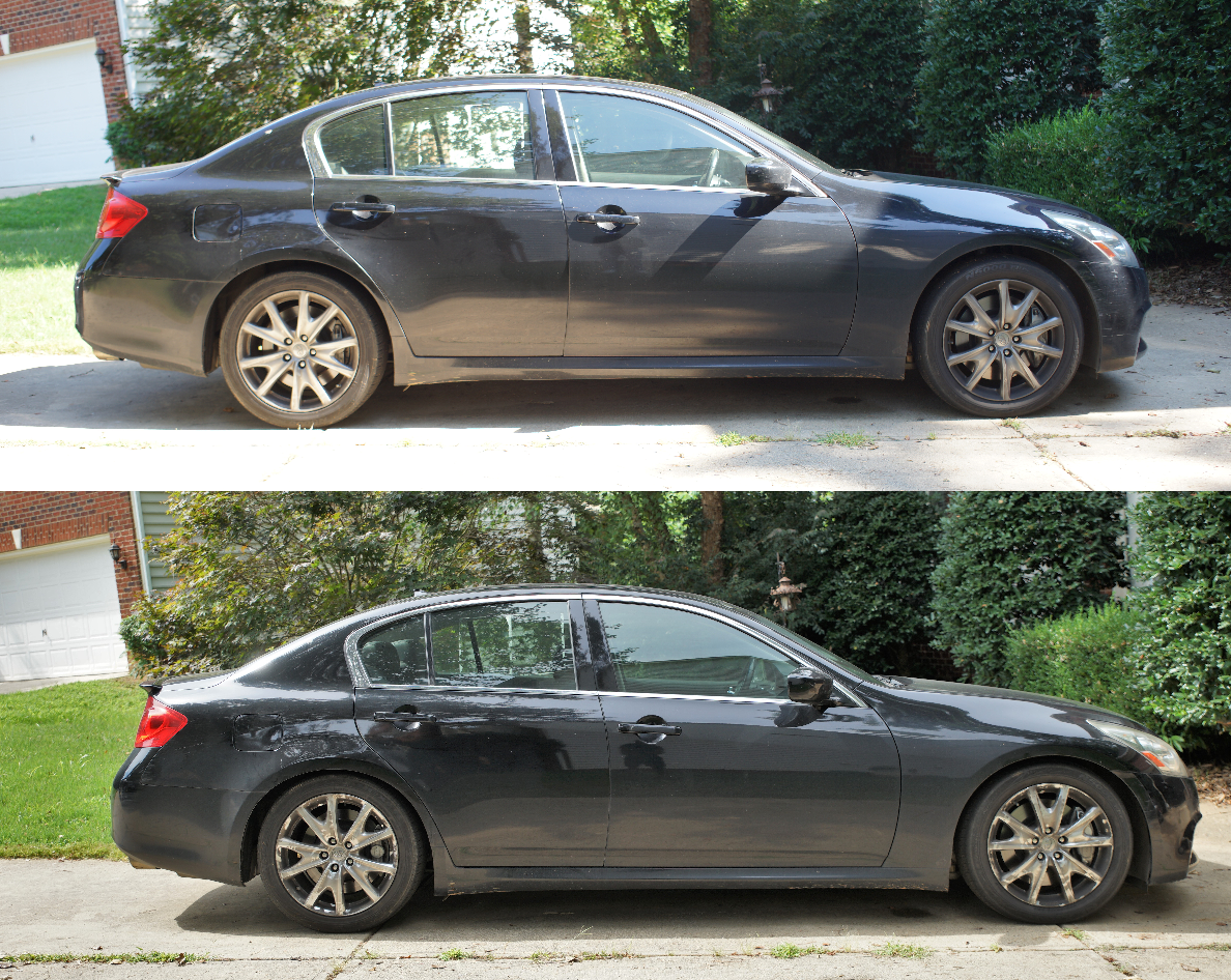

Installed but not done

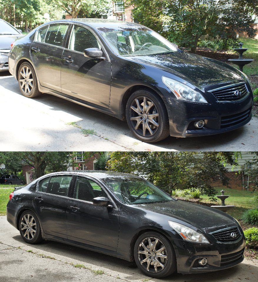

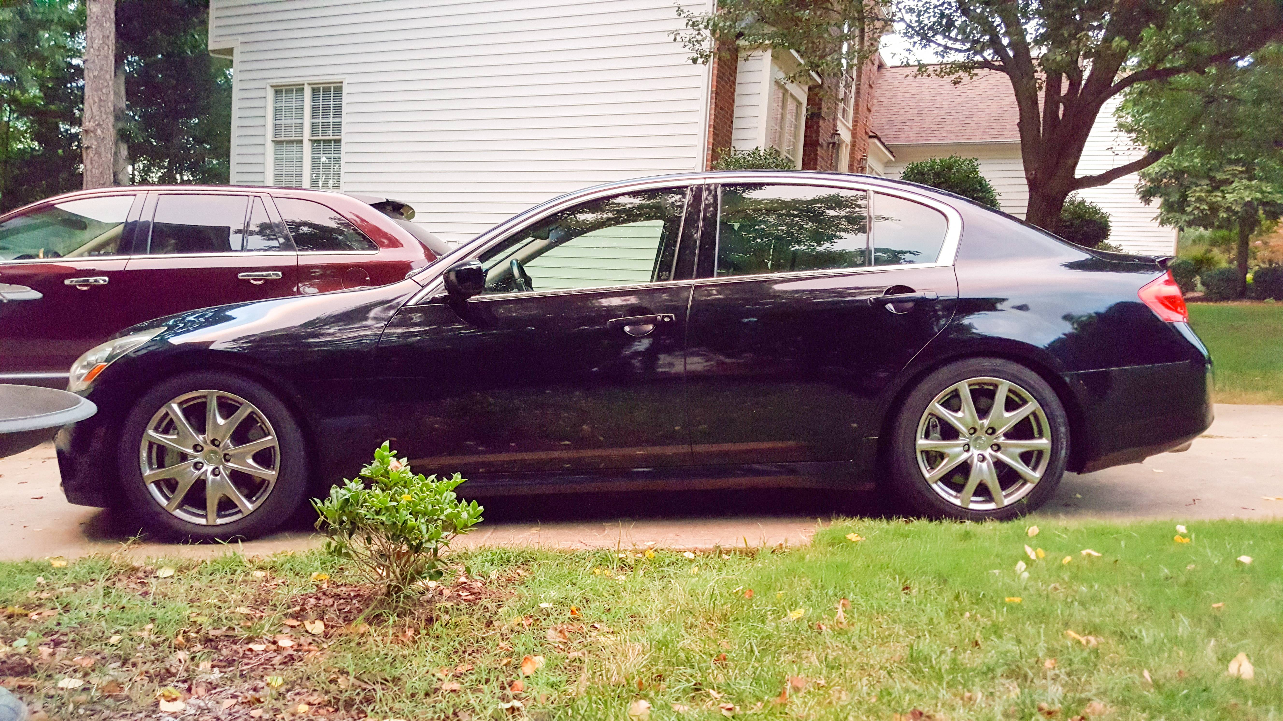

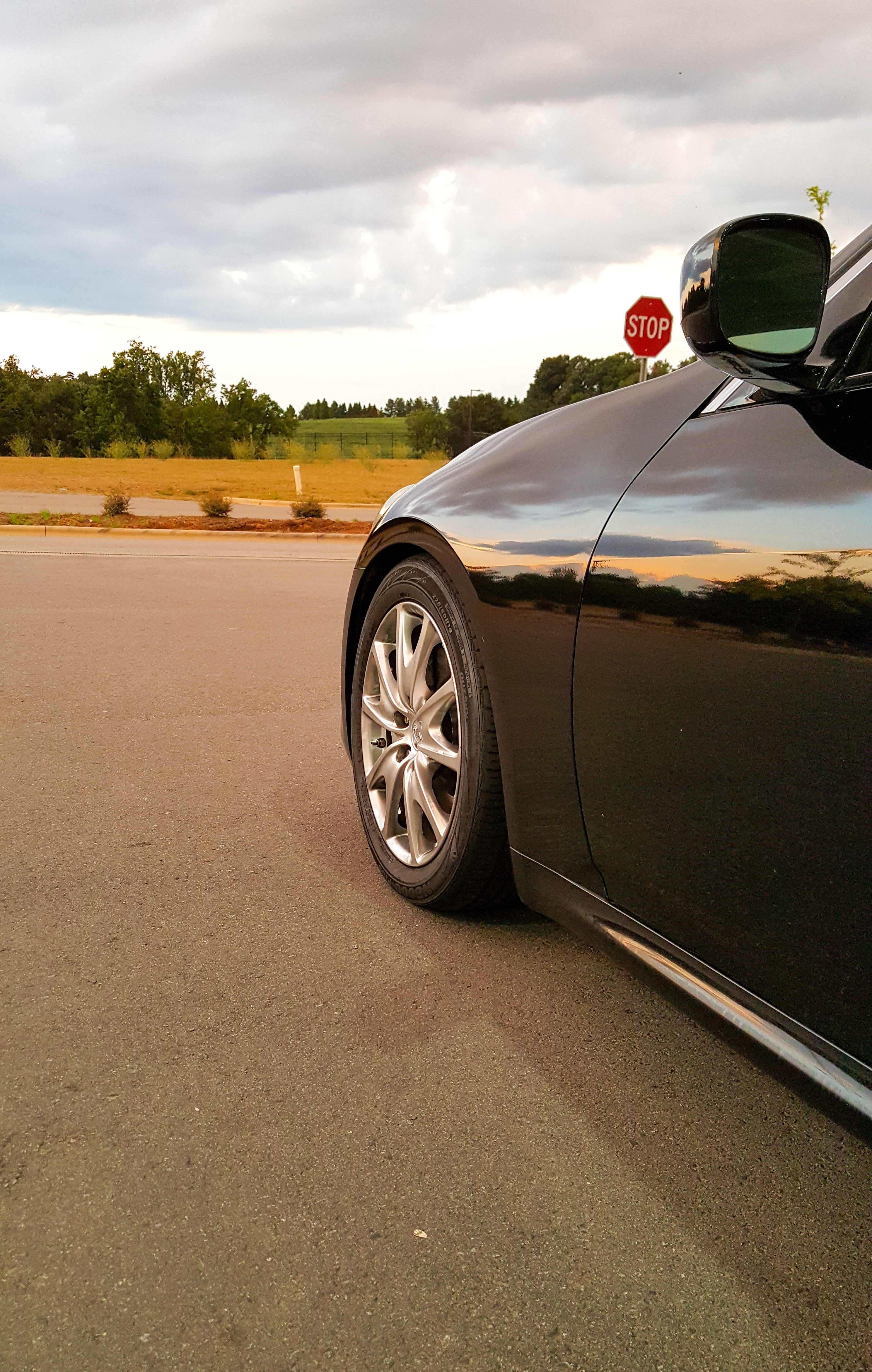

Gotta get my spacers on, give it a week to settle, and then pick my final heights. Adjusting height is actually not bad; I am able to adjust the fronts without taking the wheel off.
Gonna have to do my commute before I can give a full assessment but I will definitely do a full review. Just tooling around though, it feels almost stock but with much tighter damping. I do have a new rattle in the right rear corner.... everything seems torqued so I'm afraid it might be the damn shaft nut For <$500 shipped on some websites though, if you want to be dropped at a reasonable height these things seem to be an effing steal. Everything seems pretty quality and the instructions are straightforward.
Oh yea, for reference the rear springs are 5" OD top to bottom.

Looks like a decent balance front to rear from the pics, coilovers settle quicker than lowering springs, 3-4 days would be enough. Hopefully that noise is a simple fix, should be
Did you get some aftermarket camber/toe adjusters?
Looks like you're just a bit higher than me (26.25") looks to be about 26.5" all around???

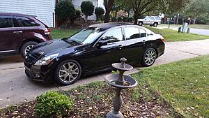

These pics are after I raised the front and got some gas, so no new measurements yet. Hopefully will have it all together tomorrow.
Old Jul 16, 2017 | 03:10 PM
  #154
Posts: 19,859
Likes: 5,149

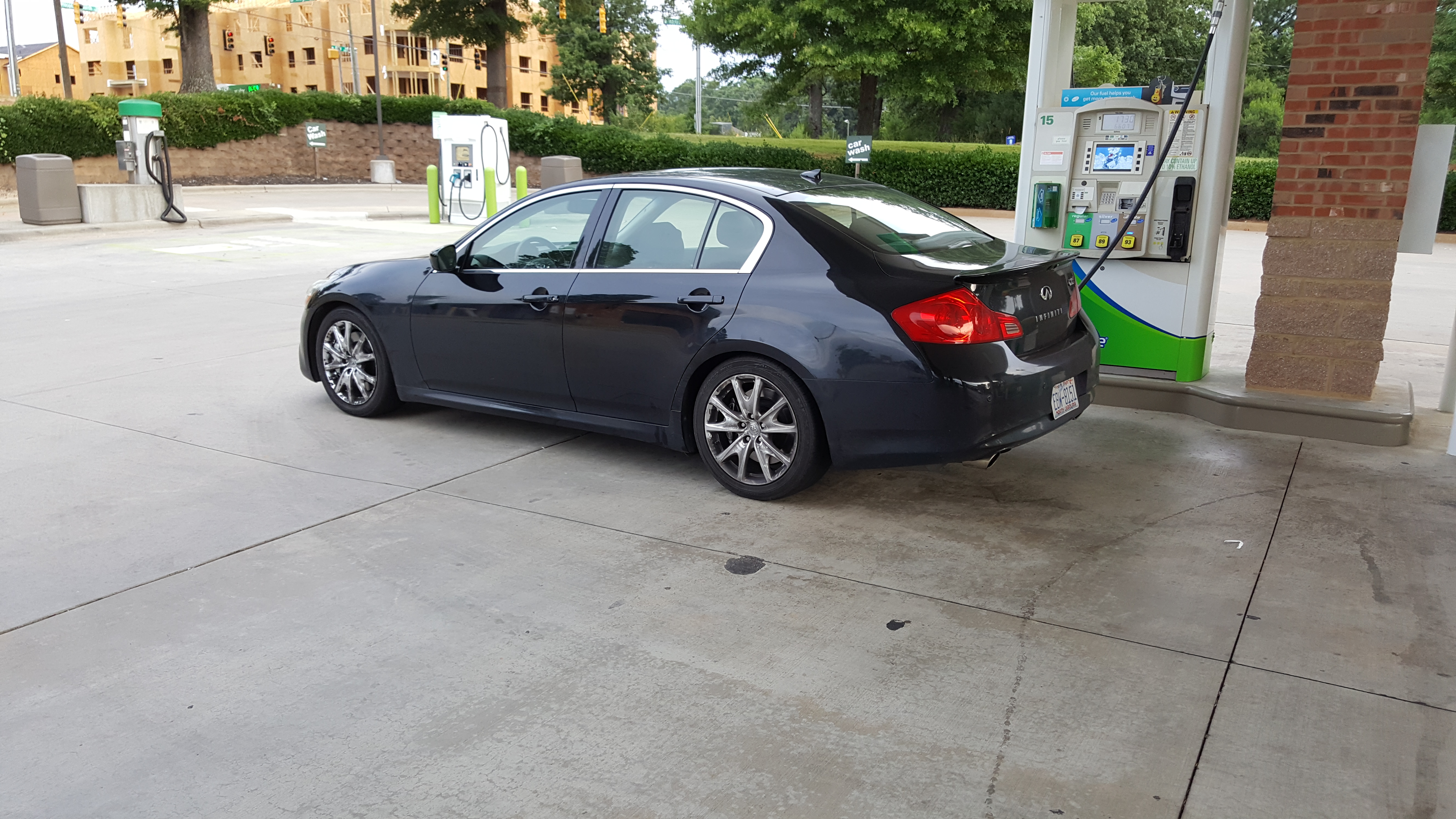

From the looks of it, that driveway isn't going to provide the kind of level stance and weight to all four corners to satisfy any sense of accuracy. Find yourself a nice flat section of poured cement, like a parking garage.
Spacers if you drop on duckfeet... definitely.

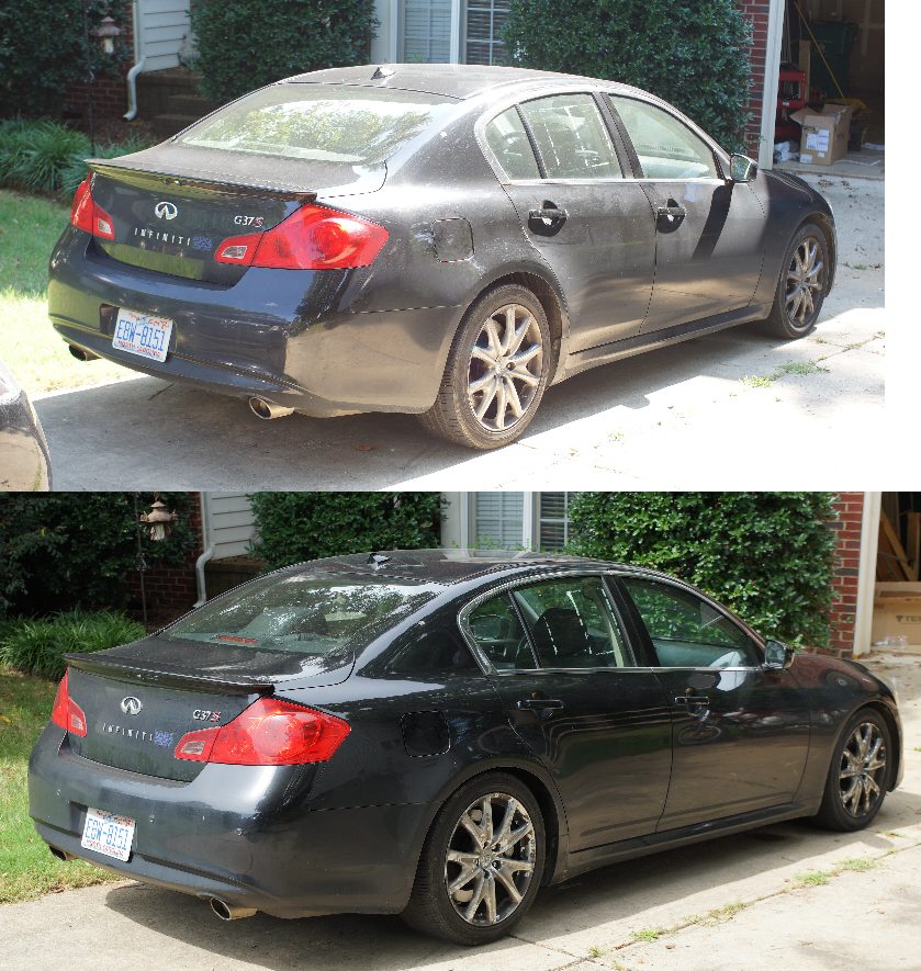

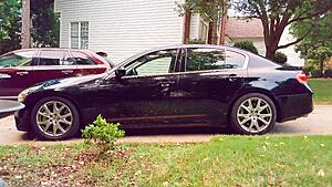

My garage floor is level; I take my measurements in there. I will see if I can use my ultra wide angle lens and get a photo of it in there.

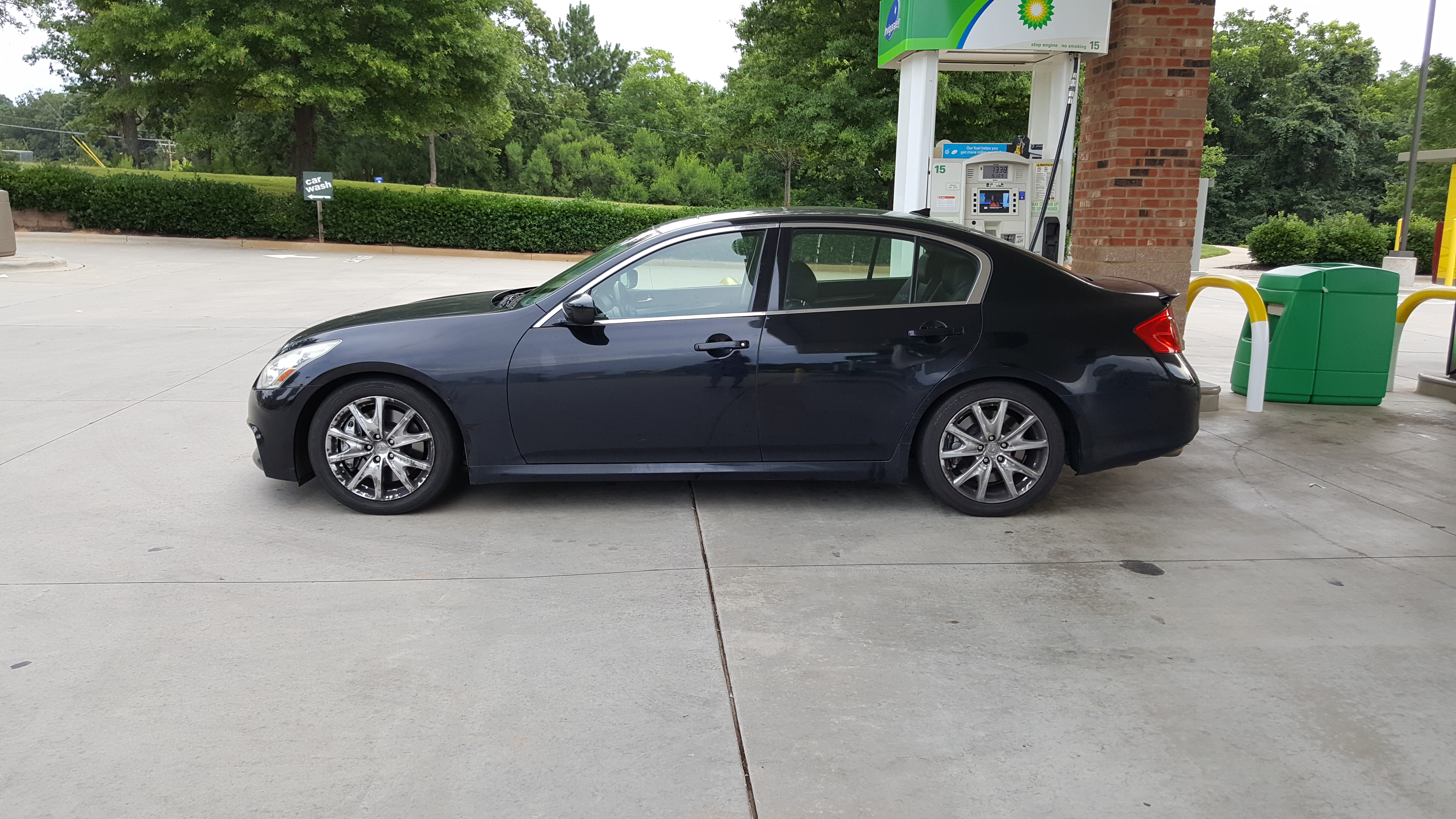

I did snap some at a gas station... this should be level
I think I lowered the front after this though I definitely need to get the spacers on, as well as a wash. I just need to find a brushless wash
Old Jul 16, 2017 | 04:10 PM
  #156
Posts: 19,859
Likes: 5,149
What the heck is wrong with your wheels? Looks like 5 years of rail dust. Man, that's painful to look at.

They are OK, just really dirty. The paint is in less than great shape, so I haven't bothered with a car wash. I wanted to get it detailed. If you look at the before photos they have a nice even coat of brake dust.... but after I worked on it it looks a lot worse. Once I get the spacers on I'll get it washed, then just get it detailed later.

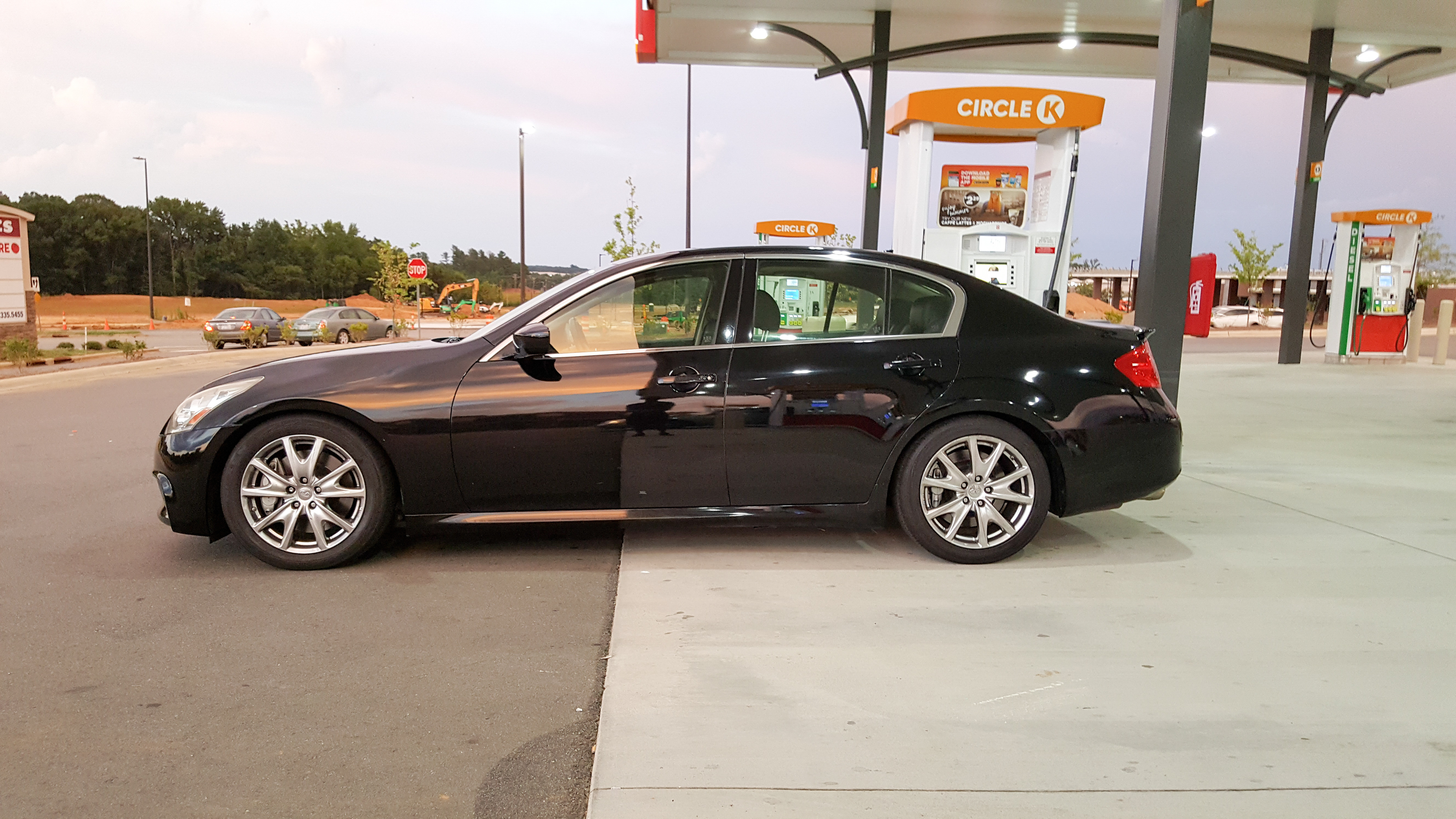

@26.75" at all 4 corners (rear sleeves at the top of adjustment range, front sleeves at ~1.75" from bottom)
Overall impressions... good for the price. Low speed body motions are very well controlled, which makes the car feel planted and confidence instilling. Higher speed stuff like bumps and ripples is not so well controlled. Rides a little "busy". I could see this being awful if you live in an area with crappy roads. Something else to note is I'm pretty sure the spacers lowered the effective wheel rate. Ride just seems that little bit more plush. Going to wider wheels with the centerline further out than stock will have the same effect. Could also just be the shocks breaking in. Anyways a really good deal. All the components are quality and I see these working nicely for a long time. Just make sure you torque everything! I had a rattle in the RR corner that turned out to be a loose shock shaft nut.

Nice initial review, and good reference for how high you can run these. So 26.75" is the mildest drop you can get while still retaining enough threads in the collar for the spring.
Good to know for those asking if you do a minimal drop. I guess that equates to about 1.25" down from OEM???
That's where my rear install is at, 26 3/4" floor to fender. I'll take this as corroboration. GTK
I don't know the RWD Sedan height off the top of my head, but I think it's 28", like you're saying. IIRC, it differs from the AWD by 1/4". Or the floor-to-fender height is the same, but the ground clearance on the AWD is different. Don't feel like finding the info just now. Anyone?

My sedan was 28" up front and 27.5" in the back. I will have to double check where I am tonight. Might still be settling.

That sounds right. The Sedan's rear fender line is 1/2" lower then the front. It's what contributes to the whole droopy bum look, exasperated when you drop the car. If you match floor-to-fender in the back and the front, you actually introduce an imperceptible 1/2" rake.
