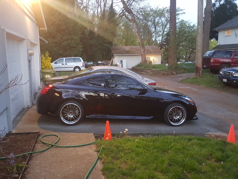

Bump for more opinions. I was near close to going wit swifts and oem ipl dampers but saw the basis and now am leaning to them. Car is daily cruiser. Just want to close the wheel gap. Not slam just close it.
Does the coupe suffer the same 'droopy' butt look when lowered?
If not, Koni yellows would give you dampening adjustment. I can't imagine IPL dampers being cost effective or significantly different from the OE S dampers
Keep the shocks you have now (unless they need to be replaced) and just get lowering springs. That is the cheapest option to get what you want- a lower daily driver. If you are not preparing the car for track days, koni inserts and coilovers are overkill.
I agree with you 4DRZ. The coupes don't seem to suffer as much from the droopy rear like the sedans do. However, I would go with a spring like the Eibach's instead of the Swifts. There are a ton of pictures of both setups on the forum.
