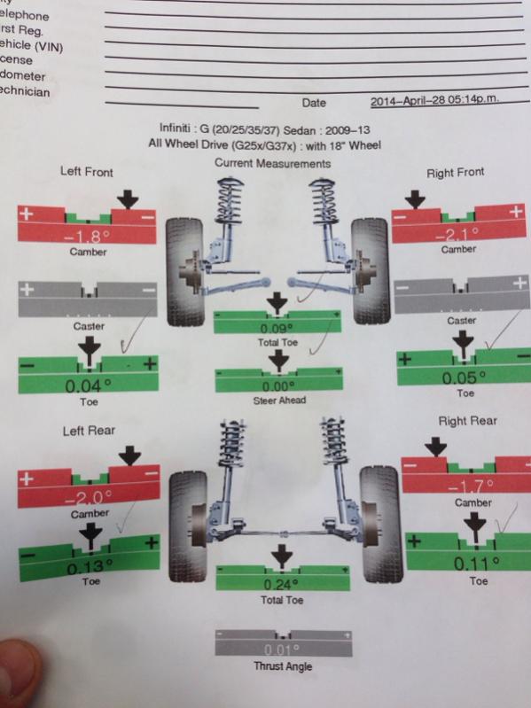

Here are my specs after alignment with swifts installed
Are the front and rear camber kit required
Attachment 103982
I recently dropped my 2012 G37xS on Swifts as well, and I got the same results. -2.0 camber in the front, and it can't be adjusted.
I was under the impression that with Swift springs I would need NO camber kits, or only rears if I wanted.

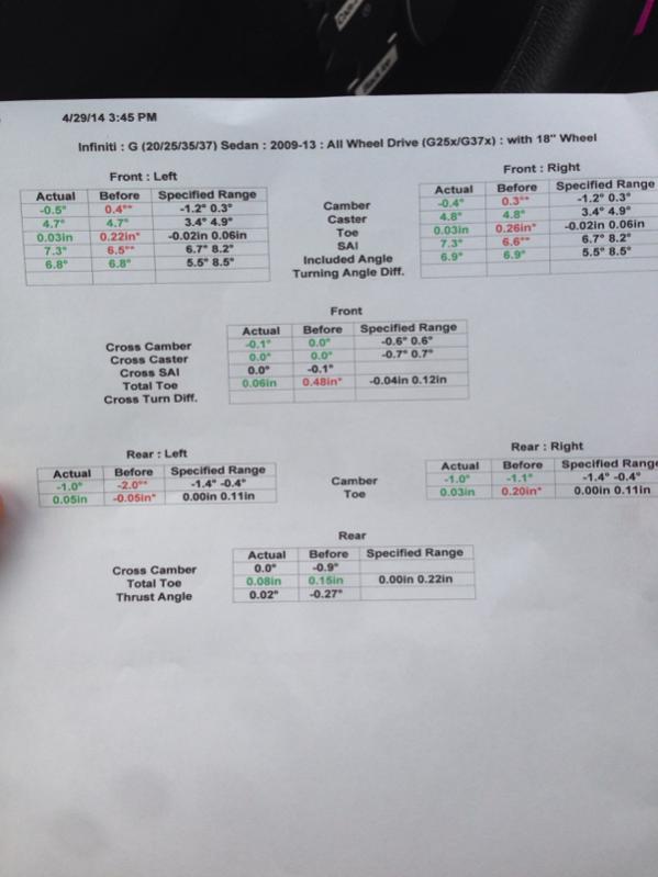

Just had another alignment after the SPC camber kit. Much better
Attachment 104015
That's one of the best alignment sheets I've seen, even a bit better than mine.
