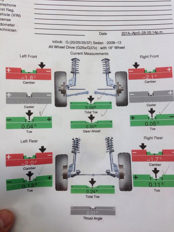

Here are my specs after alignment with swifts installed
Are the front and rear camber kit required
Attachment 103982
Required, no but you'll pay for those camber kits over the long term in worn tires. I'd get them.
Good call. When I was researching my lowering options I saw an overwhelming amount of people saying you can get away without. I think the new consensus should be that if you lower your car, the proper way to do it is with camber kits. The G37 has basically no adjustment in the front and I have seen so many threads where lowering springs are installed and a week goes by without any abnormal tire wear and then the assumption is made that everything is alright. I see just as many threads saying "Oops the inside of my tires are worn to the belts" maybe I need a camber kit. I came from a forum of a much cheaper and older car with factory front camber adjustment and it was frowned upon to run lowering springs without a camber kit. At the end of the day the choice is in the hands of the owner of the car but it's nice to see when people are equipped with the right information.
That's the general consensus with Swift springs, because it's a very conservative drop.
I was under the impression that most alignments show a -1.1* negative camber. Why would grojas112 be at -2.1* with his Swifts?
