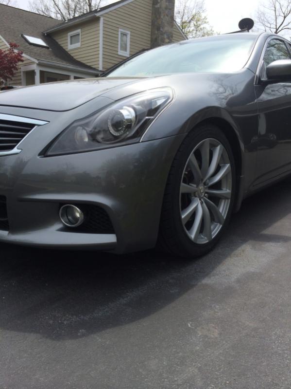

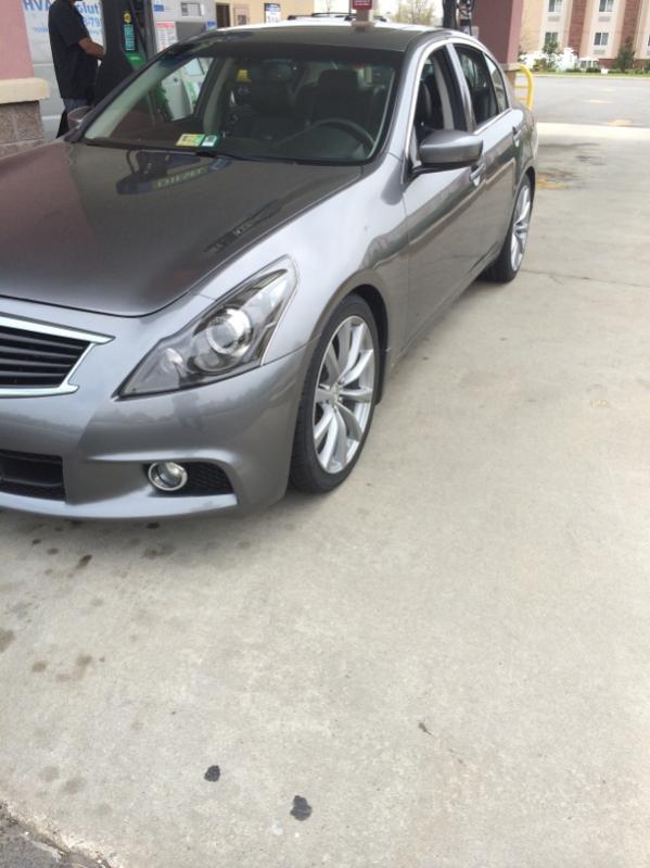

I do feel like the fronts bottom out from time to time. The overall cruising feel of these are tremendous, however. Even speed bumps cause the front end to bottom out.
Here are pics on an X with coupe 19s
Attachment 104053
Attachment 104054
Attachment 104055
Looks great. I do remember that on my previous vehicles I cut the bump stops to keep them from hitting. Did anyone do that with their G? However on this car is the bump stop part of the top hat?
