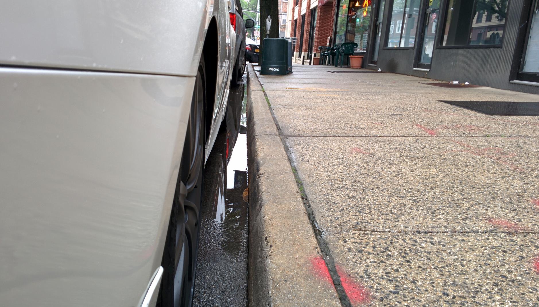

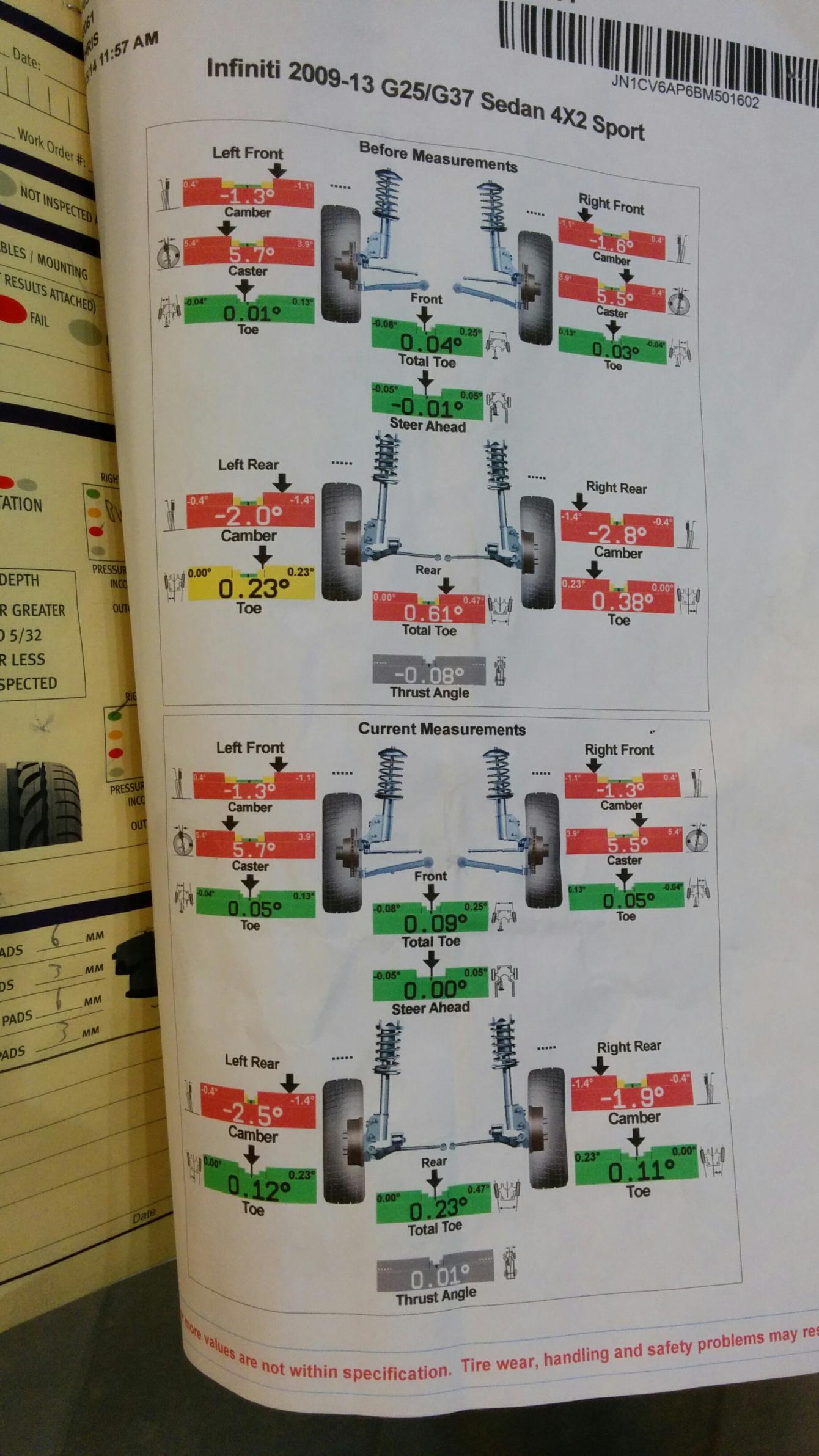

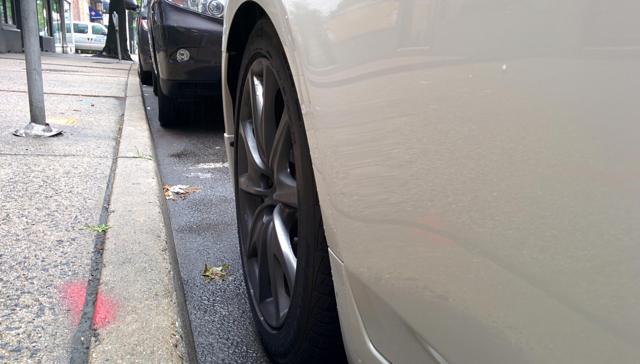

From: NYC

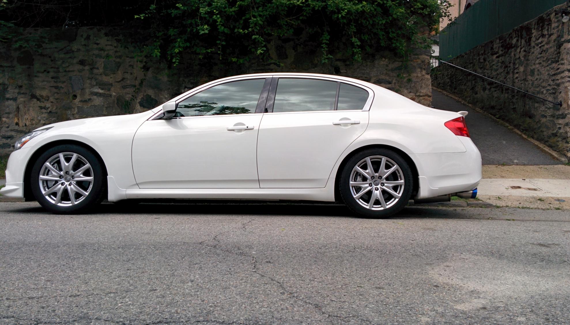

That's my alignment spec sheet...apparently I had that camber with stock tires???
Anywho, mind the plastidip. I got bored. But you can clearly see the negative camber as all tires are pushed inside the fender but poke on the bottom.
Shrugs.
Attached Thumbnails Well Just bought Swift springs-img_20140606_103827.jpg   Well Just bought Swift springs-img_20140606_121006.jpg   Well Just bought Swift springs-img_20140609_144719.jpg   Well Just bought Swift springs-img_20140609_144730.jpg

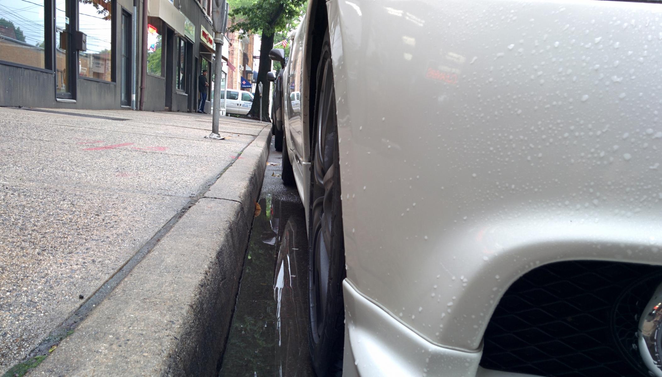

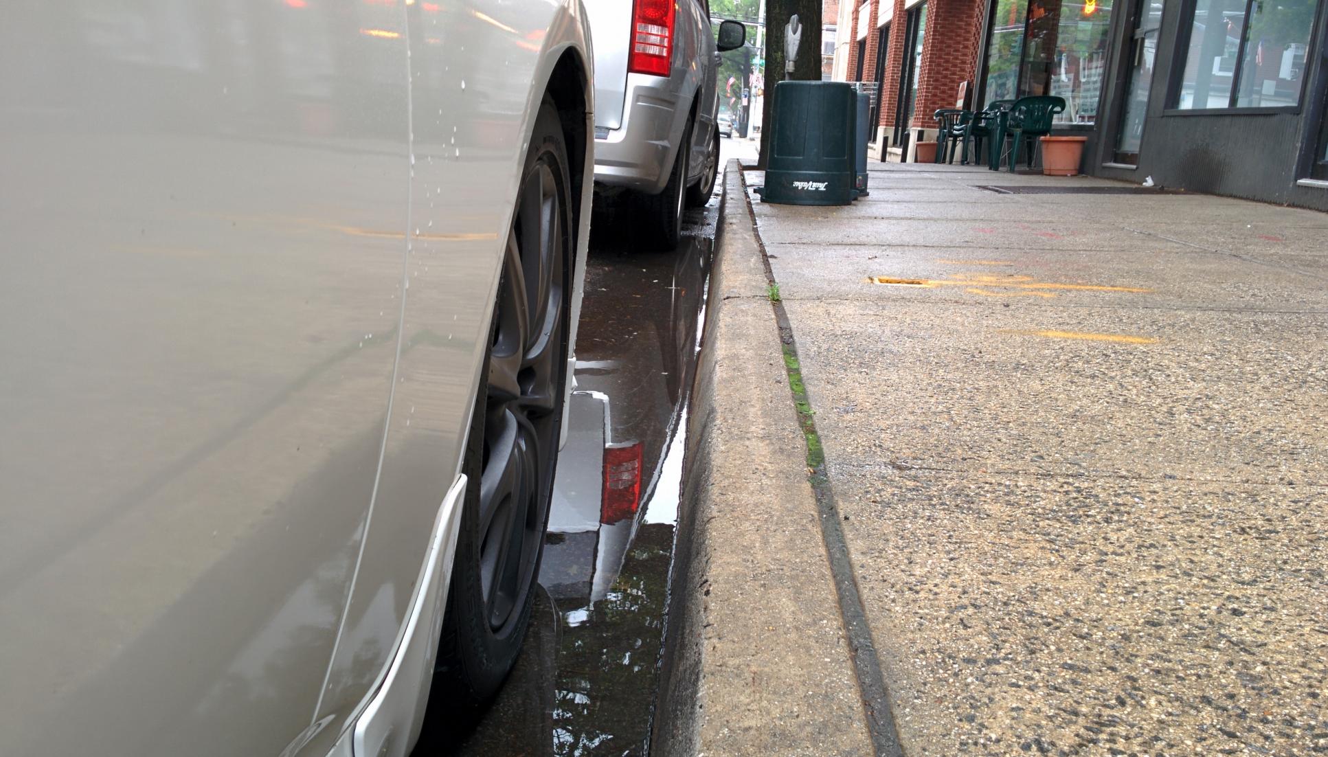

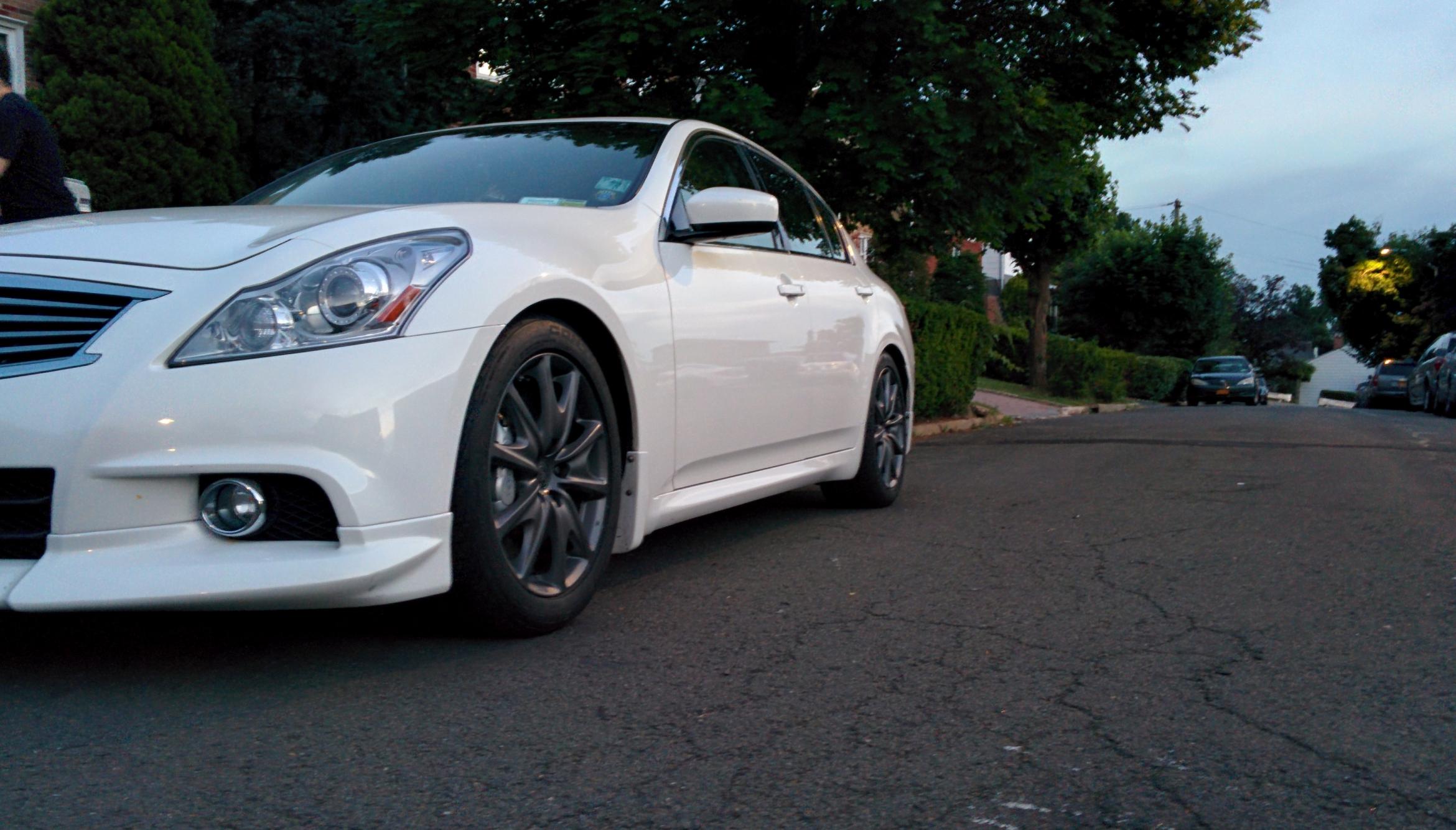

Some more shots from different angles.
Both are on completely flat grounds. Just looks really weird IMO =[
Sorry if picture heavy.
Attached Thumbnails Well Just bought Swift springs-img_20140608_203627.jpg   Well Just bought Swift springs-img_20140609_144713.jpg   Well Just bought Swift springs-img_20140609_144703.jpg
Shrugs.
Seems you and I are in a similar situation, with similar cars. Are you going to get a camber kit for the rear, or front & rear, or just live with it for a while? And now that you've drawn in the tops of the wheels, are you getting spacers or new rims altogether?
Since my duckfeet are now winter rats, I'm strongly considering spacers for the off-season.
It does look weird, dropped on duckfeet without spacers. Maybe 20mm in the rear, and 15mm in the front, and you'll be fine.
BTW, the plastidipped wheels look positively awful, IMO. Sorry.
Shrugs.
Your camber wouldn't change until you dropped it (I assume you had your stock tires prior to the drop). At any rate, front specs look pretty good, I would get a rear camber arm/toe bolt kit, luckily that's much cheaper than the front arm. If you have a dremel tool you can DIY the whole thing.
