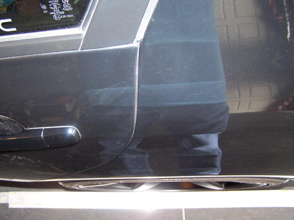

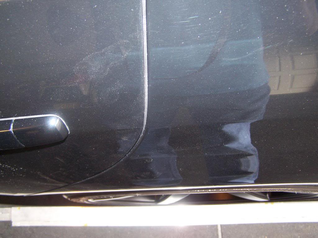

Old Mar 30, 2014 | 02:52 PM
About the best I could do, looking straight down the drivers' side~

That's actually pretty good!
It looks like it's virtually parallel to the fender, with only a small hint of the front pointing inward. Is that safe to say? If that's the case, my car is pretty spot on.

It takes a pretty good eye but looking straight from the rear to the front of the car at ground level there is a very faint inward tilt, and I mean it's faint
