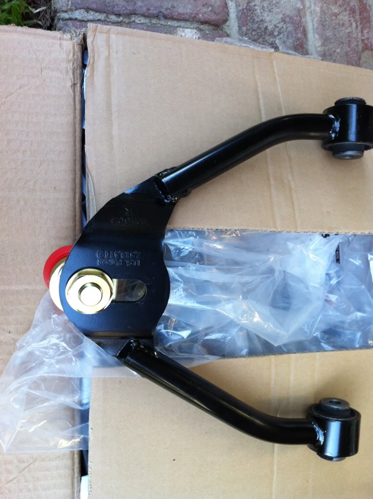

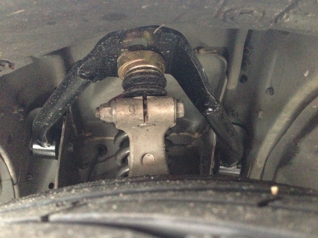

Thanks, are you able to tell if they are installed correctly from this pic?
