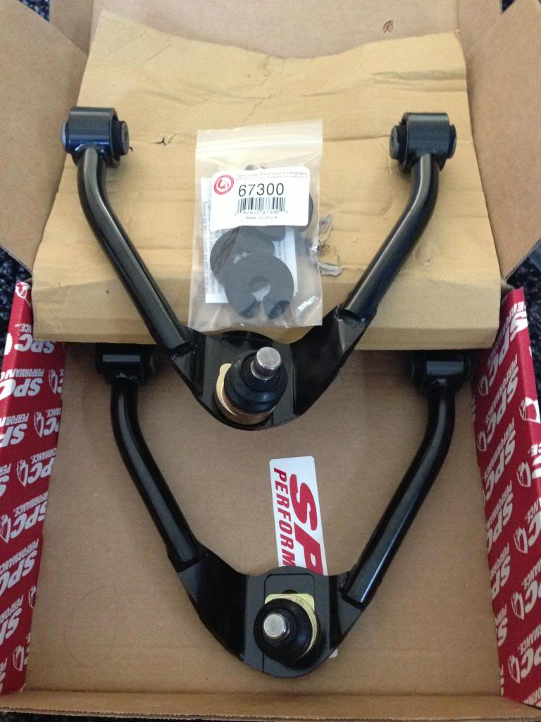

Originally Posted by mj_39
Hey Guys, just got the call back from Johnny at SPC. He has confirmed that surfwagon and my arms are the NEWEST version front camber arms. He stated that the red boots are all older version arms. Newest arms are black boots and that the no longer use the red boots
Huh, that's interesting. I'm surprised that anything under 26.5 was making contact with the fender.

Originally Posted by eksigned
For the record, SPC hasn't sold the 2nd generation in years. The third and final generation should come with a BLACK boot. Red was once upon a time, way the hell long ago. I just ordered my set through SPC directly via our vendor account. Spoke with Jeff and he confirmed this.
The 3rd generation was just released late July 2012.
The announcement was early July 2012
I sent my 2 gen in directly to SPC for the 3rd gen upgrade. Has a red boot.
Old Apr 10, 2013 | 04:31 PM
  #34
Ahh, the plot thickens
I referred Johnny from SPC to this thread, they looked at your pictures and mine and CONFIRMED mine were the newest arms? Are they lying to us? What's going on here?
Can any one confirm what's going on here. I believe what TvPostSound is saying however SPC is saying otherwise
Vendors can you chime in?

So Johnny sent me a set of older arms???\
EDIT:
I just spoke with Jeff at SPC, the 3rd gen arms have both red and black boots on the bj.
They just recently changed over to black boots.
To confirm the 3rd gen had a revised construction, and the rod is welded at 3 sides to the flat metal plate.
When I asked him about yours, that's what he implied... "any arms with red boots are all older model arms, newest arms all come with black boots"
Exact quote from Johnny @ SPC
Then Jeff and Johnny need to confer!!
The new model has better welds and longer round stock, this is mine, same as yours above!!
We both have the newer versions!!
IMG_0312.jpg?t=1343955090
This is yours, same welds:
