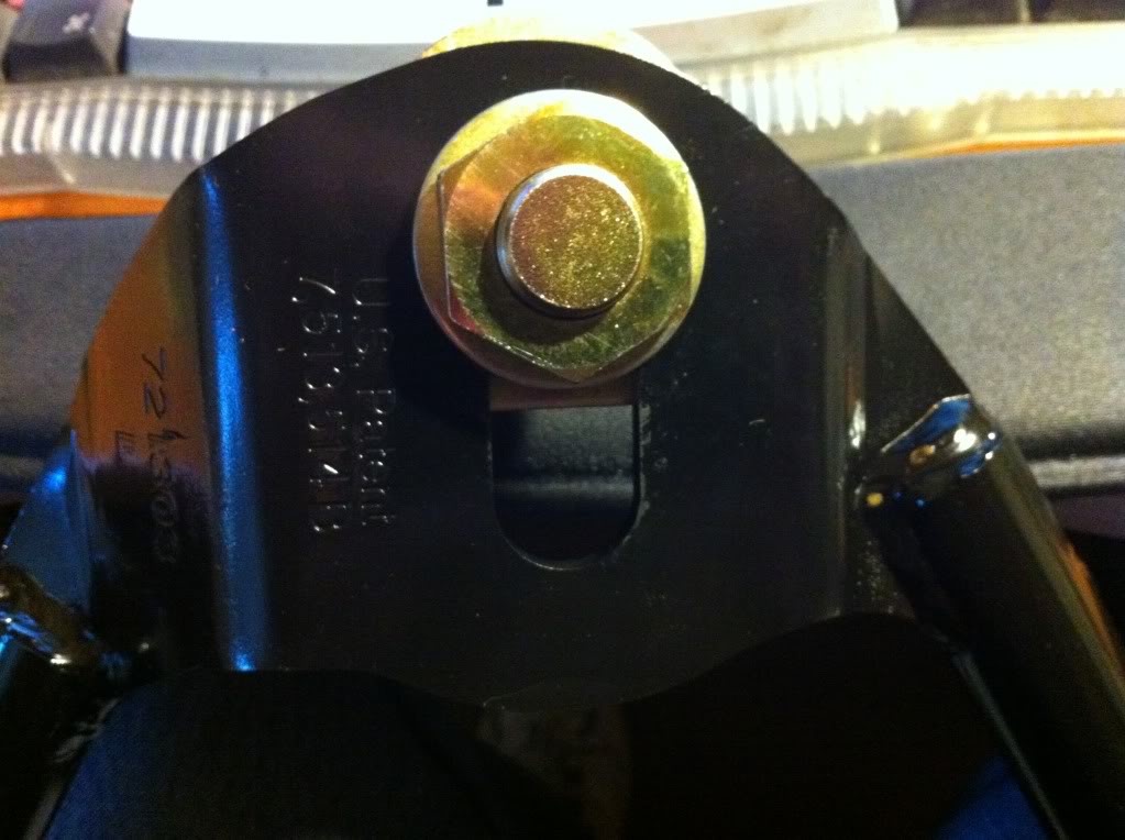

Originally Posted by mj_39
Thanks, are you able to tell if they are installed correctly from this pic?
No, not from that far away, see the round brass colored area just above the ball joint boot? Look for writing there.
Are those G35 arms? The G37s should have red ball joint boots.

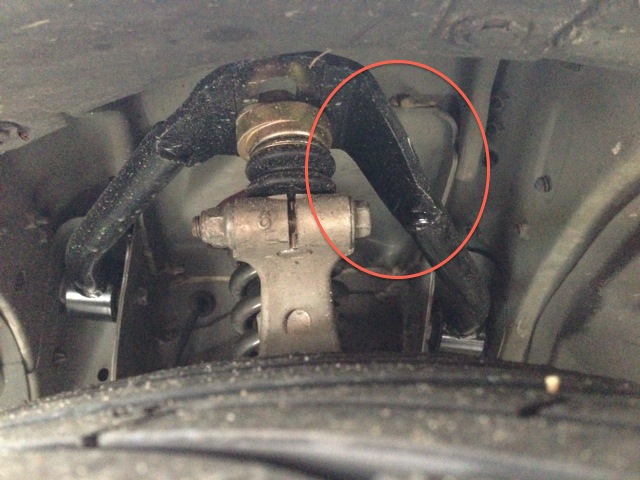

Looking closer at those, the ball joint is set at around a -3 degrees of camber, and and extra 2 to 3 degrees of caster.
Is this really yours??
Yes they should be, part # 72130 according to box and arms. Ordered them from Genome Tuning
Yes these are mine I just took the pic to show you. I did have alignment done. Camber is set at -3.9

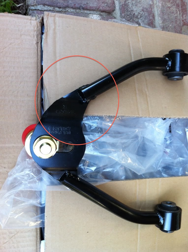

There are 3 generations of arms, all branded 72130, the first set hit the fender, the second set were modified with shorter "flat" metal, compensated with longer "rod" metal.
I had the 2nd generation, and SPC upgrade me to 3rd generation.
Yours look like first generation, as the ball joint boots are black, not red, and you have longer "flat" metal stock than mine.
This is the new version:

Thats indicative of a first or second generation arm, not the most recent.

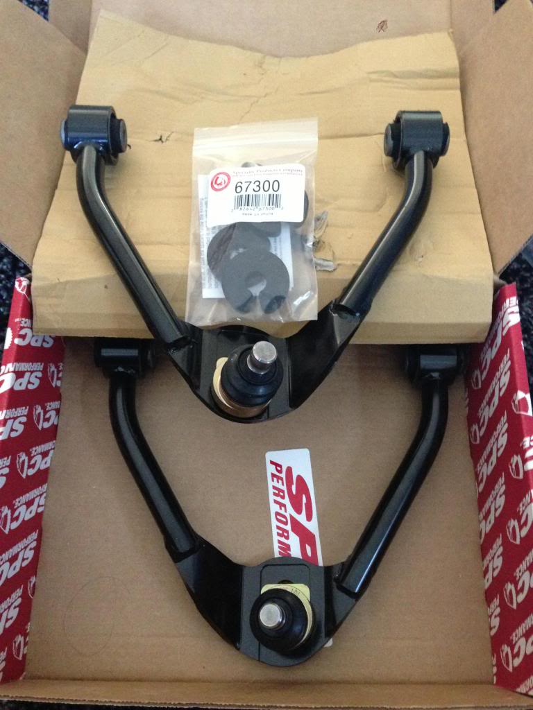

Thank you. I'm going to contact SPC to verify which arms I received, as I specifically requested the newest generation available from Genome Tuning.
If I do have an older generation, I'd be very upset as I have already paid for installation and alignment.
I even sent the picture below to Genome Tuning to confirm that I received the correct product, and was reassured that everything was "good on their end".

I've got the middle version and mine have the red boots too. The SPC is pretty easy to see on the brass slider, it's engraved so you should see it clearly.

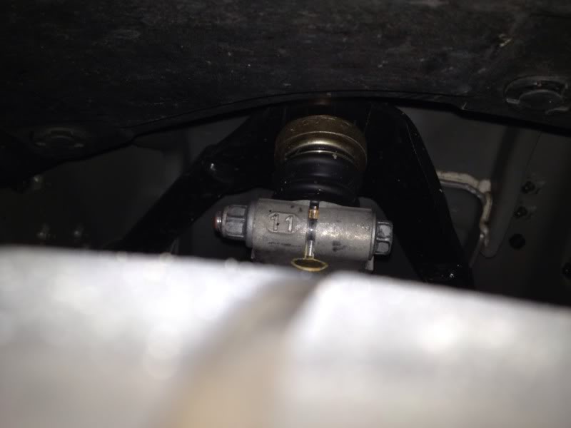

I think I have the same problem. I also ordered mine from you Heinrich (Genome). I wonder why SPC was shipping out the older kits? Can someone confirm from my pic below that this is the old version?

I just got a call from SPC , they are looking into it and will be calling me back shortly. Will keep everyone posted

Hey Guys, just got the call back from Johnny at SPC. He has confirmed that surfwagon and my arms are the NEWEST version front camber arms. He stated that the red boots are all older version arms. Newest arms are black boots and that the no longer use the red boots
