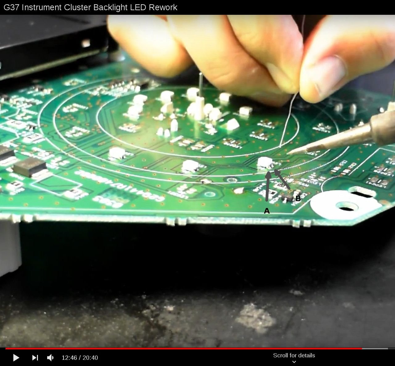

Originally Posted by DanG37
In looking at Dan Holt's video, it seems he's only soldering on the left points? Are the other points just there for physical support or some such, not electrical conductivity? Or am I mis-seeing things?
If indeed the only solder points to worry about are the two left ones [with A being the top left solder point and B being the bottom left solder point], for a 2-PLCC like the 160-2044-1-ND (instead of the 4-PLCC used in that video), how should that be lined up, the green or the blue or either locations?
the actual leds he list are incorrect the correct leds are plcc2 not plcc4 on the OEM lg leds the connections are bridged under the led itself and there is only 2 pads on the board.
here is the actual led from the speedometer as you can see it is not a osram but a lg and is actually a plcc2 4800k white led it is a .25w led also
