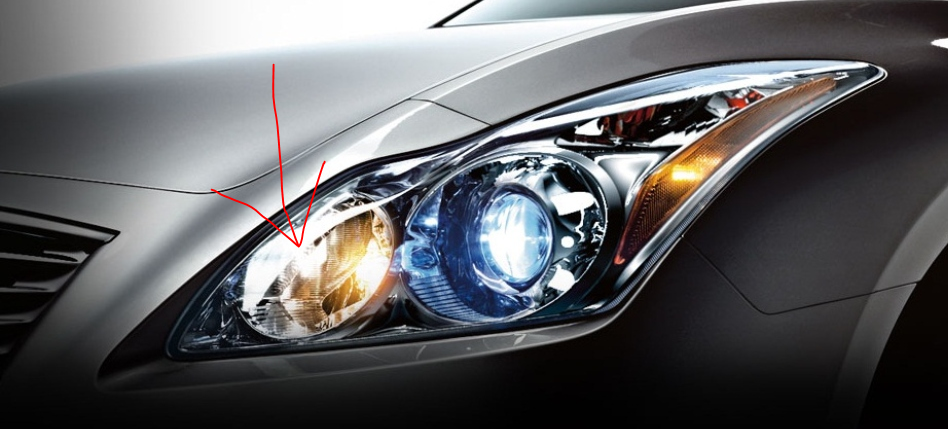

what is this light bulb called?
Hi,
Just noticed my driver left light went out. It flickers a little bit. Passenger side works fine. What is this light called and any DIY to replace this?
I think Dioded Dynamic sells this?

DD has a diagram on their site that will show you the light and your options for a replacement.

City Light I believe

City Light LEDs for 2008-2013 Infiniti G37 Coupe (pair) - G37 Coupe - Infiniti - Products By Vehicle

As others mentioned, that is indeed the city light location. It's a simple 194 bulb replacement:
I suggest our 5000K HP3 or 5000K HP5 personally, but any of our 194 bulb model options will fit

Ok I have a another question, the light circled in red is the city light? what is the thing above it? The light circled in red is what is out on mine.

Hard to tell 100% from the picture, but that looks like a 194 bulb to me
