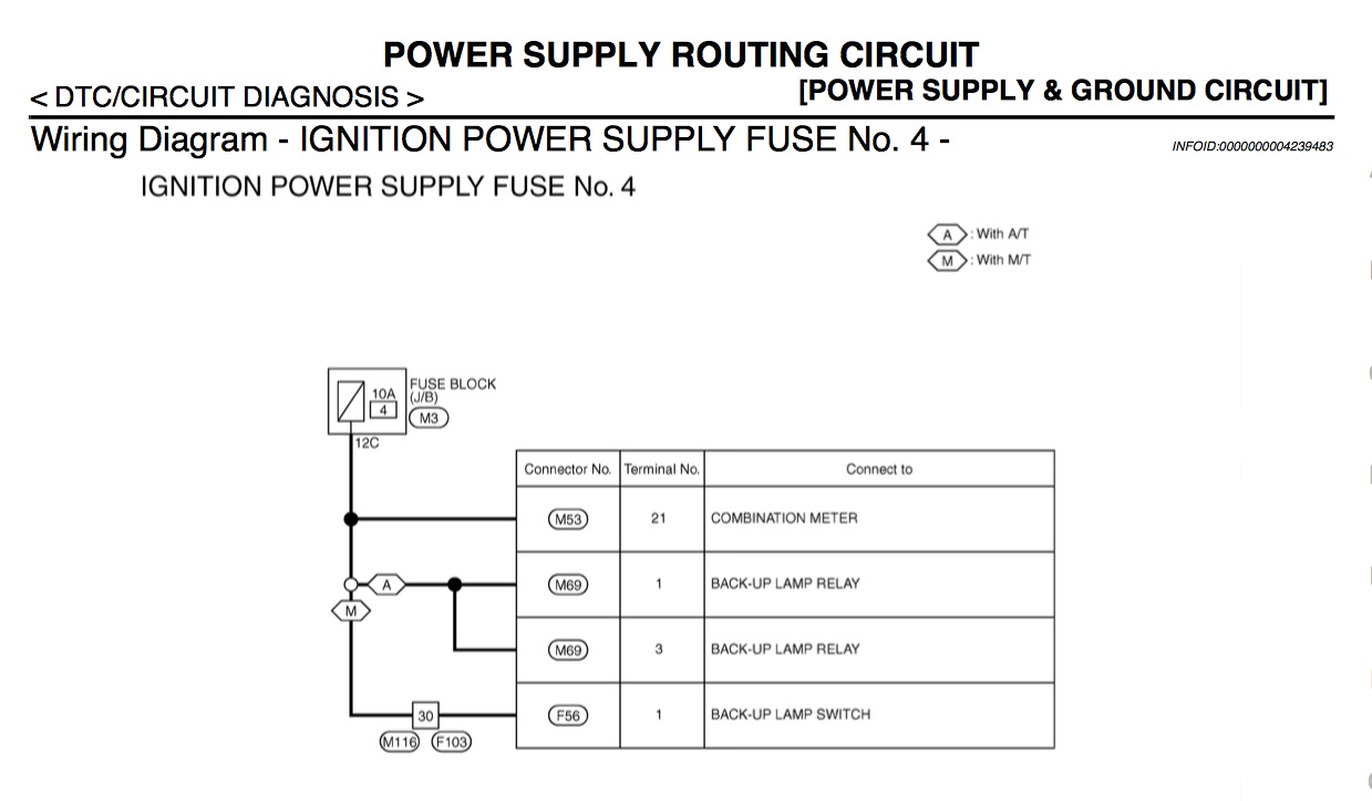

Looks like fuse #4 on the in-cabin block - but I don't think your guages would be working if that were blown... Polarity is the first thing to check.

Yeah EG Ryan is right...the regular bulbs didn't work either and they weren't blown either. I will try to flip them 180 and see if that works because I noticed some of the other leds were like that but still 99% sure there's an actual issue other than the bulbs just being out in backwards
