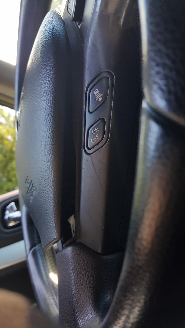

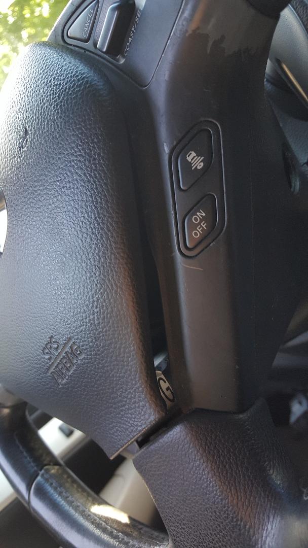

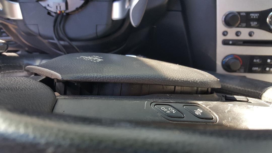

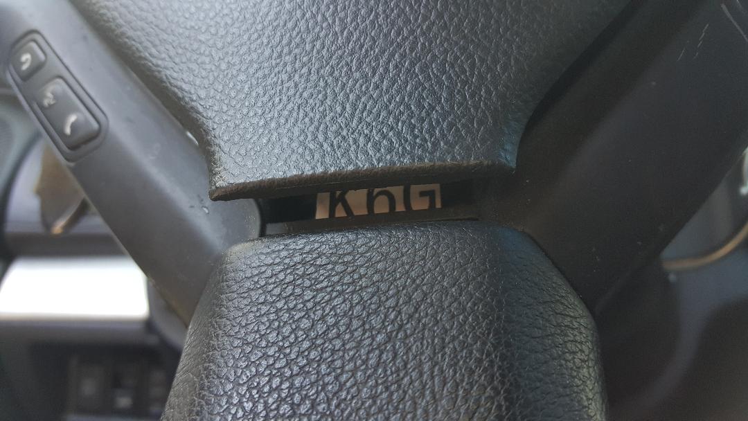

When I installed the air bag it doesn't sit properly???

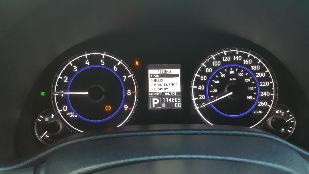

for those who have the 2010 cluster, on my 09 I do not think Ive seen the green light for the light b4,?

That green light is a fog light indicator. It means the fog light switch is activated.

Originally Posted by flipmode007
.....When I installed the air bag it doesn't sit properly???
To me, just looking at the picture, the bag was not all the way down when the T30 safety bolt were installed.
It seems like the bolts were installed outside the airbag bracket and the bolts are not letting the airbag slide all the way down.
tks i figure it out lol but its weird on the 2009 that light does not exist unless it's there and they didn't solder the led inside the cluster ?
g/l
I fixed it tks I took everything apart and I realize one of the spring was not sitting properly and after that everything was a go Tks again.
