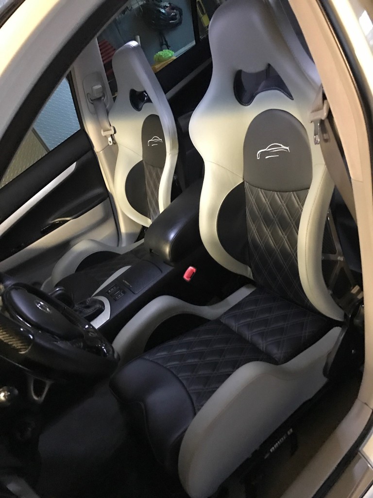

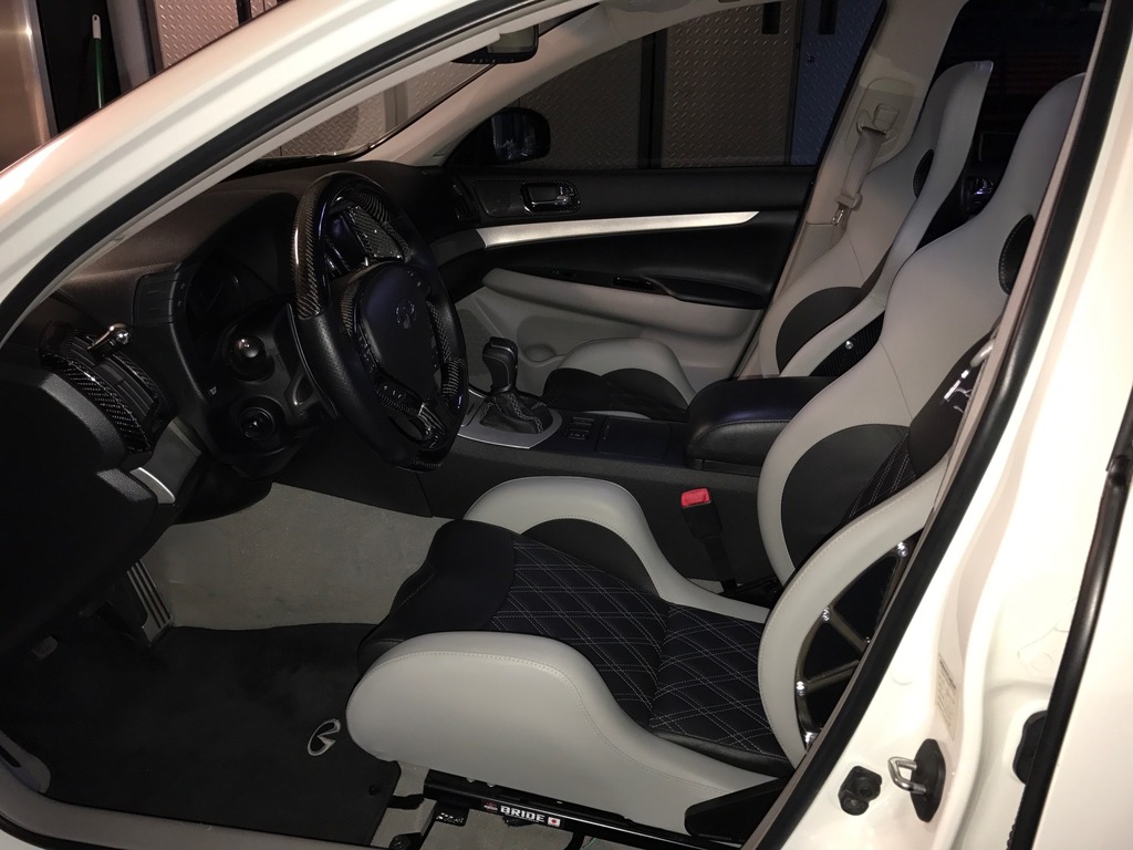

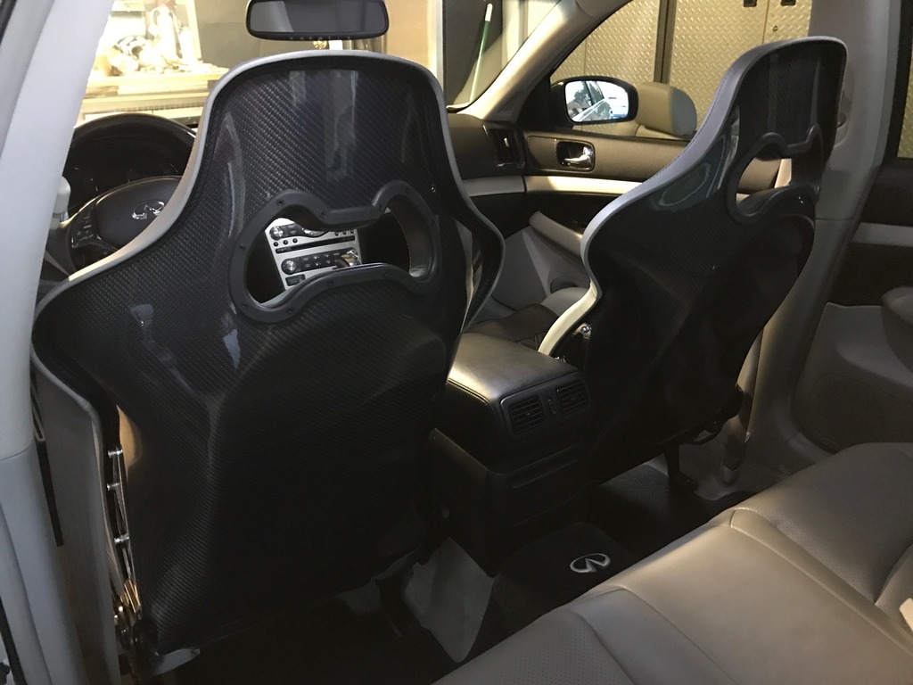

A few more pics that I took over the weekend. The last pic shows how high the new seat brackets/seats seem to sit, but when you sit in them there isn't really any noticeable difference in height. I think most of the difference is due to the fact that the OEM lower seats are so thick because they have to house all of the power seat mechanism.

I just did a quick measurement from the floor to the top of the seat cushion and it looks like the new seats sit almost exactly the same height as the OEM sport seats (about 9.5" off the floor to the top of the front seat cushion).
Its full how some don't think the OEM seats sit low enough. I'm the opposite, I was hoping the new seats would sit a bit higher, as I feel the OEM seats sit a little too low for my tastes... But what do I know?!?! I guess I'm just old and prefer to be able to get in and out of the car without hurting my back.

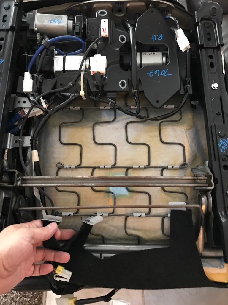

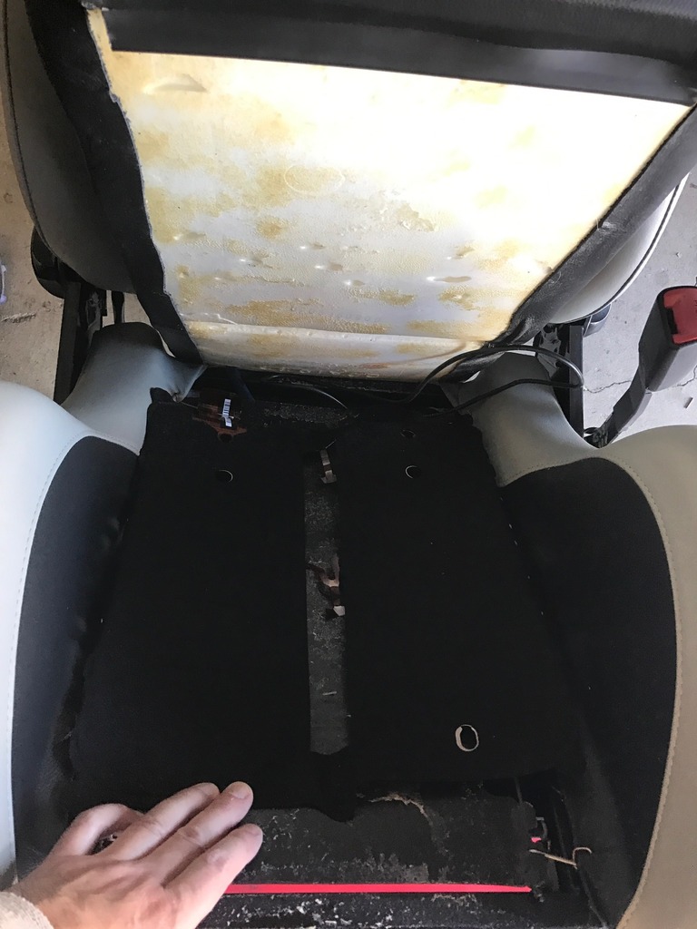

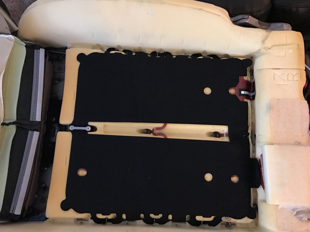

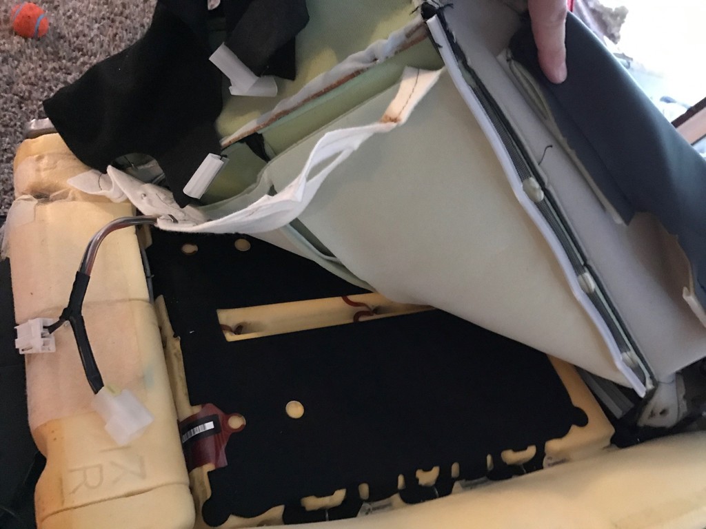

I have heard that the weight sensor out of the 370Z and also the GTR sensor will work on our cars, but you can't use a sensor out of any of the 1st Gen cars. Or you can just purchase a weight sensor bypass module from the link I previously posted, but that will disable the passenger's side airbag.
I've seen the lower seat cushions go for as low as $50 or $60 on eBay. I paid a little over $100 for mine on eBay, but got the entire lower seat assembly, including the power seat mechanism. I plan to try and adapt my new seats to the lower power seat rails so I can have power sliders along with my heated seats.
If you don't feel like destroying the new seat cushion by cutting into then I would suggest giving yourself about an hour to get the weight sensor out. The one I purchased was in great shape and I didn't have the heart to cut into it, so I spent the time to remove the sensor properly and zip tied it under the seat cushion on my new seat. Works perfectly!
