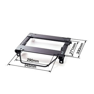

Hey guys. The OP PM'ed me and asked me to post up in this thread about my experience with putting custom seats in my car.
I can confirm that the Wedge brackets for the G37 coupe do NOT fit our cars (V36 Sedans). I tried test fitting a set of these for Wedge and driver's side bracket was close with 3 of the 4 holes lining up but the passenger's side bracket didn't line up at all. All the companies I talked to about these seat brackets confirmed that the sedan and coupe are different. I even talked to a couple of other companies about custom making brackets, but without my car and/or the lower seat assemblies from the sedan they couldn't make them.
I have a buddy that works for Tanabe USA/Bride/SSR here in town and he also confirmed that Bride Japan is currently the only company making seat brackets for our V36 sedans. So, just like Tony, I ended up going with the Bride brackets (Part #'s N109MO and N110MO). Although these brackets seem pricey, they are high quality mounts and come with the mount, sliders and adapter plates. They also have mounting points for the factory seat belts, which a lot of the other coupe mounts seem to omit. The bride brackets will also fit most bottom mount aftermarket seats including Sparco and Cobra, assuming they have one of the bolt patterns listed in the below drawing.
