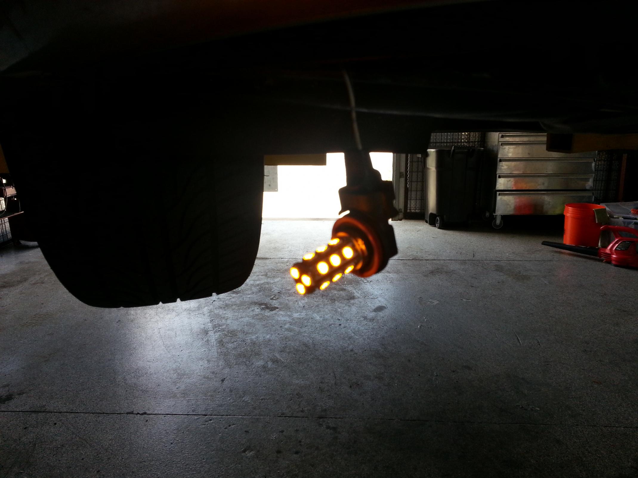

Hi,
2010 G37 Sedan
I was able to change the driver side fog light bulb but the passenger was different. Can you advise on how to change the passenger side?
Thanks.
Old Oct 25, 2014 | 03:56 PM
tite_tite's Avatar
tite_tite
Joined: Aug 2014
Posts: 292
Likes: 29
From: Houston, TX
Originally Posted by tite_tite
Hi,
2010 G37 Sedan
Thanks.
I was able to install the passenger fog light. I had to remove the panel on the bottom of the car at front of bumper & sneak your hand in there to remove & install fog light. This is for 2010 G37.
If I knew I can do this, I would have done it for the driver side as well. Also, the 2010 fog light bulb is H8 not 9006.
Hope this helps.
