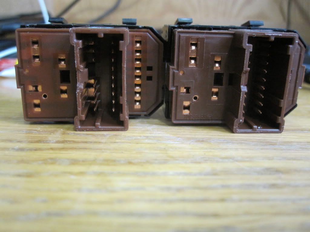

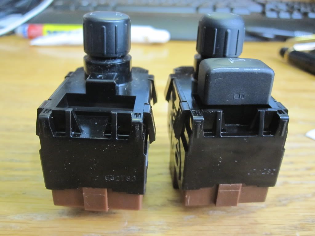

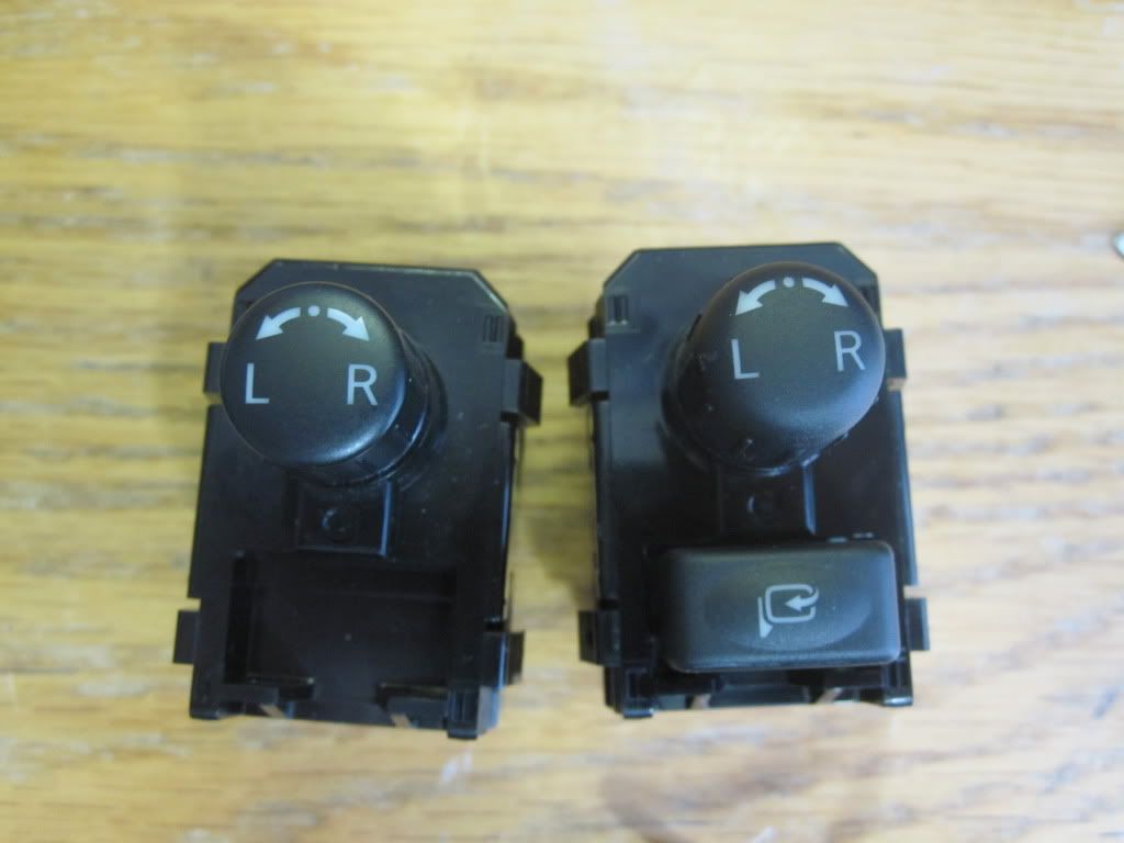

The mirror switch is identical between the folding and nonfolding models, with the exception of the fold button. Picture side by side:
It seems that Infiniti thought about including folding mirrors in the Coupe but later changed their mind. I'll get more into that later.

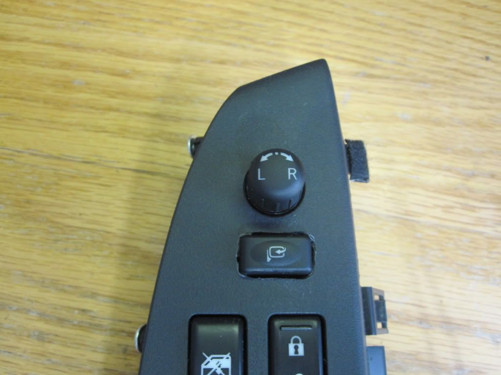

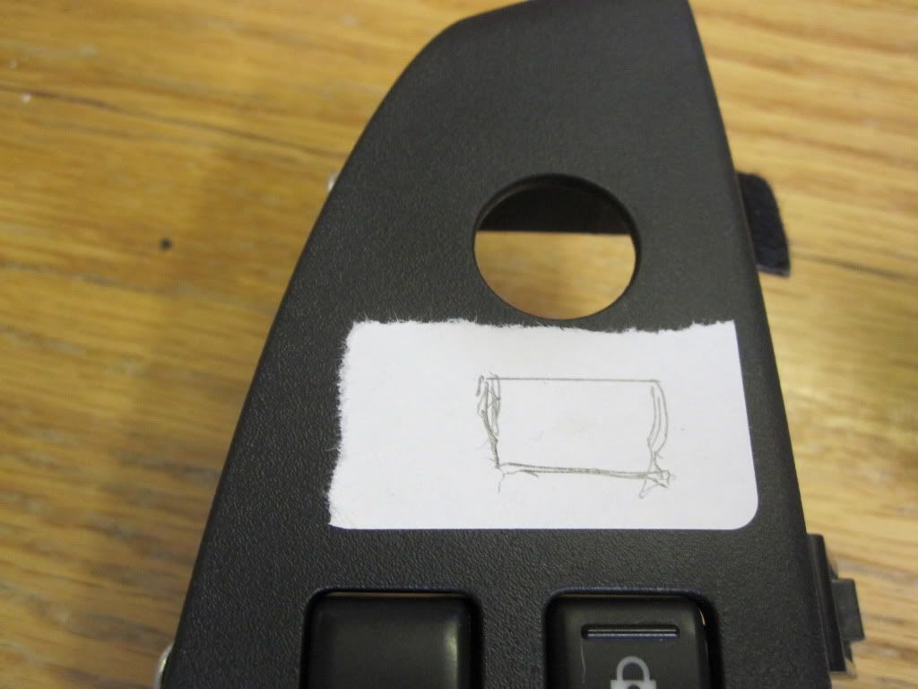

Fitting the switch basically involves dremeling a rectangle from the window switch bezel:

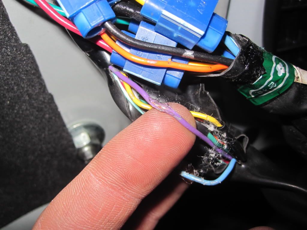

Now here's the most difficult part, wiring. To my pleasant surprise, the car is mostly prewired for foldable mirrors. This is also why I said Infiniti probably intended on having foldable mirrors but changed their minds at the last minute. The wires from the mirror switch to the driver door mirror is already there. The wire inside the passenger door to the mirror is already present. The only thing missing is the cross over wire from the driver's door to the passenger door, which runs through the car body. I'll have updates on this later.
The only thing that needed work was this violet wire. It is supposed to supply 12volt to the mirror switch, but it was not connected. I soldered a 12volt source from the window control switch to this wire:
After supplying 12v to the violet wire, the driver mirror is folding. I'll need to find some pins that will connect the harness between the driver and passenger doors.
