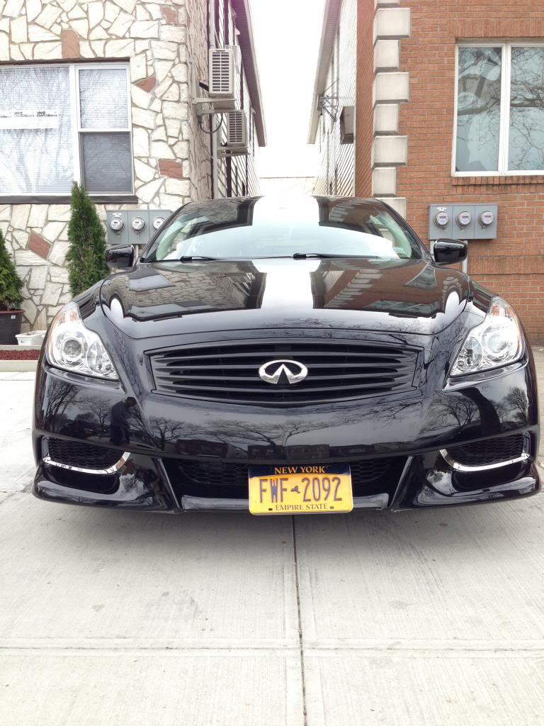

did this yesterday, came out great. only problem i had was that i couldnt remove my passenger side bumper bracket that connected the bumper to the car. i had to take one of the metal bolt clips off the old bumper and screwed it in where the bumper bracket would normally go, worked like a charm and cant even tell the difference. other than that it was a straight forward swap.

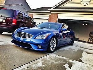

i did the 2008 sport to 2011 sport bumper conversion. the fog lights and even the bumper will not mount unless you remove/replace the washer fluid reservoir with the newer one
IPL/Aerodynamic Bumper Swap Idea.-foljbx5.jpg
IPL/Aerodynamic Bumper Swap Idea.-6bvpdur.jpg
