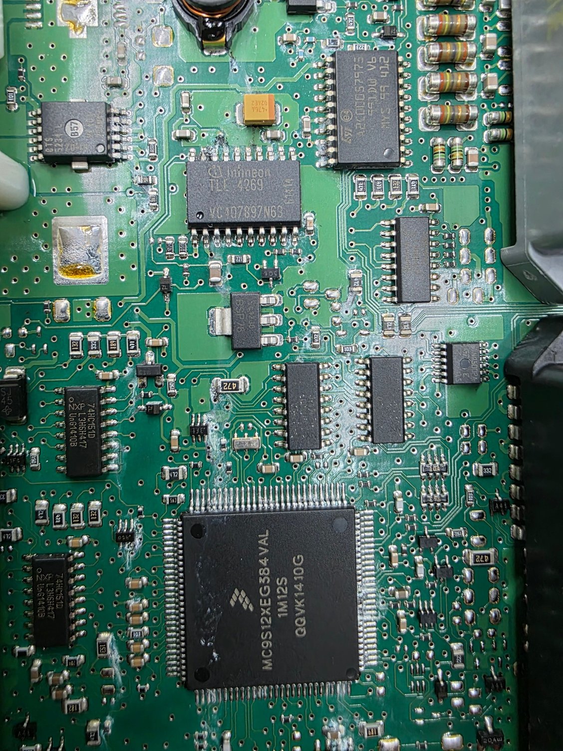

Bcm
Not necessarily. Given the sporadic behaviour it seems you may have caught this in time though there are no guarantees. Many have had luck removing the BCM and letting it thoroughly "dry out." Also ensuring the connector pins/ terminals (both on the BCM and the individual connectors) are clean, dry, and free from corrosion upon reassembly.
I would suggest- aside from how you intend to address the sunroof drain issue- disconnect the battery, remove the BCM, and see how things look and go from there. The electrics on these cars are very tough so don't assume the worst off the bat. Good luck.
Water all over wires and inside BCM.
Old Nov 21, 2025 | 07:29 PM
ILM-NC G37S's Avatar
ILM-NC G37S
Joined: Apr 2014
Posts: 4,856
Likes: 1,612
From: NC
At least now you know the culprit. I'd still give the board(s) a thorough cleaning and go from there as this would preserve your RKE/IVIS codes. Keep in mind that any replacement will require programming- typically any qualified locksmith should be able to do this easy enough.
Also, while searching for potential online repair options for my flickering gauge cluster, there are also online services that can "repair" damaged BCM's though I have no experience directly with same.
Plz keep us updated.
