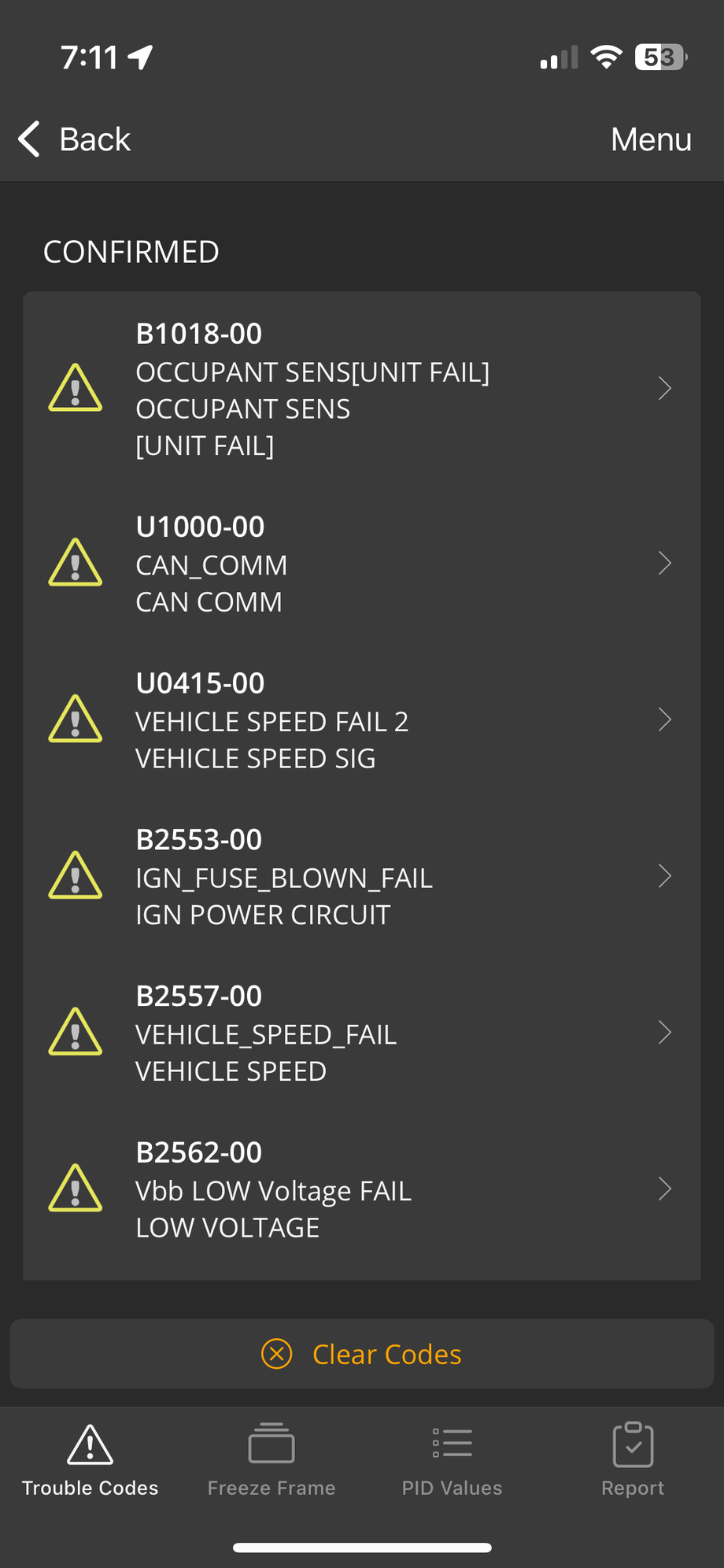

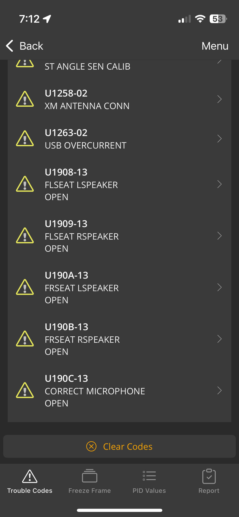

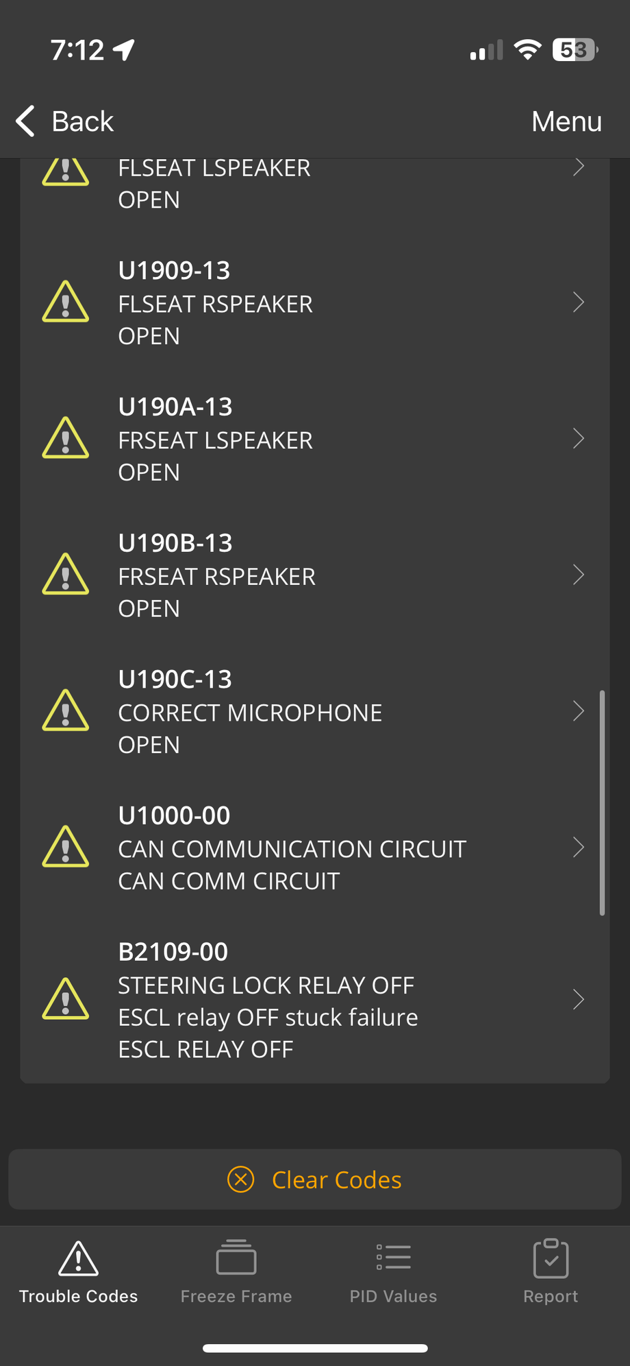

I had the time to finally scan using the fusion app. I have uploaded the codes, looks like the seat sensor is on there, so will have to move forward with the Airbag360.
In the meantime, the fiction app picked up on a lot more codes that weren’t pulled by simple obd reader. Anything on that list I need to be worried about? Seems most codes were benign, but did see some speed sensor/ecm codes…Additionally, even though the fusion app gave the option at the bottom to clear codes, it wouldn’t do it… Any insight is appreciated!

A lot of those codes could be the result of the weak battery/ voltage drop. I would clear all of the codes and go from there. If the B1018 persists then, unfortunately, you'll have to look into the Airbag360 route. Strange that popped up just as you replaced the radio. Though I am not a fan of coincidences stranger things can happen.
Assuming the car performs, runs and drives fine I would not sweat any of those codes.

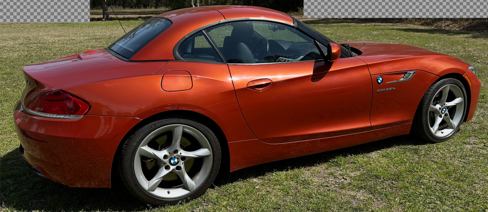

I am the opposite in that I prefer the RHT vs. ragtops. Simpler, yes, but too tempting for vandals, thieves, and the lot (can't count how may times cars at the train station would have their tops sliced "for the hell of it") as well as environmental nuisances. I had REALLY wanted the Jaguar F-Type but... ragtop. The only reason I did not get a G 'Vert was that I already have a Coupe and could not justify having basically 2 of the same thing. My Coupe will be with me to the end- it's or mine.
Initially, I wanted a F83 (M4) but finding one not: wrecked, "rebuilt," modified, and not beat to hell, in Sakhir Orange, and reasonably priced is more rarer than a unicorn's farts. In the end found a good deal on a E89 Z4 SDrive 35is- 3.0L I6, twin turbo, DCT and, in true BMW fashion, a monster of a driving machine. This was after almost 2-years of "semi-moderate" searching:
The E89 was the last series of the Zed/4 in RHT as the newest generation, the G29, is, sadly, ragtop. No regrets except, at times, I wish I had waited for a F83 but, even today, they are uber-rare, in my specs at least. As for 2-seaters, I am no stranger to roadsters. It is only "me, myself, and I" so...
