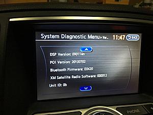

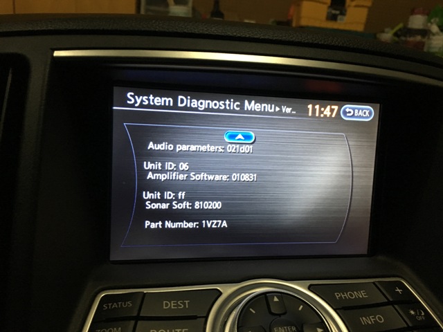

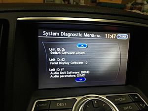

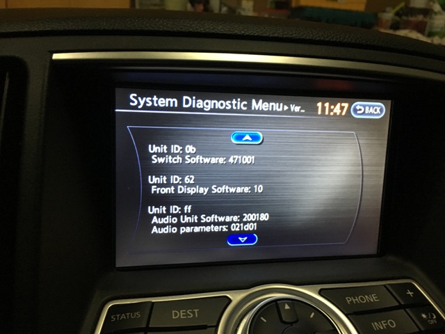

Same as yours pre-update (E0420). For reference, here is my entire version info page:
Attached Thumbnails iPhone connectivity issues-img_4270.jpg   iPhone connectivity issues-img_4271.jpg   iPhone connectivity issues-img_4272.jpg   iPhone connectivity issues-img_4273.jpg

Yeah, looks like that's the guy at fault. E0420..
