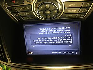

Old Jan 21, 2018 | 07:23 PM
  #89
codeflux's Avatar
codeflux
20 Year Member
Joined: May 2004
Posts: 242
Likes: 29
From: San Francisco, CA
Well, this sucks.
Emailed them. For now the whole screen is completely bricked.
Sorry about upside down pic, uploaded from iPhone.
Attached Thumbnails iPhone connectivity issues-efa0d6b3-1fa9-4d83-b9e7-58cca996c8de.jpeg
Old Jan 21, 2018 | 07:59 PM
  #90
codeflux's Avatar
codeflux
20 Year Member
Joined: May 2004
Posts: 242
Likes: 29
Jesus that was nerve wrecking.
I wiped the DVD down on my shirt and tried it again. For like 6th time. And it worked. I’m on second disk now.
/edit And it’s all done. Will test it out on the drive to work tomorrow. Honestly, very low expectations.
