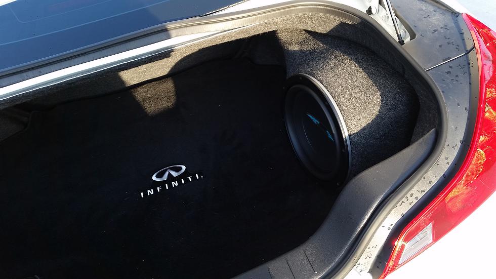

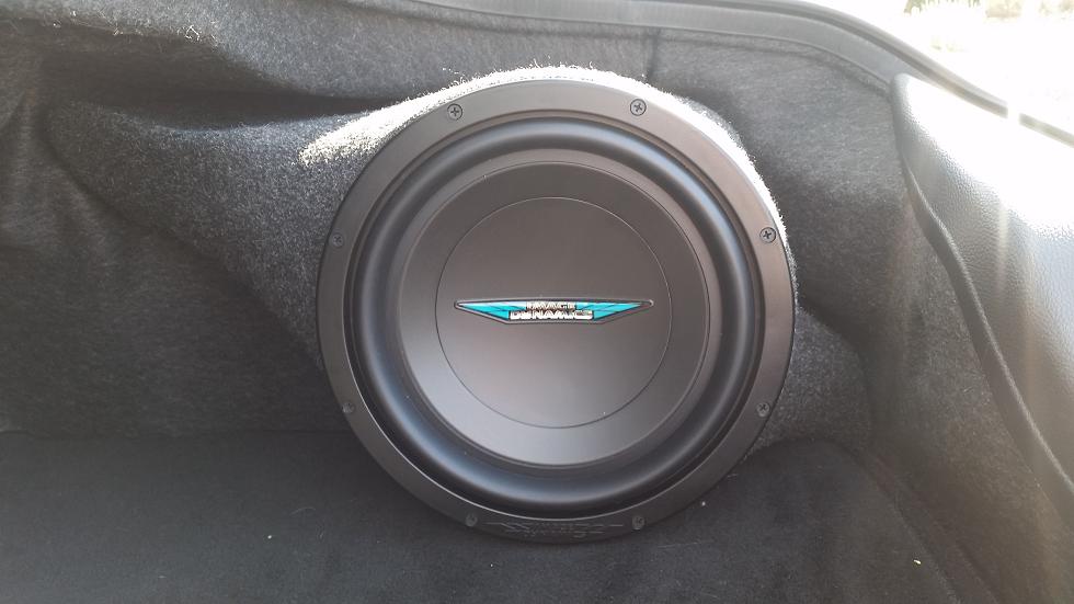

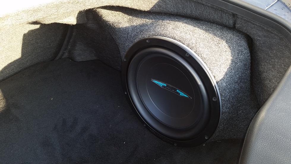

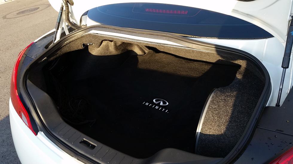

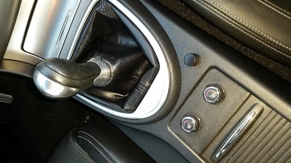

I just had my customsubenclosures box and everything installed on Tuesday... I will be posting pics tomorrow! Fits like a glove and takes up very little useable trunk space. I have a single Alpine MRX M-55 (Birthsheet rated it at 588 Watts RMS at 2 Ohms) hooked up with a 4-gauge wiring kit running a single IDQ10D4 V.4 wired at 2 Ohms. This is EXACTLY what my stock Bose system was missing and it sounds fantastic. It makes it feel like I upgraded the entire system instead of just added a sub. It really rounds out the bottom end very nicely. I had the remote **** installed just below my shifter on the center console for easy access and I barely turn it up. This single 10" is way more than enough to compliment the stock Bose system and gets very loud. I was wondering if I'd be able to hear a single 10" well enough through the thick back seat. Let me just tell you that if you're worried like I was, don't be. I can hear/feel it just fine at 80mph on the freeway with the windows down!
A big thank you to NealP for showing us that the box works in a 2011+ coupe. I would assume that it fits in 2011 and 2013 as well even though their website has it listed as 2008-2010.

Customsubenclosures pics
Sorry I didn't get a chance to post these pics over the weekend. You know how busy things can get on the weekends. But now that it's Monday and I'm back at the office, I have a chance to post the pics I took on Saturday
