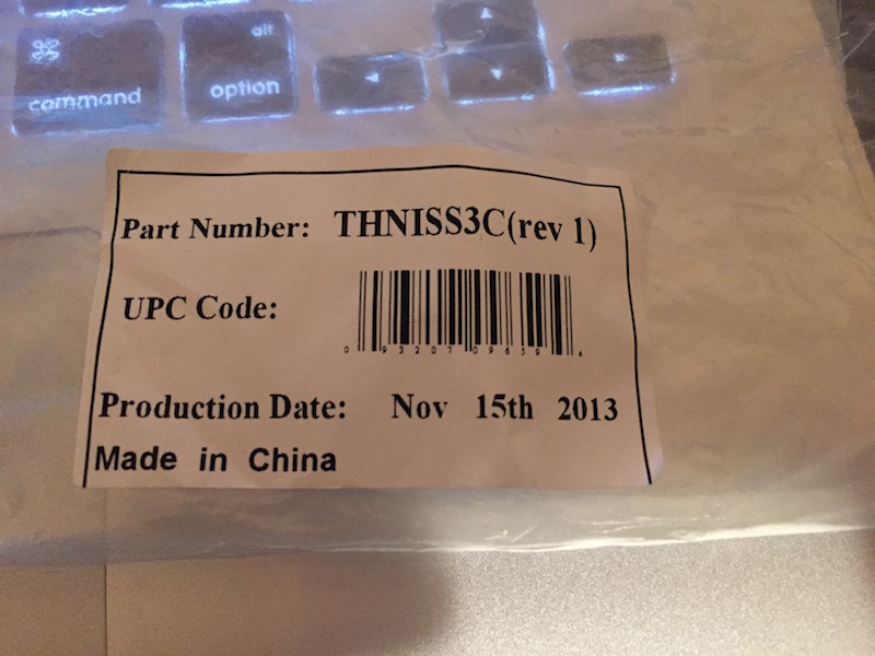

I noticed it says there are two version of the T harness - what version did you guys get? Mine says THNISS3C (rev1).

I'm actually trying to figure out what remote start to go with and the dball2pro, I think, is my best option since it still supports the 3x lock start. What is the difference between the THNISS3 and the THINSS3c harness?

If you get the Dballpro you need the harness that goes with it THINSS3c
