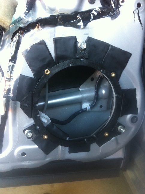

I started last weekend and gutted the trunk and rear seat area trim and covered with Second Skin Damplifier to combat resonance. Today I accomplished the rear door speaker install and Damplifier install (still not sure about speaker wire color - see other post).

Damplifier installed on inner/outer door skin and around speaker:

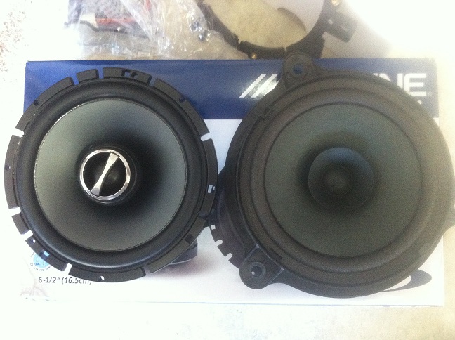

OEM Speaker vs Alpine:

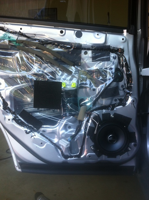

Speaker mounted:
Door ready to be refitted with panel:
