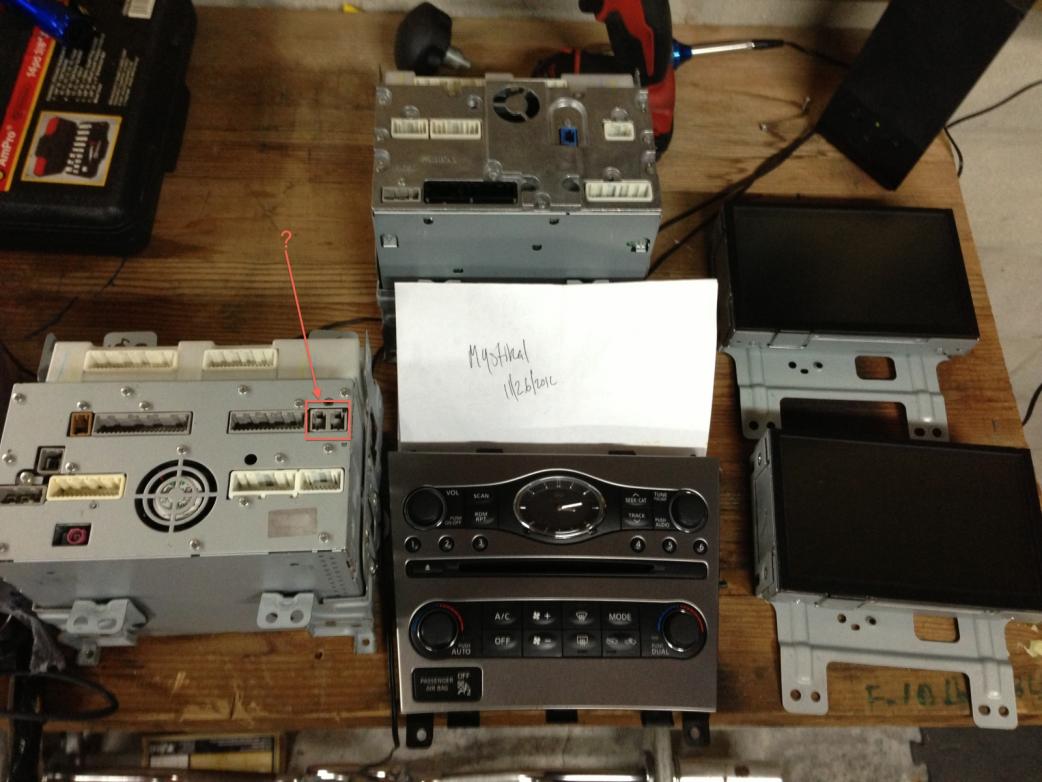

Gotcha, I think I have all the pigtails except for 2...Do you remember of these were used? (see image) I think the one of the left is for USB. Maybe the right wasn't used? Also do you remember if any of the connectors were plug in play? Thanks for all your help!

The two you circled are for USB, only one of them is used. There is one connector that is the same between 2010 and 2008. However, I remember at least 1 wire in that connector has to be spliced from another harness.
