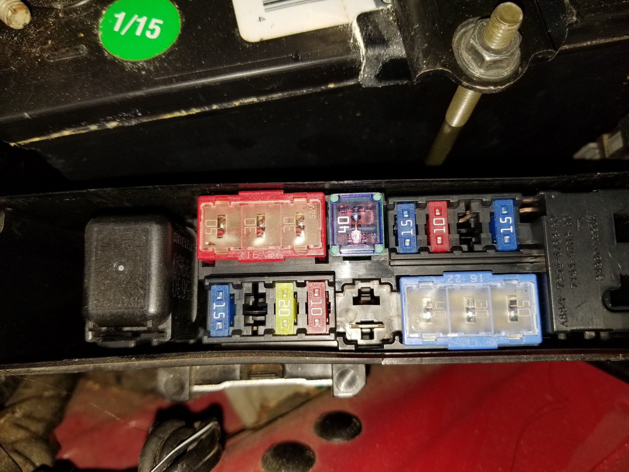

Thanks man. Is this the fuse link? Do I replace the entire thing? I assume PSB means PRE-CRASH SEAT BELT?

In your pic it is the red "box" From what I understand the whole link has to be replaced. Double check to make sure the link is bad by checking Pin #2 at the PSB Control Unit for voltage.

So the fusible link in good. What is the pre crash seat belt motor? Is this the seatbelt receptacle? How would I test it?
