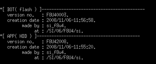

Good idea, here is more detailed version info from the one I have.

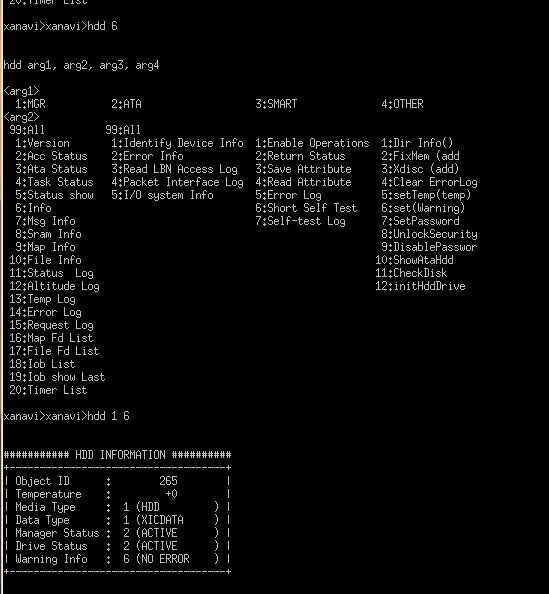

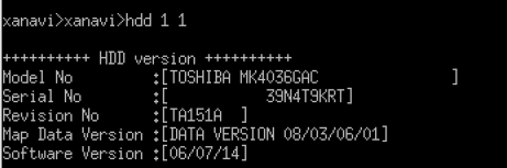

So I cloned the drive to an SSD, and it boots, but it actually seems slightly slower to fully boot up. Also, the nav just straight up won't load now (it shows the map screen with a black map). So it's as if it can't access those files.
The HU does recognize the new drive though:
Then I tried to run "init drive" and there is now a warning on the nav screen saying "HDD System not functioning, please contact your dealer" (it goes away after i reboot)
Still need to play with that more.
The other interesting thing is that none of the drives are locking anymore after disabling the security in the console, so I guess that did actually save.
I'm actually using a MSATA to IDE adapter, so that could be a problem. Might want an actual IDE SSD.

Bad news:
The US spec unit don't work with SSD.
I use a KingSpec IDE SSD.
The same SSD that work's just fine on EU unit, don't work on US unit.
The unit hang on INFINITI logo for a minute, then enter safe mode with no media display, only AC display and only volume **** working on the unit.

It might be waiting on timing based on measured performance of the HDD (IE software bodge to avoid dealing with interrupts), and the SSD being ready too fast is getting the instruction set out of loop.
