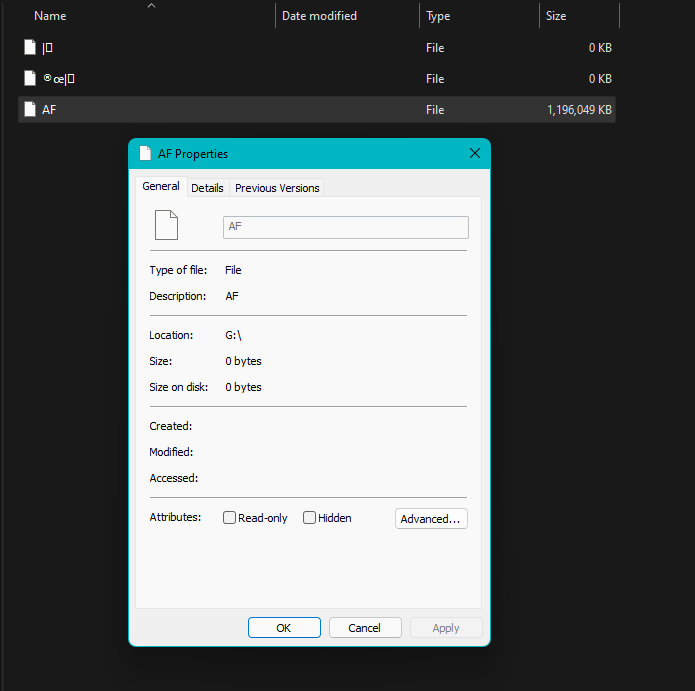

So I did manage to image the drive, but the image includes the corrupted files so really don't think it will do us much good. interestingly the other partitions seem totally fine, it's just that main system one.

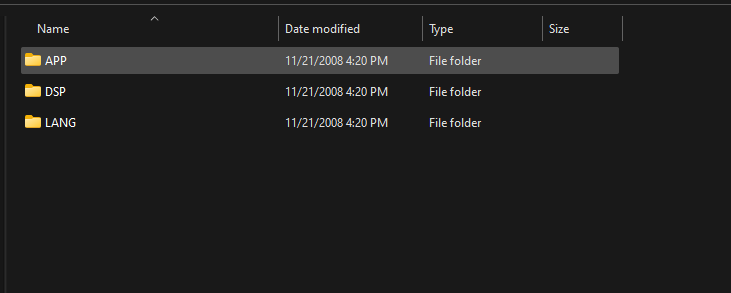

This is what we SHOULD be seeing (from the 2009 image)

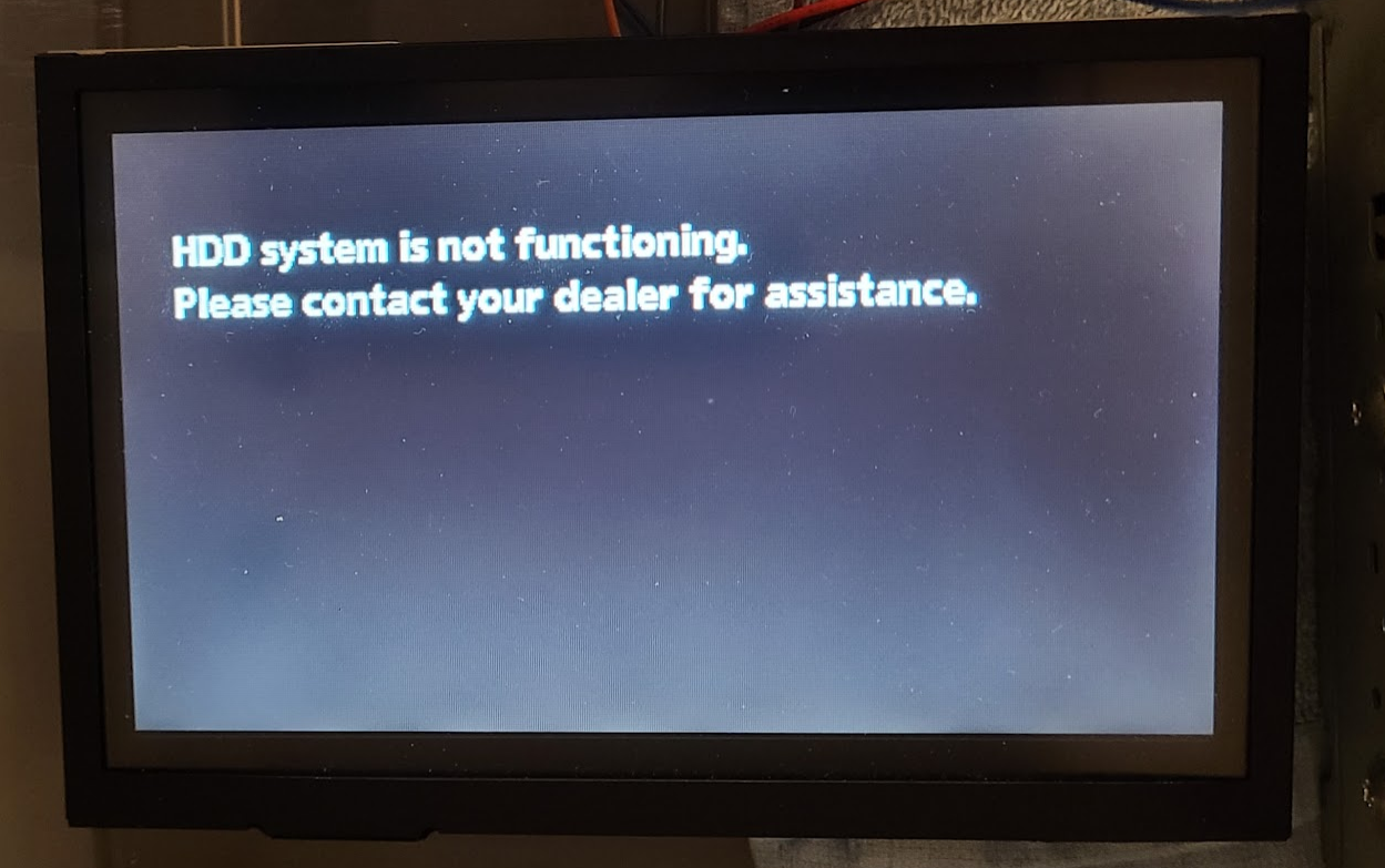

Then, I put the GT-R drive into my test rig. Obviously not expecting it to do anything, and sure enough HDD error... probably the same error you were seeing.
My test rig has the boot-up re locking function disabled, so the drive still remains unlocked.
Not really sure if there is anything left to do at this point, anyone got any ideas? This is a perfect example of why we need image backups though. These cars are getting older and older and the drives are all going to start failing.....

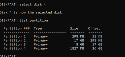

I've only tried macrium and win32diskimager. But, I've always have success with win32diskimager. I've used clonezilla before but I don't think it lets you create an image, just clone drive to drive (i only used the bootable one) The two cloned drives I have were done with that and booted up fine. There are 4 partitions which need to be copied over, i posted a screenshot of how it should look in disk manager.
I'm creating another image of the G37 drive now with only allocated partitions so it should be a little bit smaller, it's still going to be like 30GB. need to figure out where to upload it.

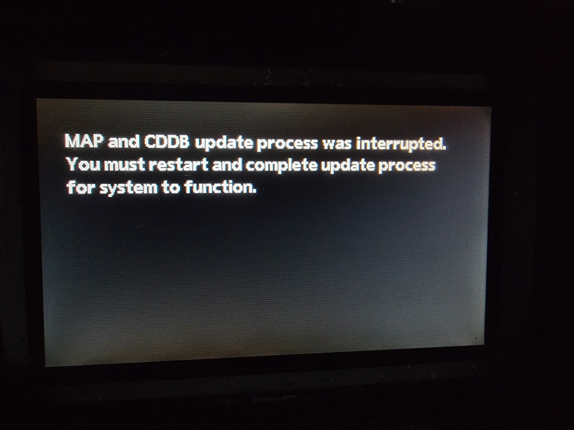

When I was getting the HDD failure error from my old drive, every once in a while I would get this map error instead. So I wonder if the map error is when it is able to load some of the files and not all, but gives a map error when it can't find the files it is looking for.
The HDD error might just be that it can't find anything at all or at least the initial bootstrap.
