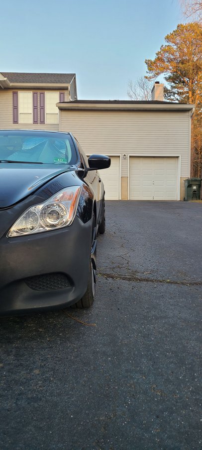

Here's a quick and (very) dirty pic of my coupe as she sits. I still need to add the rear extended lugs and 10mm spacers, and lower the rear a bit more to make the fender to tire gap even front to back. These are Aodhan 19x11 et22 with 275/35s all around.

Old Mar 10, 2025 | 07:22 PM
Black_G's Avatar
Black_G
Joined: Jul 2014
Posts: 29
Pics of how the current 285/30R20 fits. And proof of LS swap.
