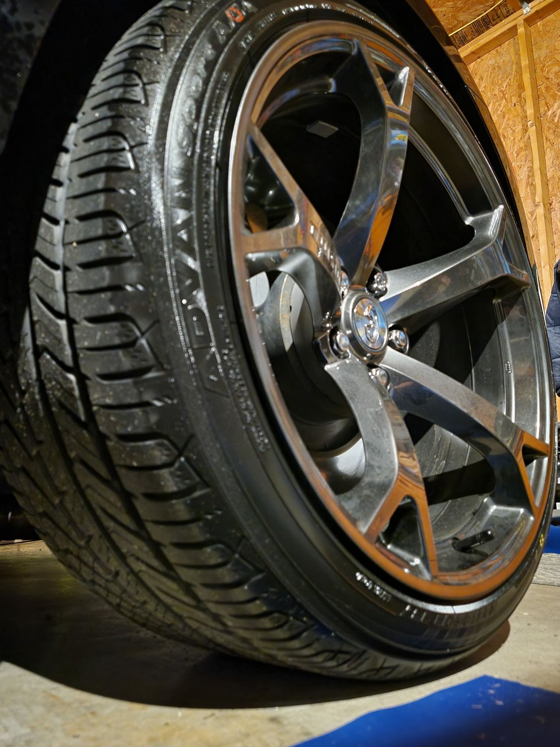

Swapped the tires to 265/35 (fronts are 235/40). I'll let you guys know how the ride is against that one big dip on my way to work.
Old Oct 5, 2022 | 09:28 PM
BlackQ60SCoupe's Avatar
BlackQ60SCoupe
Joined: Oct 2022
Posts: 6
Here's an updated pic of the rears. Slight stretch that I don't mind.

That's what, about 3/8" projection past the fender?
Hmm. Need to find some body shop people.
Old Oct 6, 2022 | 04:44 PM
BlackQ60SCoupe
Joined: Oct 2022
Posts: 6
On my way to work today, I was going 70 mph over the dip that I've had issues with - no rub. Before I would have to slow down below 55 mph and would still hear it. Not going to get too excited yet since I am sure there will be an even nastier dip or road surface that may cause a rub. I'll measure it later tonight.
