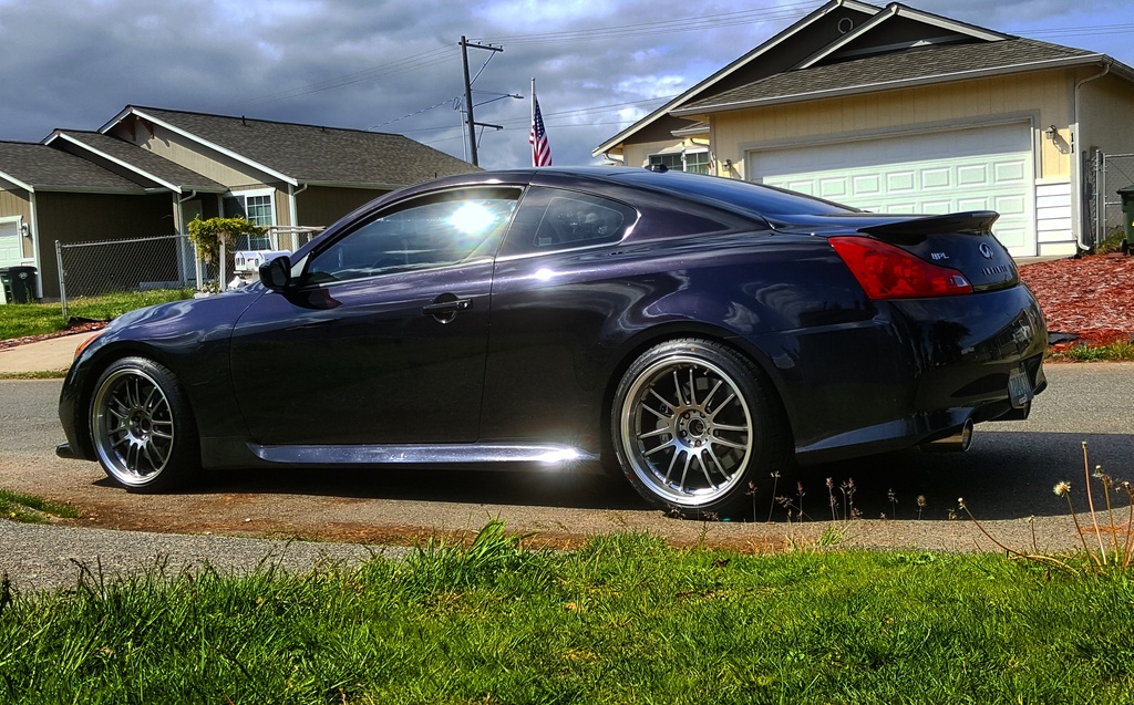

Volk re30
19x10 +30 front with 10mm kics spacer so +20 effective.
245 35 19
19x11 +20 no spacer
265 35 19
Fitment required trimming bumper tab and liner rear
Weight is about 19lbs ea
Lowered on swift springs with rear camber at -1.5 toe in spec
No spacer required to clear BBK clears with alot of room to spare contrary to reports i heard prior to purchase. These are GTR speced re30
