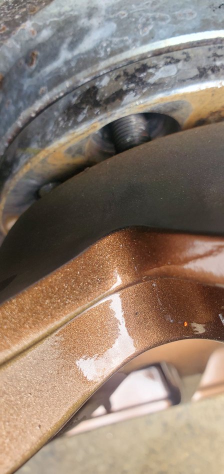

Ok pics!
Okay it appears one the studs is blocking The wheel from sitting flush?
It fits fine on the wheel BEFORE bolting it to the hub

The OEM wheels have pockets where the studs can fit - your new wheels may not. You either have to run a wider bolt-on spacer or switch to slip ons, which will require longer studs.
Or, you could cut down the stock studs. Might not recommend this one.

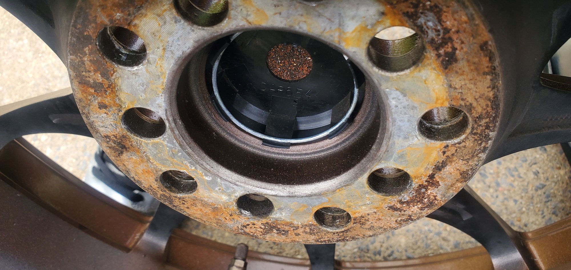

Good point. I'm using 15mm Spacer adapters (in the winter), and the OEM studs protrude a little bit beyond the spacer itself. But that's not a problem, because the duckfeet have pockets of empty space between the stud holes. Here, pic is worth 1000 words...

Ahhhh I see, welp time for new spacers. The cutting idea sounds super sketchy lol

And this time spacers with extended studs, instead of spacer adapters.
