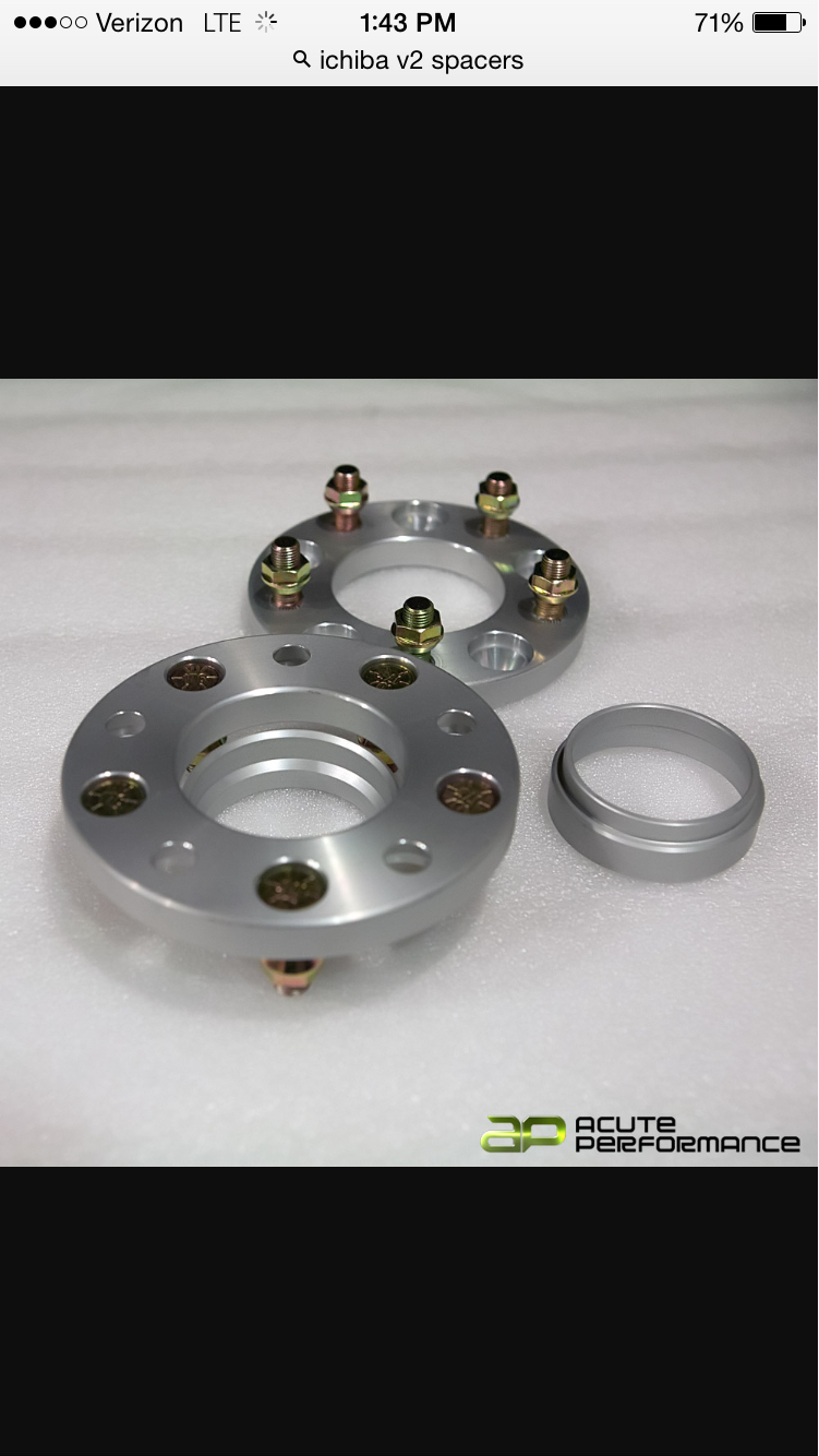

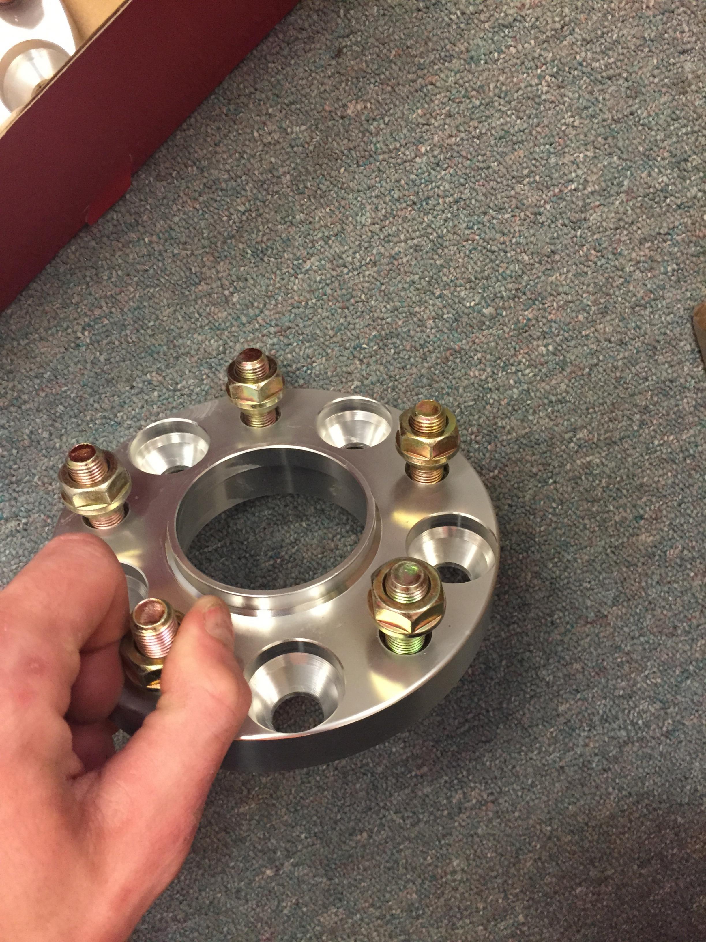

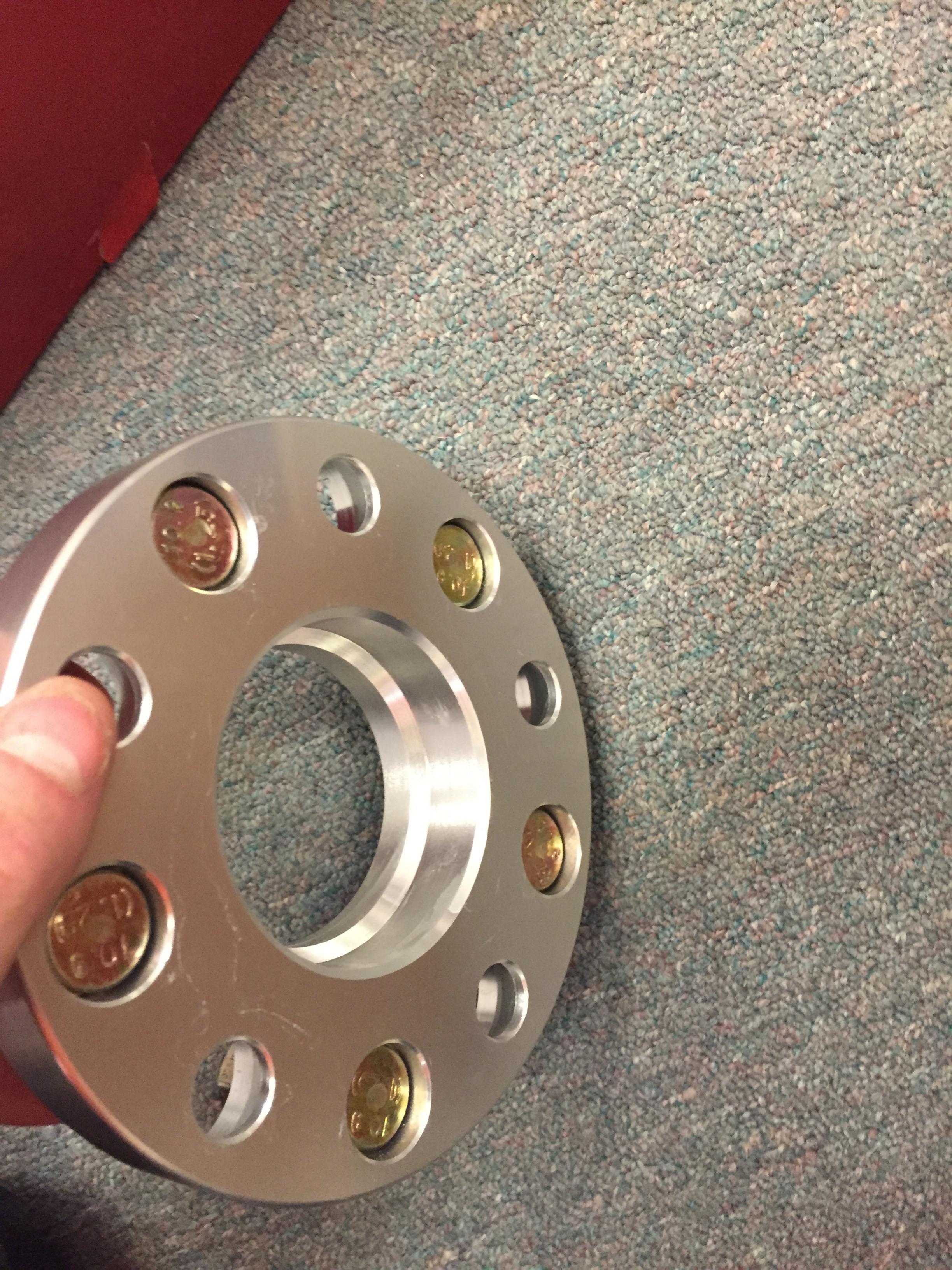

I got my Ichiba V2 in the mail today and was wondering if the middle piece is built in to the spacer or seperate.. These came with the rings built in but the V1 I accidentally ordered a few weeks ago had the ring in the center seperate from the spacer.. Are these the right spacers?

The studs are built-in to the spacer which are meant to eliminate the need to replace the existing studs on your wheel hub. The nuts, however, should be taken off and used for installing the spacers.
Hope this answers your question since I wasn't really sure what you are asking.

Sorry for not making it clear enough.. I didn't really know how to ask lol but here's what I'm talking about.. The ring on the right thats seperate from the spacer.. Mine is stationary where this one can slide in and out. Does that help?

That's probably the hub ring, which is used to make sure the wheel is centered correctly on the spacer. Yours is built-in to the spacer itself so you don't need to worry about it. The v2's are bolt-on spacers which are hub-centric and include extended studs, making installation a breeze since you literally just have to bolt it on and you're done.
Everything on your spacers is ready for installation.

I agree with the previous poster - these are good to go! The spacers with differing rings are more or less universal (can switch out the rings to peroperly fit different cars). The spacers you currently have are high quality and Nissan/Infiniti specific, which is a good thing.

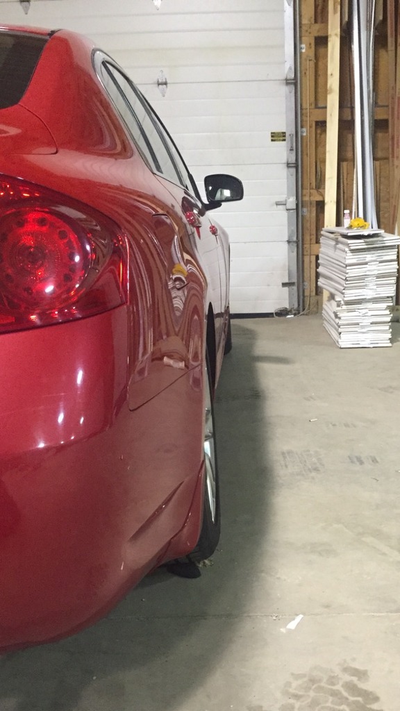

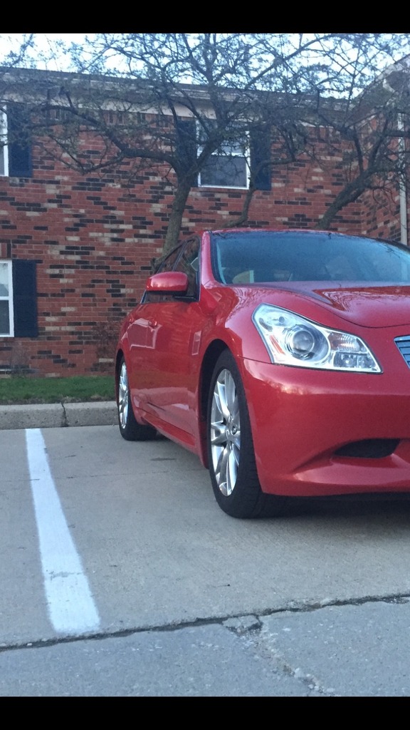

OEM 18s for now. Eventually gonna get new wheels. I put the spacers on earlier and it looks so much better. Here's the before and after.

Looks MUCH better, nice work!
I asked about OEM Vs Aftermarket wheels as most aftermarket wheels will require hubcentric rings. However, these were used to space OEM, so that's a non-issue
Pretty dramatic difference, huh? Wheel fitment is one of those things that's academic for most people... until you start obsessing over it, and then it becomes a crazy priority you never had before.
Looks great, OP. Well done.
